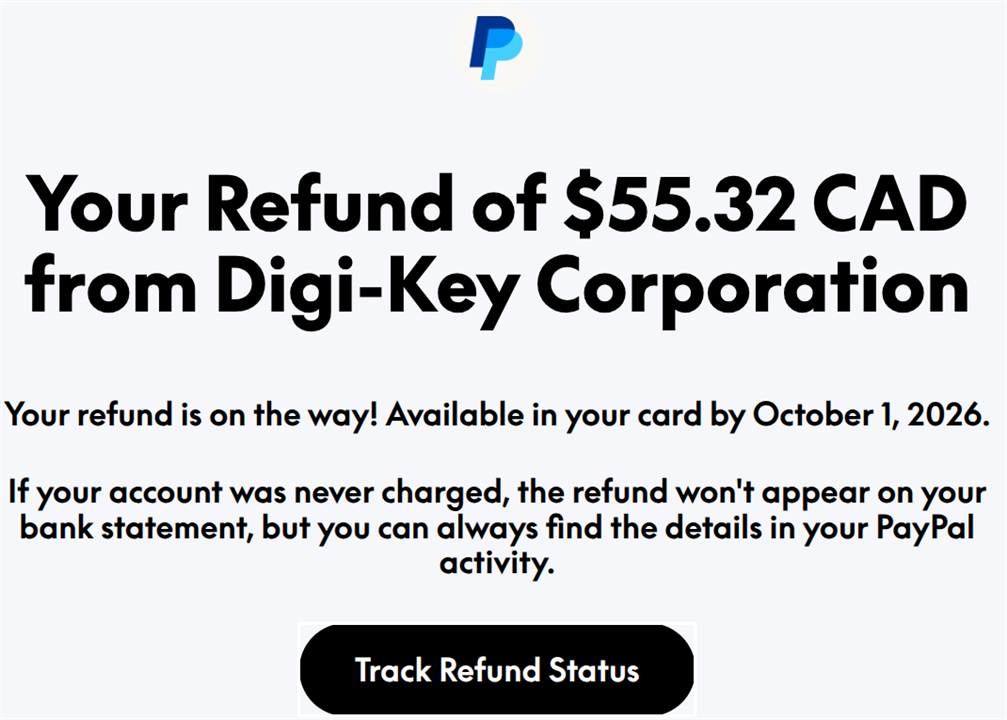

  • colporteur
    colporteur 18 days ago
    The Red Pitaya RoadTest deity are smiling on me. I got reimbursed for the metal case I purchased.
    As of this post I have been unable to find a METAL Red Pitaya case compatible with this hardware. Maybe that is the reason no cases were provided for this RoadTest.
