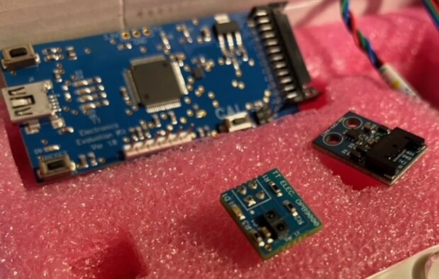

In testing the TT Electronics Reflective Optical Sensor Kit, I decided to approach it from the perspective of use in a prototype or DIY setting where ease of initial setup and integration into a quickly buildt design or system is valuable.  On this point the main board and a second sensor board with wiring harness and mounting holes proved best for me.
All necessary drives were included on a USB drive.  Others have posted more detailed accounts of the software and prototyping support.  All I will mention is that I found the software good and easy to setup on Windows 10.  The only thing I would like to see change on the prototyping system is the lack of documentation and support for the microprocessor demo board.  It would have been nice to know the features and functions of that board more fully, and possibly even have access to the software running on that board to allow for faster prototyping of different applications.

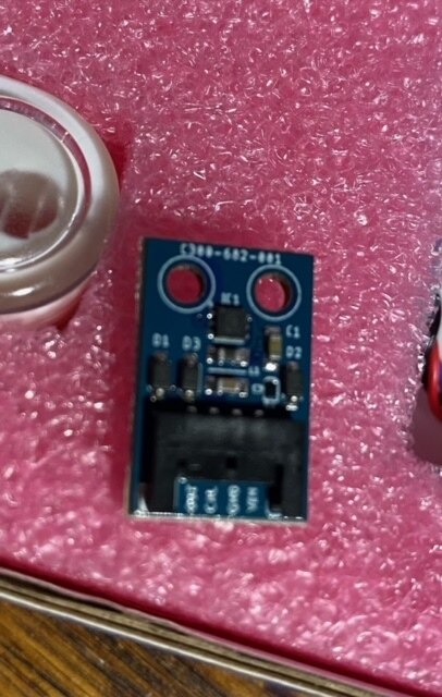

A second sensor module was included.  This module included the capacity for a larger range of input voltages, up to 30V and, most importantly for me, includes holes for mounting screws.  These screw holes make DIY and quick prototyping much faster.
