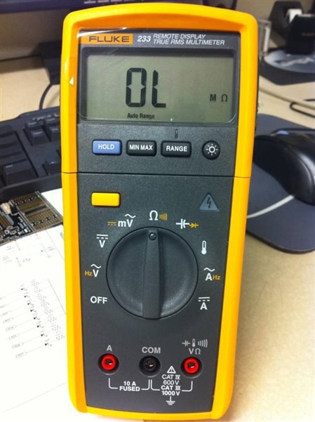

Multimeters have been around for years and there are so many of them out there that it is hard to get excited about a new meter on the market … until now!  The new Fluke 233 True RMS Wireless Digital Multimeter features a detachable display which separates this model from any other multimeter I’ve ever seen.  With this ability you are able to place the display where you can safely and conveniently view it (up to 30-feet away), while the meter remains at the point of measurement. I’m sure this will start a new trend in the world of portable test and measurement equipment and possibly create a new standard acronym “WDMM” (Wireless Digital MultiMeter) in the electronics industry.  I have been using this meter on the job for the past couple of weeks so that I could really get familiar with this unit and evaluate it properly.  In a word … the Fluke 233 WDMM is very cool!

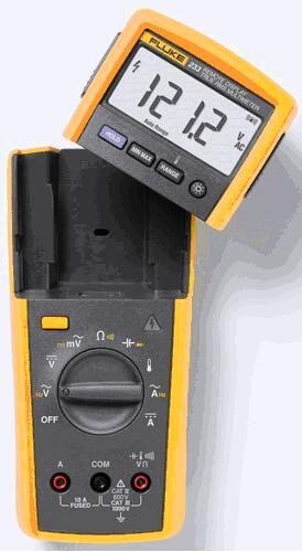

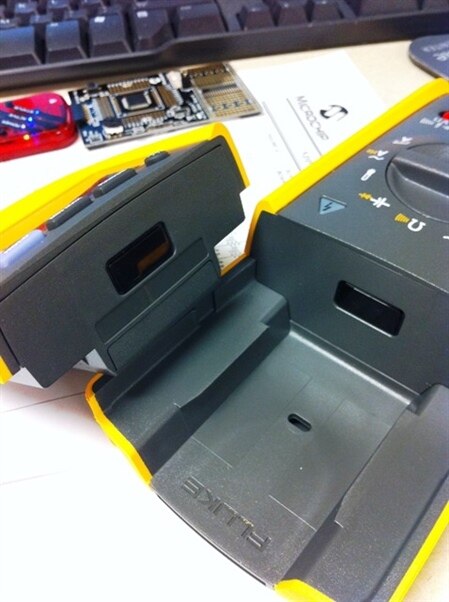

The literature states that it uses low-power 802.15.4 wireless technology ( http://en.wikipedia.org/wiki/IEEE_802.15.4-2006 ) for the display and does not interfere with the accuracy of the measurements. There are not any physical electronic connections used when the display is ‘docked’ with the main unit … it uses infrared communication.  This design element eliminates the possibility of a connector getting damaged when docking and un-docking the remote display from the main unit … that’s brilliant!  This feature adds another dimension of reliability and ruggedness.  Both the display and the main unit require AA batteries (which are included).  The display has a fairly strong magnet integrated into the back of the case which is very handy if you want to stick it on a metal object nearby where you are working.
The package includes the meter, batteries, probes, alligator tips, printed manual (in numerous languages) and a temperature probe.  The only item missing is a protective pouch … which I think should be included in the standard kit. A basic Fluke C35 zippered pouch is about $16 (average) on the internet (the shipping charges probably cost as much as the case).
(Optional C35 Soft Carrying Case)
It is also possible for multiple units to be used in close proximity of each other:  “If more than one technician in the shop is using the new model 233, there will be no problem confusing displays. The remote display automatically syncs with whatever meter body to which it is attached. What's more, the meter automatically assigns wireless channels, which virtually eliminates any possibility of interference between different meters in the shop.”  (Source:  Fluke Website)

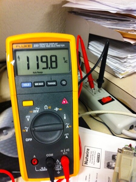

There is even a hazard indicator that lights up red (on the face of the meter) just to remind you about safety precautions when connected to a high voltage … yet another good feature.  In continuity mode, the audible tone is a nice strong volume that can be heard in a moderately noisy environment.
The meter has a rugged feel to it and the rotary mode-selector switch has a nice solid feel to it (with very distinct detents), as well.  The display is very easy to read and has a backlight (not too bright – but adequate).  When the meter has been idle for approximately 20-minutes it will automatically power down.

(AC Line Voltage - notice red hazard indicator)

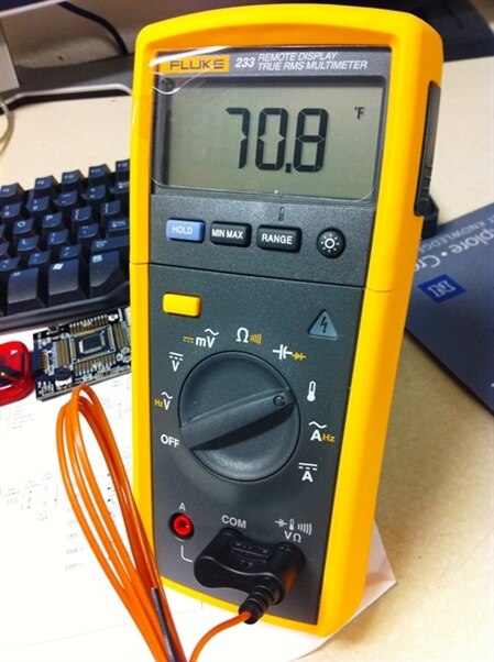

(Ambient Temperature using the temperature probe)

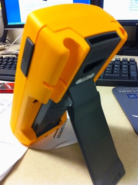

(Integrated Meter Stand)
(View of the communications link)image
