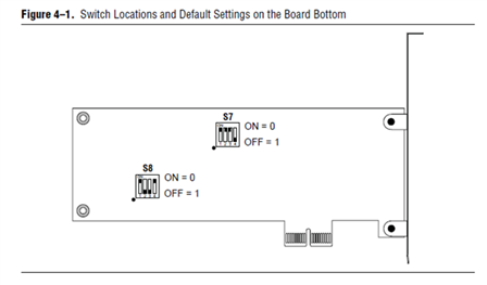

I’ve connected the Ethernet cable to a DHCP enabled network, then I powered the board, but nothing appeared on the LCD.
Reading the user guide (available at http://www.altera.com/literature/ug/ug_civgx_trans_starter_kit.pdf), I checked the dipswitch configuration.
Initially, all the switches were off.
Reading a bit more, I found out that switches must be configured to match default settings and I configured them as specified in the user guide:
I’ve reconnected the board to the network, and finally an ip appeared on the lcd screen: 172.16.51.192.
Writing http://172.16.51.192/ in the web browser, the Board Update Portal appeared.

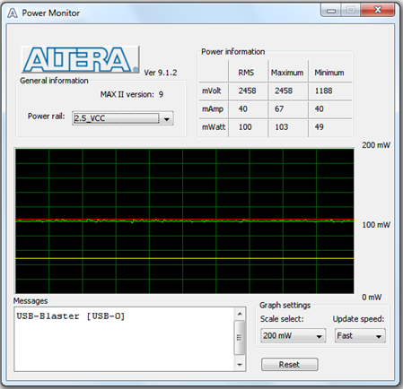

I configured the FPGA with GPIO, Memory and Ethernet Design, then I went to the Ethernet tab. This demo uses an embedded Nios II core to run a simple socket server. The board requested an ip from the DHCP server, then I could use the simple socket server to toggle the user leds .. very nice.
A button from the Board Test System application captured my attention: "Power Monitor".
100 mW while running the simple socket server .. that's not bad for a FPGA ! When I read 65 W on the power adapter I thought that this board is power hungry.
