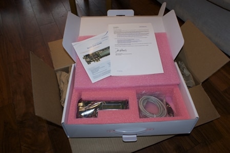

And inside the box:
The box contained:
  • A welcome letter
  • Getting started guide
  • Cyclone IV Eval board itself
  • Network LAN Cable
  • USB Cable
  • Power Supply with UK, Euro and USA power leads
  • Mounting hardware to add a PC Slot backplane
  • A PC Slot backplane
The letter tells you where to get all the latest versions of the required development and eval tools.
