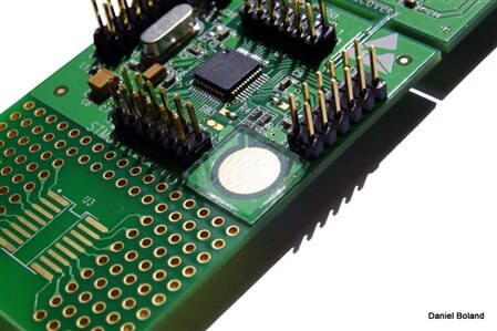

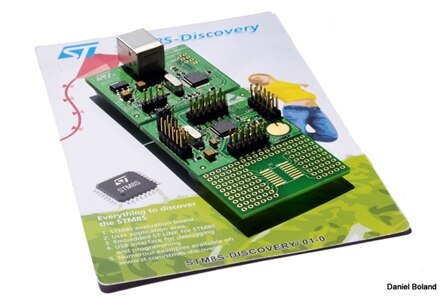

Currently at £5.25 at Farnell, the STM8S Discovery is the cheapest way to break into microcontroller (MCU) development. With the inclusion of a touch-sensitive electrode, it’s a refreshing change from the array of cheap demo kits I’ve got lying around. The programmable microcontroller is the STM8S105C6, one of ST’s 8-bit MCUs featuring a clock speed of up to 16MHz and 32KB of flash. The list of peripherals can be seen in its datasheet and is pretty standard, with 38 I/O pins, a 10 bit ADC and debugging ability. One neat feature is the programmer can be snapped off and used separately from the rest of the board.

The Discovery comes preloaded with a demo program which demonstrates the use of the touch sensor and an included LED. It can be run by simply connecting the board to a computer via a USB A to B cable (not included). If you place a finger on (or even just very close to) the sensor, the LED will flash at different rates. The code for this demo is included on ST’s Discovery website and is written for Cosmic’s C compiler. Raisonance have produced an Application Note for porting code written for the Cosmic compiler. I happened to choose Raisonance and so getting started with compiling the demo took a bit of work, choosing Cosmic should be easier, though I’ve yet to try it.

For the price, this kit is a no-brainer. I’d really like to recommend it to lecturers for use in the teaching labs but the lack of beginner support is a potential sticking point. The ability to develop touch applications would no doubt help interest students in MCU programming. For those on a tight budget, getting into MCU development for a fiver is a great deal, similarly for those interested in touch sensitive applications. For a little more money however, there are other options with much more support and on-board peripherals. As I do work using this kit and the associated libraries, I will update this review and conclusion.image
