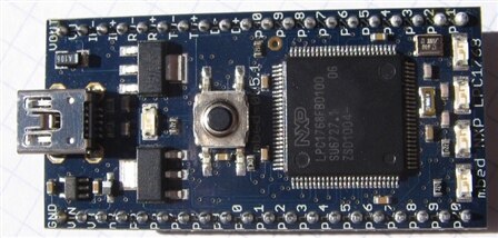

     2x20pin board with mini-USB, reset button, power/status led, 4 leds. All 5 leds are blue and strong enough to distract your attention.

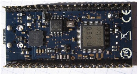

    Front view
    Back viewimage

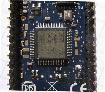

    The mbed interfaceimage
    The board runs like a breeze. The bootloader programs the LPC1768FBD100,551LPC1768FBD100,551 very fast.
