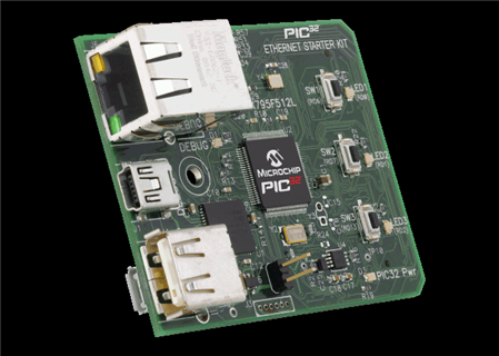

-          The PIC32 ethernet starter kit board :
o   PIC32MX795F512L (test processor)
o   PIC32MX440F512 (embedded debugger)
o   Ethernet Phy (external Ethernet phy layer)
o   3 switch + 3 led
o   Connectors
§  Ethernet
§  Mini USB  (debug/program)
§  Micro USB (device application)
§  USB type A (host application)
-          CD-ROM (Microchip starter-kits drivers and tools)
The board is small (credit card size) but got an application connector (high density FX10A-120P/12-SV1(71))

You can see a photo of the board, there are also links to documentation, schematics….

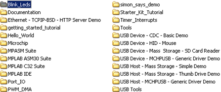

The install also created the folder C:\Microchip Starter Kits\PIC32 Starter Kits with the following folders :
There is a lot of examples, documentations …
