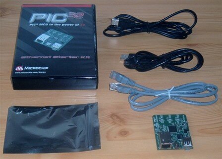

Package content
The kit came in a handy book-sized black plastic box. It contained the following items:
  • PIC32 Ethernet Starter Kit Board
  • USB mini B  to  standard A cable - to debug and powering the board
  • USB micro B  to standard A cable - for USB application development (to communicate between the PIC32 and the PC)
  • RJ-45 CAT5 patch ("straight") cable for Ethernet connection
  • Software CD
  • Registration card

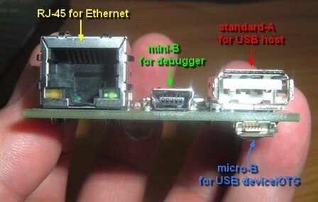

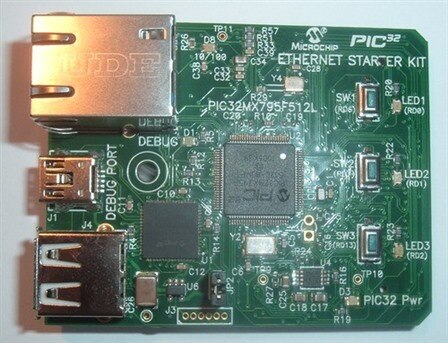

The PIC32 Ethernet Starter Kit board is a small, compact circuit board containing an PIC32MX795F512L 32-bit microcontroller, an on-board debugger (surprisingly the debugger is realized with a PIC32MX440F512HT-80I/MRPIC32MX440F512HT-80I/MR MCU so the Ethernet Starter board actually contains two PIC32 MCUs), an Ethernet PHY, a 3,3 V regulator, connectors, LEDs for state displaying, and three LEDs and pushbuttons for user interaction.  The board has compatible form factor and expansion connector as other PIC32 Starter Kits. The circuit can be supplemented with an 32 kHz oscillator for the RTCC (see the unpopulated place for Y3, C15 and C16).
The PIC32MX795F512L microcontroller has 512KB Flash/128 KB RAM, on chip 10/100 Ethernet MAC with MII/RMII interfaces, 2 x CAN2.0b modules with 1024 buffers, USB host/OTG/device connectivity, 6 UART, 4 SPI, 5 I2C, 5 timers with CCP, 16 ADC channels, RTCC etc.
The block scheme and the circuit diagram in the PIC32 Ethernet Starter Kit Schematics.pdf helps to understand the role of the connectors: the USB mini-B connector is used for debugging. It can be also used to provide +5V supply for the board as well as for the USB host applications (in the latter case the JP2 jumper should be installed). The USB micro-B connector (on the back side of the board) is used for USB device or OTG applications or to provide power for the board. The USB type A connector is used for USB host applications. The VBUS power can be obtained from the computer through the debugger cable (in this case JP2 should be installed) or from an external +5 V source through the 132 pin extension connector (in this case the JP2 jumper should be removed).
