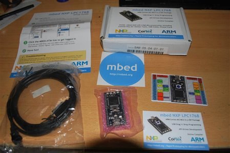

First, how it looks! For those who are curious, the mbed comes in a small box with a bunch of stuff inside; see the photo below:
One thing I especially like is how they give a very nice reference card with all the pinout functions of the board in it. I'm not sure why there's two in the box - a paper card and a plastic card, completely identical. I also liked how it comes with a VERY long USB cable - over 1.7 m in length. I'm using a laptop myself but I can see this being very useful for people who are using desktops that are tucked under their desk, in the cupboard etc. It's probably a bit too stiff to be used as a tethering cable though, in case you want to make a robot with it. The paper on the top left is the quick start guide, while the circular thing in the center is a sticker (which now resides on my luggage)
There are some not-completely-filled-in solder pads, but they are on the USB port mounting holes, so that's tolerable. The rest of the board have nice soldering job on them. The mbed includes ethernet PHY chip, so ethernet projects only require a set of magnetics and the jack to get going. The board is clearly designed for prototyping with a breadboard with the presoldered pins. There's two micros on board: the main LPC1768 (which is pretty beefy as far as microcontrollers go) and a mbed magic chip (which provides the USB connectivity, flash drive interface, serial, and all the nice other things). The board have output power from the onboard regulators (to power small prototype circuits while developing) and also a pin for input power (when you finish development and now leaving it standalone).
