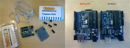

The Amicus18 and companion shield arrived in separate PET plastic boxes. Each is protected in an antistatic bag and foam. Surrounding the foam is a printed paper label. There is no documentation or software included with the products, just a web address to their location online. The packaging is certainly underwhelming, but I commend the lack of waste and use of recyclable materials where possible.
  • Hardware:

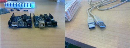

The Amicus18 and shield appear to be well constructed. Comparing to the Arduino: the boards are of equal quality and the same form factor. The Amicus18 adds additional voltage breakout pins, and PICkit compatible ICSP pins. The board has an onboard red LED for power and red and green LED’s for TX and RX communications respectively. The “hello world” LED found on pin 13 of the Arduino has been omitted.
It is important to note that the PIC MCU provided with the Amicus18 is a 3.3V version. This could be an issue when connecting to 5V logic IC’s and shields. The Amicus18 manual states that a 5V chip can be substituted, and that 5V shields should work normally with the 3.3V chip. Conveniently, there is a regulated 5V output rail on the board.
It is quickly obvious that the Amicus18 uses a Host USB-A socket; as opposed to the USB-B and mini-USB that are more common in devices. Fortunately a cable was provided with the board I received. I’m not sure if the USB cable is ordinarily provided free of charge with the product, so this could be an extra expense to factor in.

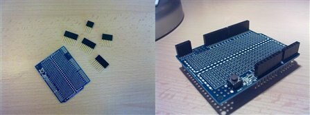

The companion shield received with the board, is a plain and simple prototyping PCB. It contains a reset button, power led and area to solder on custom components. The pins/headers for the shield arrived un-attached. Apparently pre-soldered boards are available. It was no problem soldering the pins on as the PCB is of good quality, and the solder flowed well.

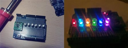

Well I've told you how I found the Amicus18. When I get the chance I'll post about the projects that I undertook with the Amicus18 and what I found easy/hard to achieve on it. Basically, I soldered on 6 RGB LEDs and a 3-axis accelerometer and messed around from there. image
