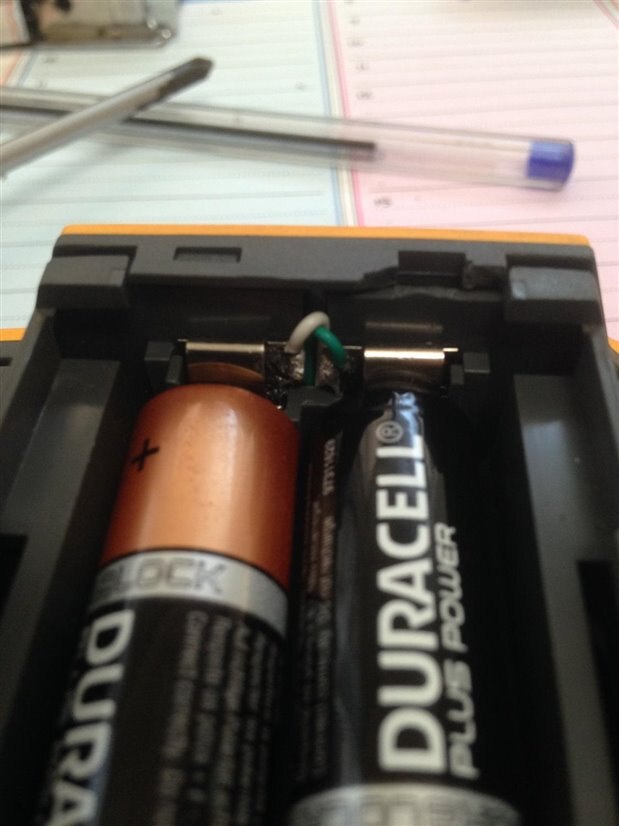

I have had my Fluke 233 just over 4 months now, over which time it has  had pretty light use. Which is why what I am about to say is a bit of a  surprise.
In my review I wrote:
Batteries.  400  hours  estimated life is  excellent. That probably works out at 3 to 4  years  usage for me. But,  when they go, it does mean potentially 5  batteries  have to be replaced.
I have used it for maybe 5 hours use  at the outside, and not at all for the past month or so (sadly, my  engineering has mostly been on paper or PC recently). That doesn't sound  much, but it adds up to quite a few voltage and resistance  measurements.Anyway, I came to use my Fluke 233 today and this met me:
http://i222.photobucket.com/albums/dd237/Zadpics/FlatBattery.jpg
Pretty much running on empty! Removing the remote head results in a BATT  warning and no measurements are possible. If I am going to be  installing a new set of 5 batteries every 4 months then it becomes a very expensive meter! I had thought that using high energy density AA  cells was a good idea (the cells it came with were brand new Duracells  with a very long use-by date), but maybe Fluke are covering up some  nasty quiescent current use. Swapping out the batteries allowed me to test  the off-load voltages, which were all around 0.95-0.96 Volts, so that rules out a rogue cell failure. My investigations with my trusty Fluke 77 (battery age 4 years) revealed the following:
Body power consumption, power ON = 3 to 6mA
Body power consumption, power OFF = 0.9 to 1.1mA
Display unit, power ON = 3 to 3.6mA
Display unit, power OFF = 1mA
Looking at http://www1.duracell.com/oem/Pdf/new/MX1500_US_UL.pdf the nominal capacity for <5mW drain is 1600 to 2300mAh (to 1 volt). 2300mAh at 1mA, is 95.8 days...
You  will note that an "on" life of 3mA is 766 hours, and 6mA is 383 hours,  which averages close to the specified taget of "around 400 hours".  Presuming you use your meter 24 hours a day, and don't actually switch  it off...
Given the recently found RF vulnerability in the Fluke 87 V, it does   make me wonder if Fluke are taking their eye off the ball. It surely cannot be right that a   meter eats a set of 5 cells in 4 months, especially given such light   usage. This is certainly not the sort of meter to leave in your tool case, because chances are that the batteries will be flat when you need it.
If any other Fluke 233 owners have experienced any similar failures, please let me know!
If any Fluke reps see this: Is there a known fault with the 233? Because this does look like a bit of a killer design issue.

    Hello Mike, Coincidentally, the batteries of my Fluke 233 died last week, after approximately 4 months of light use. As I suspected in my review and which you confirmed above, it is not possible to turn…

    Well, I must say Fluke is trying hard. The concept of Fluke 233 is very good and I hope they keep this product alive for a long time like the 87V. I hope they don't think the CNX series can replace this.
    Yes, there is a firmware update to improve the battery life. However, I think (I am not able to get confirmation from Fluke), there is also a hardware change for those serial nos >22500000. There is also a slight change in the way you wake up the display when it goes to sleep if it is not docked.

    Sorry that some of you have had problems with Fluke.  I for one think they are not only the best when it comes to test equipment.   The problem with the meter is not hardware.   It is firmware, the problem is fixed when they reprogram the meter to turn off.   That happens whit firmware revision 2.0   If you want to check your meter to see what revision you have, it's easy.
    "Hold down the "hold", turn meter to vdc. After a few seconds the display comes up with V1.00, V1.01 or V2.00. V2.00 has the battery fix."

    Just had my meter returned and updated to version 2. The technician said that hardware updates may be involved. The current draw has decreased as follows:
    Base unit: 0.086mA
    Display unit: 0.11mA
    This is an order of magnitude less than the original so for a 3AH battery the lifetime is now over 3 years in theory. This is quite significant.
    Now the specification for the battery life can be believed as the operating battery life should not be significantly diminished if the battery is off.
    I think that the original meter (prior to version 2) made the specification for the battery life entirely incorrect: the batteries never lasted 400 hour over a reasonable battery life of 3 years, let alone 1 year. This is because it is generally understood that battery life is not significantly reduced when it is off, and there is nothing in the specification that says otherwise. It seems that Fluke are happy to fix this problem if it is within the warranty period otherwise. In Australia failure to fix the problem and the false specification for the original version easily violates the Competition and Consumer Act.
