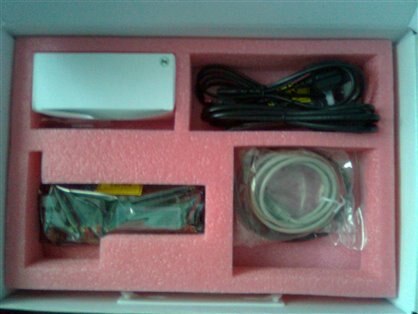

The kit arrived very well packed, in a big box, bigger than I was expecting.

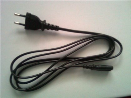

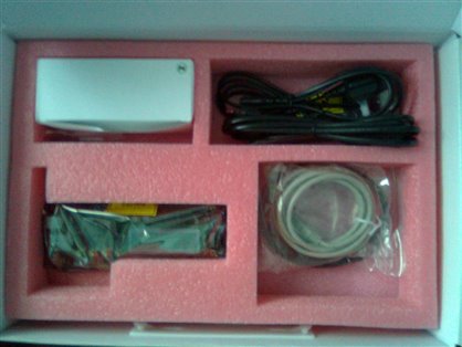

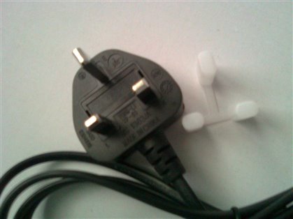

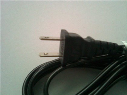

It was very nice to see that it includes 3 types of power cords, making it easy to use the kit in any country.
     The kit also includes both an USB cable and an ethernet cable, so it can be used immediately, saving the user for the hassle of finding an ethernet cable in order to play with the board.
     There is no CD or DVD included, but I don't think that this is an impediment to it's usage, since in our days most of the people have good internet connections.

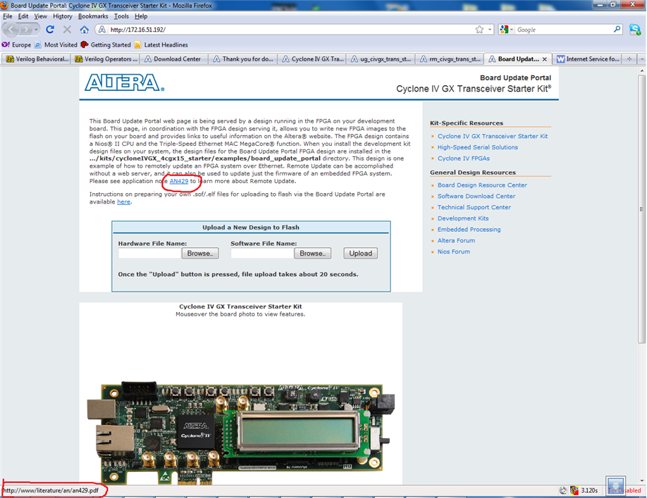

     The kit is very nice, but there are lots of small issues that make me think that it was designed in hurry. For example, a broken link, that can be seen on a page running from the demo:
     I think that those minor issues should be solved because I'd think twice before making a big project on a platform that has a lot of minor issues. I wouldn't like to increase the development time unnecessarely because there are some bugs that sit on the way.
