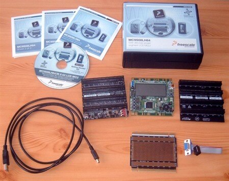

The TWR-S08LH64-KITTWR-S08LH64-KIT came in three CD-sized black plastic box. It contained the following items:
    * The TWR-S08LH64 demonstration board
    * USB mini B  to  standard A cable - to program, debug and powering the board
    * RS-232 "pigtail" cable - for communication with the PC)
    * Elevator modules
    * An empty prototype card
    * Software and documantation on CD
    * Quick Start guides for the installation and for the attached demo program.

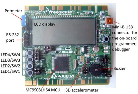

The TWR-S08LH64 controller board accepts any member of the MC9S08LL or MC9S08LH family of MCU’s from Freescale (the board has dual footprint for 64 and 80 LQFP packages). The board being reviwed is populated with the 80 pin MC9S08LH64CLK controller (see the black marks below the LCD on the next photo) which has 64K bytes flash and 4K bytes RAM memory.
The board fetures the following peripherals: MMA7361L Analog Accelerometer, RS-232 Serial Interface, Segmented LCD display, 1 Reset button, 4 Pushbuttons, 4 LED Indicators, 5K ohm Potmeter, Light sensor, Piezo Buzzer.
There is also an on-board Open Source Background Debugger Module (OS BDM) for (program downloading and debugging) fully supported by CodeWarrior. The board can be powered form the USB connector of the OS BDM, from the edge connectors or from a battery holder (CR2325) which is located on the back side of the  board. The TWR-S08LH64 controller board also operate as a standalone debug tool that can be purchased separately from the complete kit.

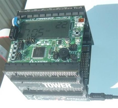

The following photo shows the assembled TWR-S08LH64 Kit. The power is obtained from the power-only Mini-B USB connector of the elevator module. The the built in demo program is running.

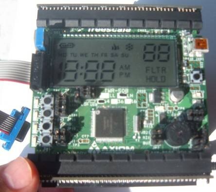

In the following photo I tried to catch that moment when all of the LCD segments are swithced on at the beginning of the Quick Start demo. It gives you information about the capability of the LCD module.
