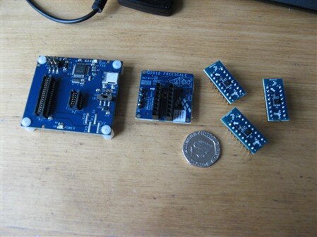

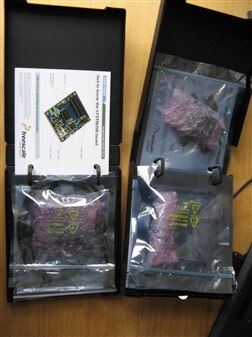

I received 2 nice CD-sized boxes with documentation and components. The hardware components were individually wrapped in bubblewrap and seemed well protected.
The documentation included packing lists so I am confident I got everything, a tech support card, a warranty registration card, and a 2 page full colour quick start guide with very clear identification photos.

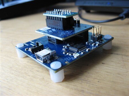

The hardware received was a suitable USB cable, the larger LFSTBUSB board which sits on the bottom, the MMA845X interface board which plugs into the top of the USB board, and 3 breakout board DIPs with 3 different accelerometers that plug into the top of the interface board.
The three accelerometers represent the MMA845xQ family:
  • MMA8451QTMMA8451QT - a 14 bit accelerometer
  • MMA8452QTMMA8452QT - a 12 bit accelerometer
  • MMA8453QTMMA8453QT - a 10 bit accelerometer
The boards are clearly well made. The USB board is even pre-fitted with plastic standoffs as legs which is a nice touch. There are clear markings for pin 1 for each connection so it would be very hard to make a mistake. After assembly you end up with a three layer stack.
