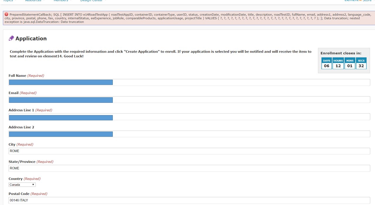

This is error message I get when I try to submit:
PreparedStatementCallback; SQL [ INSERT INTO e14RoadTestApp ( roadTestAppID, containerID, containerType, userID, status, creationDate, modificationDate, title, description, roadTestID, fullName, email, address1, address2, language_code, city, province, postal, phone, fax, country, internalStatus, eeExperience, jobRole, comparableProducts, applicationUsage, projectTitle ) VALUES ( ?, ?, ?, ?, ?, ?, ?, ?, ?, ?, ?, ?, ?, ?, ?, ?, ?, ?, ?, ?, ?, ?, ?, ?, ?, ?, ? ); ]; Data truncation; nested exception is java.sql.DataTruncation: Data truncation

    0 Dudley over 9 years ago in reply to jdlui
    That's an awesome piece of detective work there jdlui , and a great citation of why I really like this job image
    If I'd been trying to track down what had happened here without your input, this would have wound up as a "Could not reproduce". But as it is, it's really obvious what is happening here - we have a limit of 10 characters on that postal code field, but chrome's autofill has managed to bypass that limit and that's what is causing the breakage.
    I'll create a ticket to firm up the back end code so that in this instance, it gives you a much more friendly error message image
    Thanks for your hard work. And I'm glad you managed to get your application in! Good luck!

    0 jdlui over 9 years ago in reply to Dudley
    HI Dudley,
    I'm applying for the tinyTILE roadtest. My submission is viewable here: element14 tinyTILE IntelRegistered CurieTm Based Board
    Please see my comment at Apr 12, 2017 7:51 AM for some more detail on the issue.
    How I caused the error:
    I allow Google Chrome fill fields and it inserted an 11 char string into the postal code field. Example 00146 ITALY.
    If I click submit now, it will crash and give SQL error.
    However if I delete a single char so that it's length 10, it will submit happily. Note I cannot physically enter the characters again. I guess Chrome's autofill inserts text a bit differently and this bypassed the webpage form coding on Element14 site.
    Here is a screen shot where I replicate issue on a different roadtest.

    0 Dudley over 9 years ago in reply to Dudley
    There are at least two bugs here, one is that we're presenting you the actual error, and the other is that you're getting the error at all image
    The first one is a doozy and entirely on me as the coder of that logic, I've got an untrapped error that I'm presenting to the user, and I'll get a ticket raised to get that fixed in the near future. Oops!
    The second one is the one that is causing you the drama. The error in question is a database related error, and happens because you the system is trying to insert into a fixed width column, and the data you are inserting is wider than the fixed width of the column. If this error were being trapped, I'd have a lot more information as we automatically log the data that caused a data trunc error, but because somehow this error is slipping the net and not being trapped, none of that has happened.
    So one of the fields you are entering is wider than is allowed on the database. The question is, is this one of the ones that you have entered, or is it one of the ones that I enter under the hood for our own internal use. I can't see the data you're trying to insert (because you've not inserted it), and I can't see any more information in the logs than what you've already given me.
    Thank you for the suggestions Andy and Frederick.
    I played with it a bit further and managed to find the problem. I have now managed to submit my application. The issue was not in the word limit of the main submission, but the character limit of postal code field.
    Problem was that I was allowing Chrome to autofill my address details. This shouldn't cause an issue in theory but I noticed that Chrome seems to be overfilling the postal code field (I cram my postal code and country here since there is no country field in the application).
    Chrome autofilled 11 characters into this field, but I can see when I erase the postal code field and manually type it, the browser truncates my text at 10 characters. So this is where the truncation error was in that SQL error.
