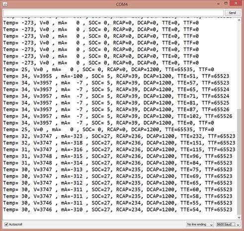

So given the issues with CCS I decided to simply write the code in Energia, this would be more useful to many readers as there are no sample code I have been able to see so far...
If I send a read to the Fuel Gauge for any one parameter it will work without a problem (See Views below)
If I try to grab a series of values like Volts, Avg Amps, Temp then it all goes wrong, I have tried many variations of code to no Joy, currently I suspect it may be the Wire library
below is the start of my demo code for the Energia IDE, compiles ok, uploads ok, works on multiple platforms ok except for the one issue, cant read more than one parameter without going wrong.

This is the output from the above code, as you can see the mA reads correctly (Verified with a meter), discharging at a rate of 15mA so -15

does it all go wrong, I can find nothing in the data sheets to say you can not do this, and if you look, the last measurement is actually reflecting the previous request, as in the Voltage reading
I can re-arrange the order of requesting the parameters and the affect is the same, the last one reflects the previous and the others are garbage. Is smells of a memory issue probably in the Wire or TWI library, I look at the wire and could not find anything obvious.
So if any of you Energia experts out there with some I2C knowledge can help, suggest workaround or something it would be appreciated.

    0 Jan Cumps over 12 years ago
    I've been using the FuelTank now with multiple i2c masters, and it seems that the battery gauge is fuzzy about the timing of i2c.
    It works good with the C2000 Piccolo launchpad without having to send code twice. The code referenced by the FuelTank starter pack just works fine.
    Also when using it with the Bus Pirate it works without any difficulties:
    When using it with the Arduino Wire library, I need to send the command twice, just like Robert Peter Oakes needs to do in this thread here.

    re the I2C lines, yes there is definitely something funny going on with the device (Fuel Gauge) as when i try to send single commands but change the register for each it will fail for sure
    if i repeat the command for each register it works 100%, I am in the process of figuring out how to stream out the configuration registers to validate the setup as the estimated capacity for all of us is close to 20% lower than expected and my current assumption is it may be due to having too high a cutoff voltage in discharge mode (3.5V is way too early) and the algorithm learns this over time so no surprise it is showing low capacity when charge state is showing 100%. I have no doubt the charged state is correct, measuring the volts with an accurate meter confirms this (A nice 4.2V) so i'm pretty sure it all has to do with the discharge parameters, not the battery or the algorithm.  Problem is I cant find example of how to do this so im working from the data sheets. I look forward to any findings you get from the traffic captures.
