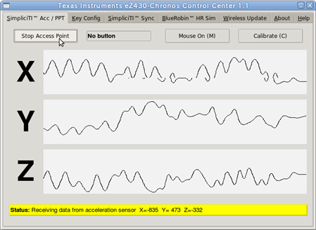

The software bundled with the watch includes the “eZ430-Chronos Control Centre”, which demonstrates various features of the watch by interfacing through the RF dongle. Connecting to the watch is instant, and hassle-free. You are then able to take readings from the on-board accelerometer,  set time, calibrate sensors, send generated heart-rate and speed data to the watch, and even update the firmware. You can even use the accelerometer to move the mouse pointer, and define buttons on the watch as computer keys. The video, controlling the mouse, speaks for itself(which I'll add soon, promise) – geek heaven.
(temporary image - pending video - showing accelerometer output. Wave a bit distorted from image compression - original was fine)
