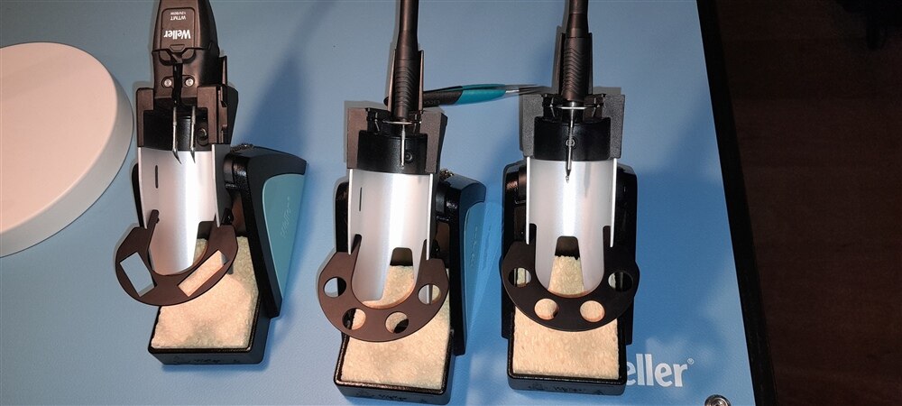

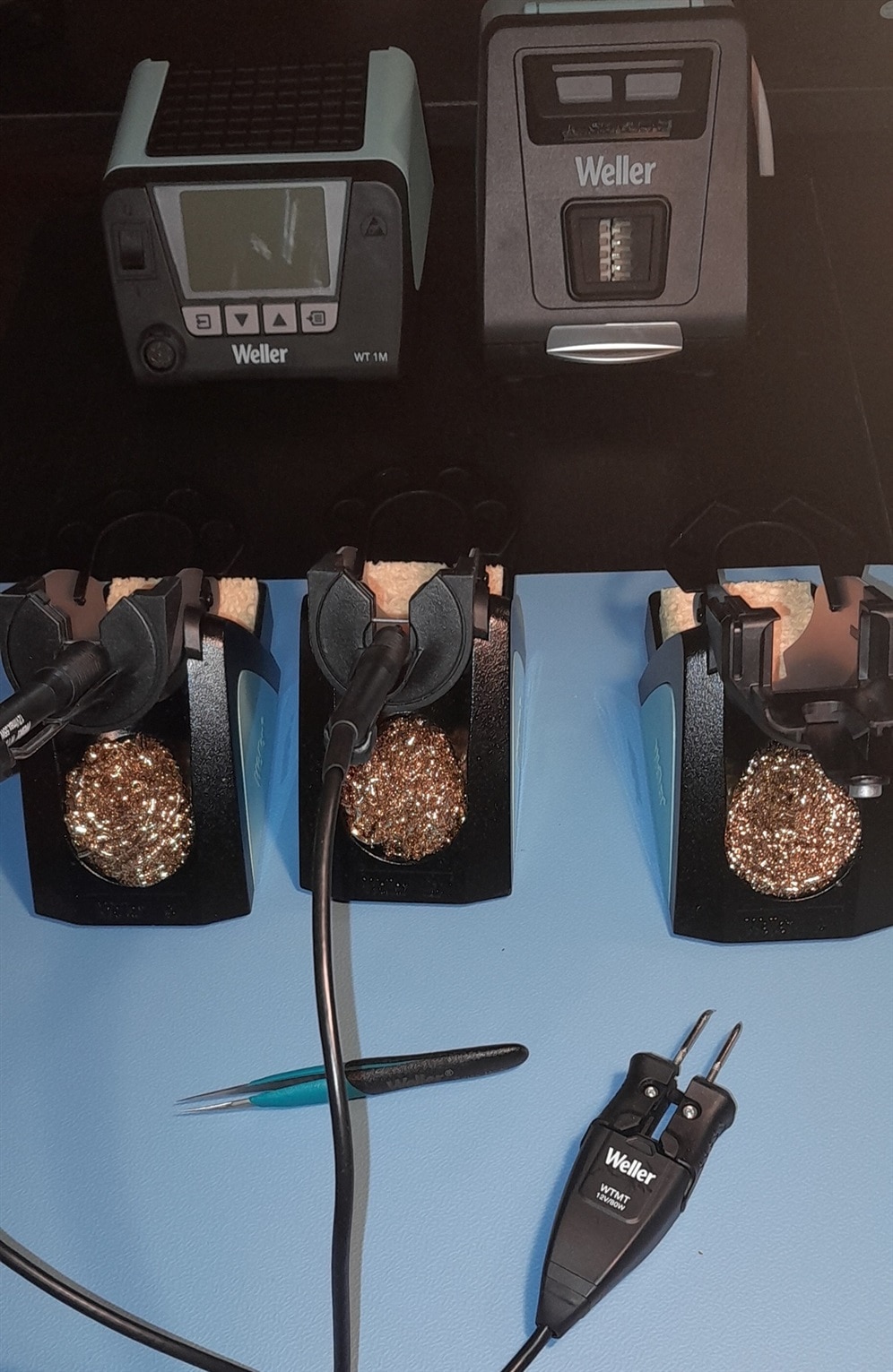

The kits for the Weller Micro Soldering Kit and Filtration Unit arrived. Here are a few early photos of the solder kit
left to right: pico, micro and pincer iron

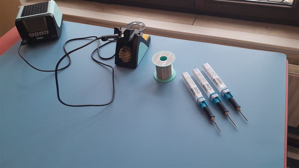

other side
micro iron setup. This is the largest one, 55W

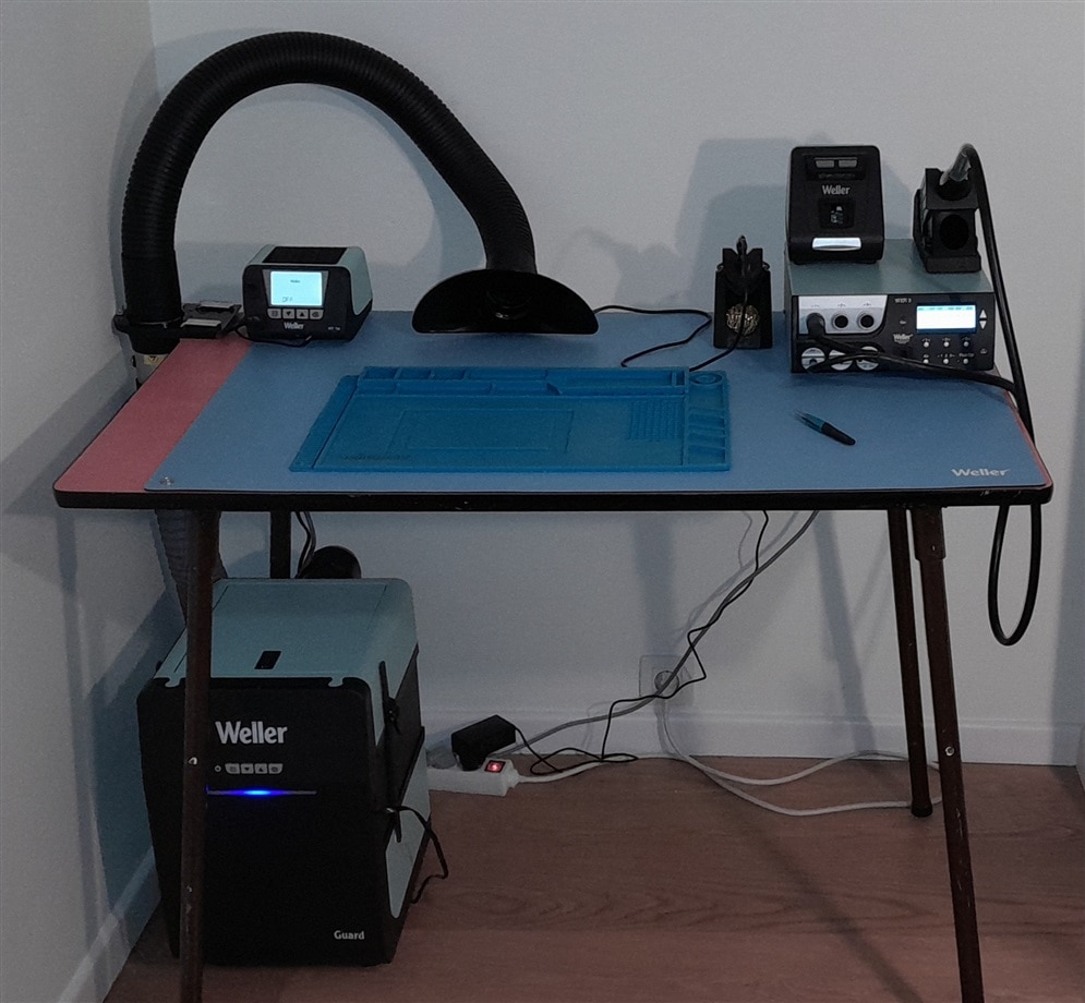

bench setup for the road test

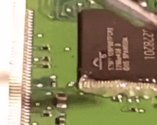

    previous videos were all rework: removing components, and replacing them.
    In this video, I use a fresh PCB and solder new components. A transformer, and a few 0805 SMD passives. Micro solder iron with 1.3 mm chisel tip.

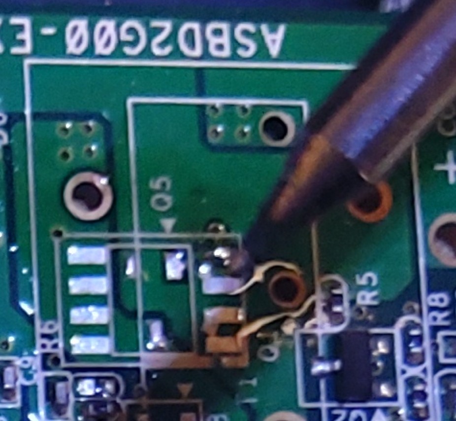

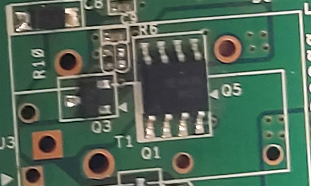

    Replacing an IC - a not-so-small SOIC-8 package
    Original:
    I removed it with a hot air pencil:

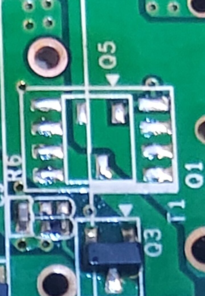

    Cleaned the pads with the Weller micro iron, bevel tip RTM 004B MS (0.4 mm), and solder braid, then cleaned up
    Re-tinned the right upper pin:

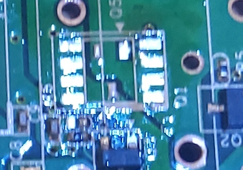

    Replaced the IC, first attaching that right upper pîn, then the rest:

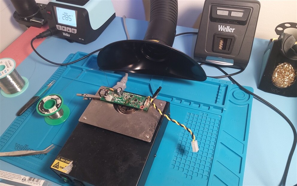

    Bench setup:

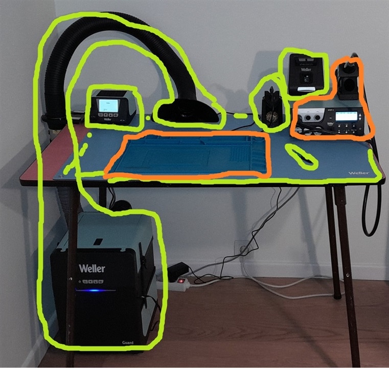

    OwainM said:
    (If it's a desoldering station as I suspect, it's very cool)
    It's the station of a different Weller family: WX. Currently with a hot air pencil attached. I have a solder iron and trough-hole desoldering device for it.
    Items annotated green on this photo are part of the kit. Orange ones I owned before.

    I can confirm that the filter unit is placed under the desk in this photo. The unit on top of the station to the right (If it's a desoldering station as I suspect, it's very cool) is the tip cleaner included within the roadtest kit.

    Is that the filter unit? I thought the provided filter was on top of the station to the right? (Seems to match the first picture in this thread).

    I didn’t realize the filter unit was that ginormous Open mouth

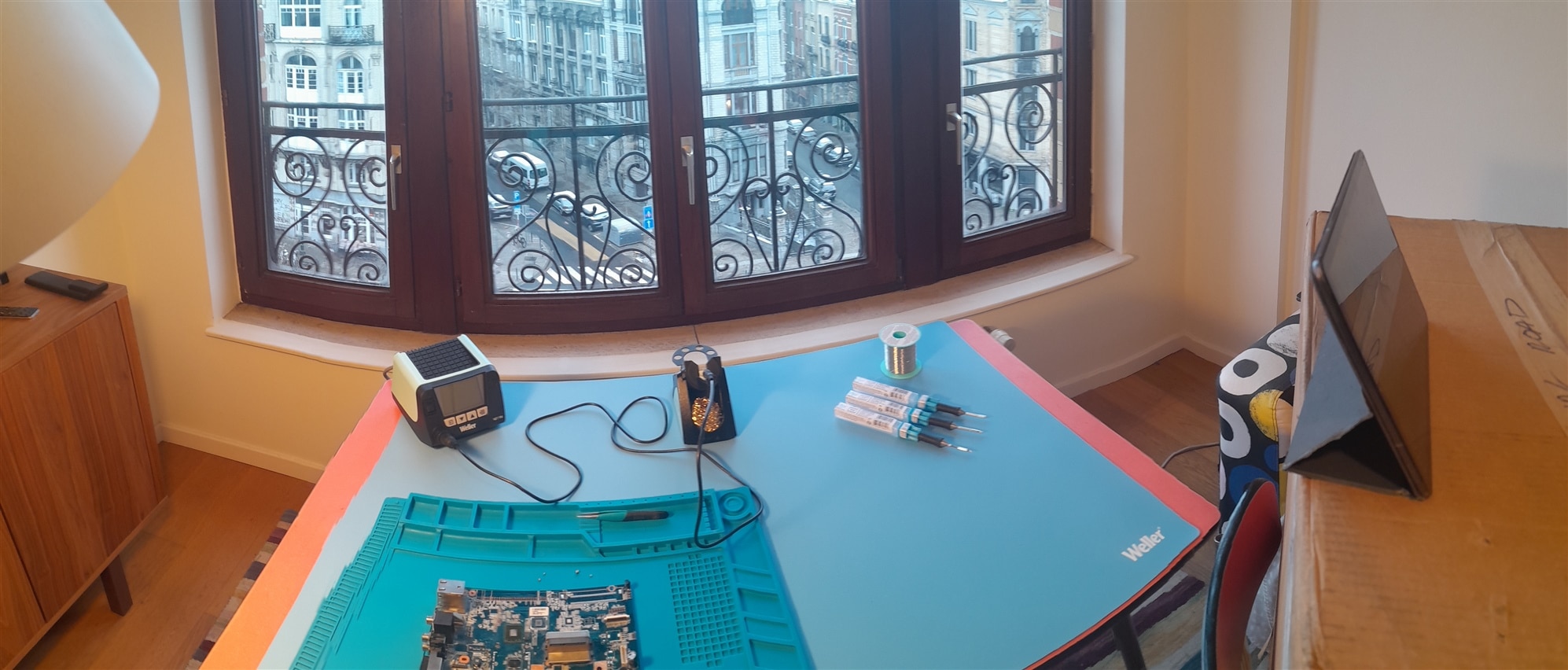

    I overspent my time using the living room as lab. Moved to the study:
