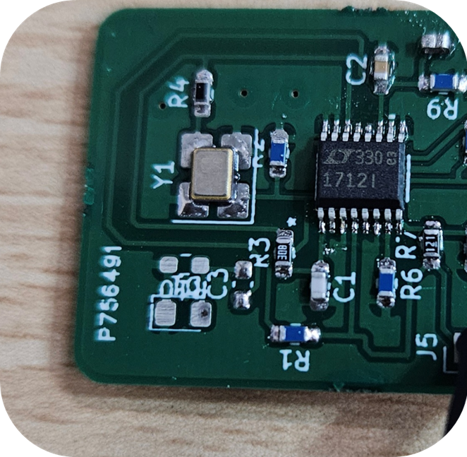

The kits for the Weller Micro Soldering Kit and Filtration Unit arrived. I used the pico/nano solder iron to replace an tiny resistor on a multilayer board.
The pico/nano iron is 40 W, and I used a 1.3 x 0.4 mm chisel tip. Lead free solder and the iron at 350° C
I need magnification to do this kind of work. When soldering, I used the magnifying glasses. The pcb photo was taken with a phone through the loupe:

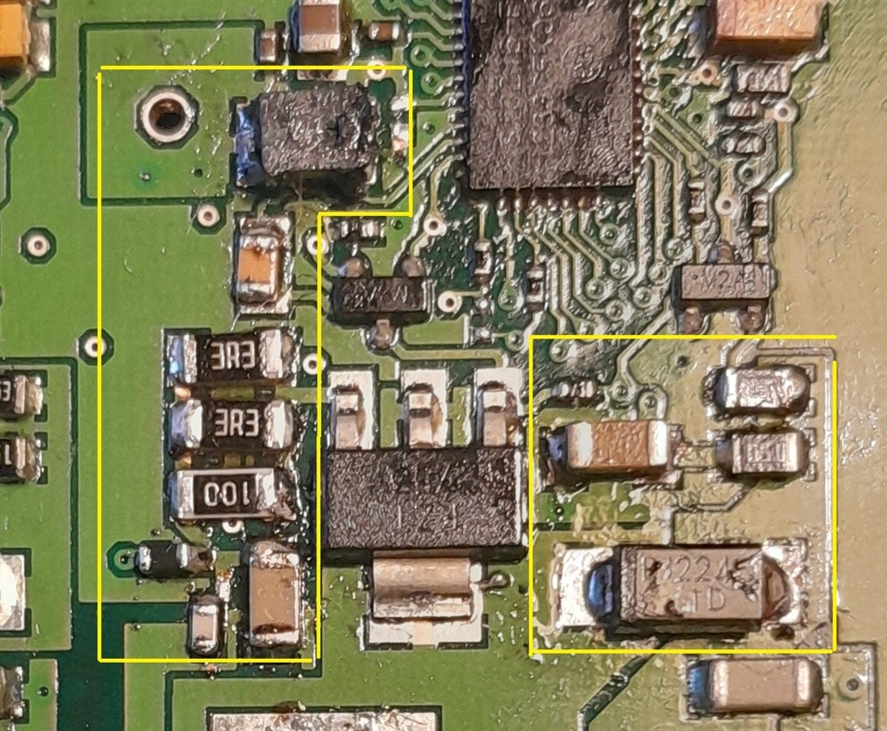

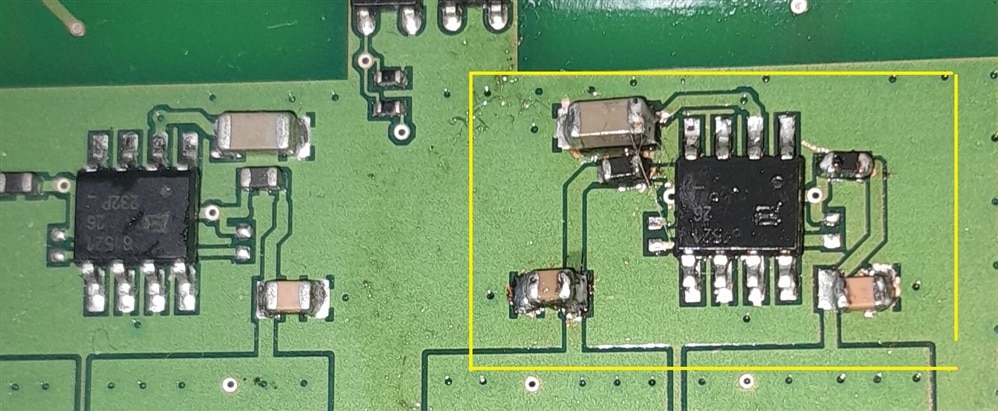

    Jan Cumps 9 months ago

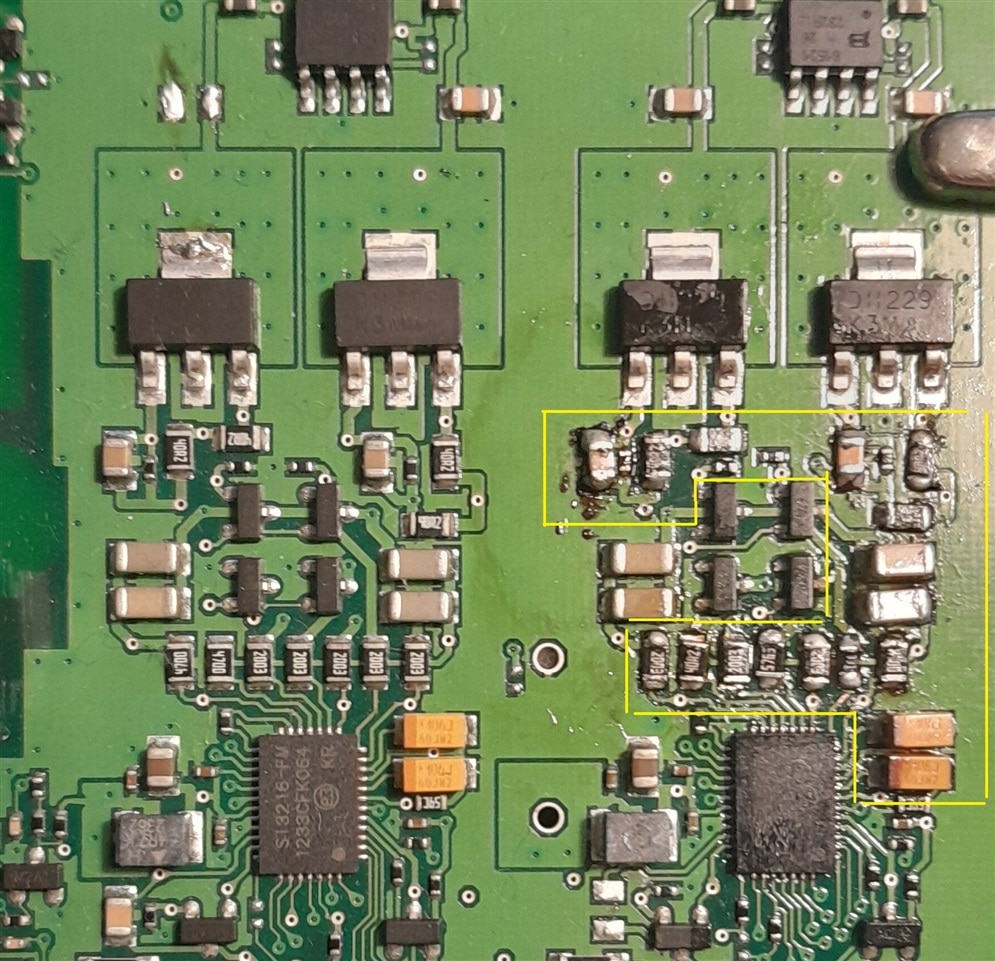

    This exercise is soldered with the nano iron, and the smallest tip of the set, conical 0.2 mm (RTP 002 C MS)
    The photo shows an original area (left) of a Cisco board, and an identical area (inside the yellow lines) on the right that I've soldered.
    I ignored component values, just put correct sized components on the pads.

    Looking at your resistor soldering I think that you would get much nicer looking joints if you used more, or maybe different flux.
    I use Warton Metals Future 315 with leaded solder and it gives very good results.
    https://www.warton-metals.co.uk/flux-pens.aspx
    Its marketed as suitable for unleaded and no-clean. Like all no clean fluxes it does leave some residue and because it's very runny (like water) it spreads out a lot. I usually clean after using it.
    MK
    Jan Cumps 9 months ago in reply to michaelkellett

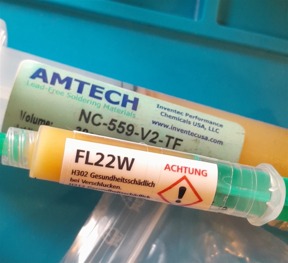

    I used Amtech flux that has that effect. It's good flux - in particular for hot air rework. A paste when it's applied, then turns into a viscose liquid when soldering. With an iron, it doesn't render shiny joints.
    I purchased a different flux a week ago (EDSYN FL2W) that I haven't tried yet. I'll do a few joints with it.
