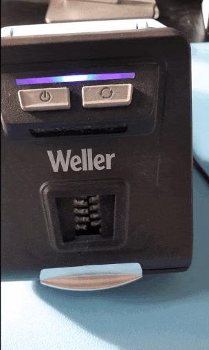

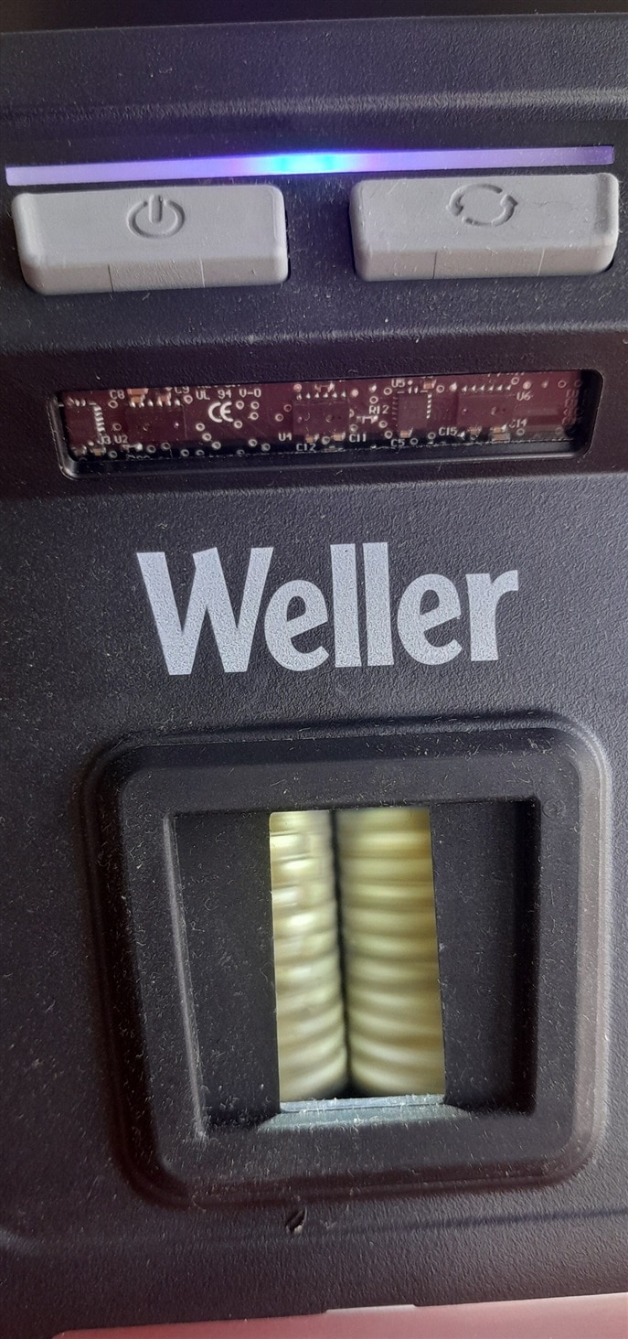

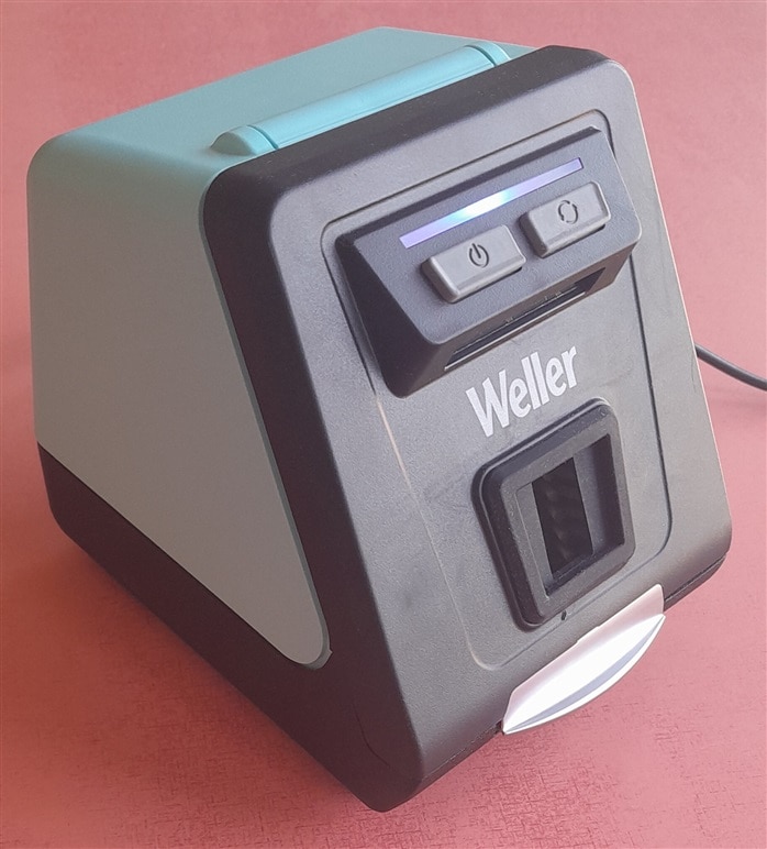

I'm almost finished with the Weller Micro Soldering Kit and Filtration Unit. My last tests are with the automatic tip cleaner.
It has a proximity sensor, and only spins the fiber brushes when your iron gets close to the opening.
    Jan Cumps 6 months ago

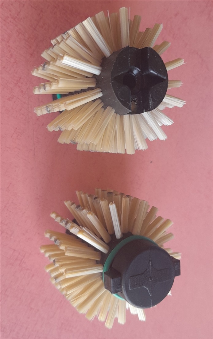

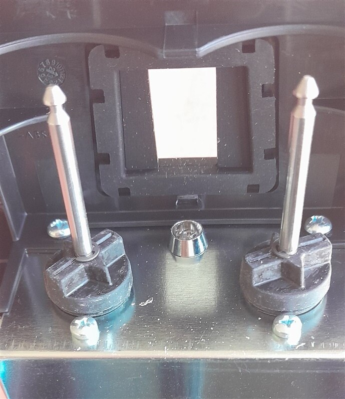

    More photos. Some for the road test review, and some extras.

    Jan Cumps 6 months ago in reply to scottiebabe
    No. There's a rubber curtain at the opening that avoids it, and the brush action is inwards at contact point.

    Jan Cumps 6 months ago in reply to shabaz
    shabaz said:
    Weller model has clearly larger brush heads, plus they are a bit closer together (whereas I have to move my fine soldering tips a bit to get full coverage from the spinning brushes).
    Yes, it cleans the smallest tips too. No need to "wave the iron", just poking once works.
