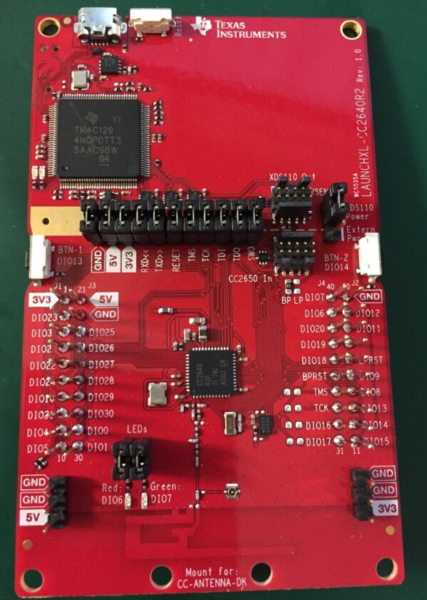

The CC2640R2 fits firmly into both families. It is a rapid evaluation kit for a connected ARM CPU and includes the ARM CPU and a fully qualified Bluetooth 5 Low Energy (BTLE) platform in a single chip.

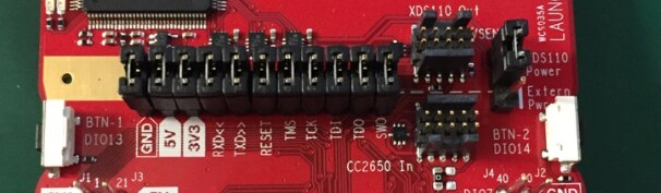

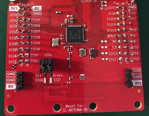

Looking at the image of the Launchpad module you might be forgiven for thinking the business end is the big chip at the top, or that the ARM CPU is at the top, and the Bluetooth module in the middle, but in fact the CC2640R2 chip contains both the ARMCPU and the Bluetooth platform, and is the smaller QFN chip in the middle of the board. The big chip at the top is simply there as a USB interface to the your PC for in-circuit programming, and debug, including single-stepping through code and inspecting memory and variables.

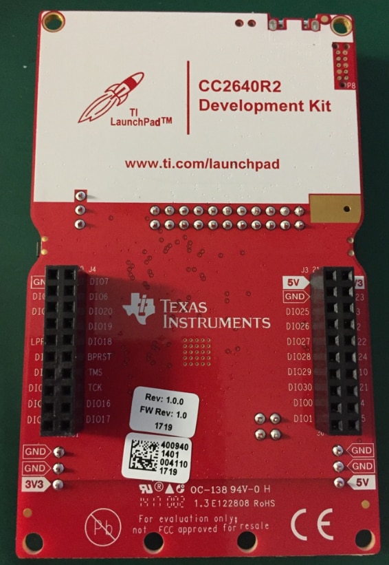

The rear view of the board shows that there are no other components on the module:
The row of jumpers in the middle of the board can be used to completely disconnect the CC2640R2 from the debugger.
This just goes to show how few components you really need to build a fully fledged BTLE connected IoT device.
This image shows basically everything you need for a working hardware design:
