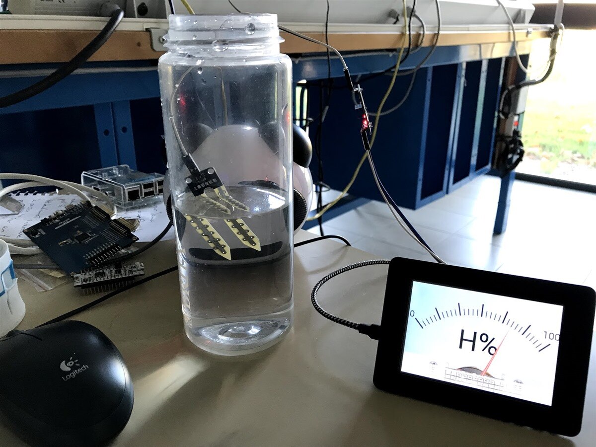

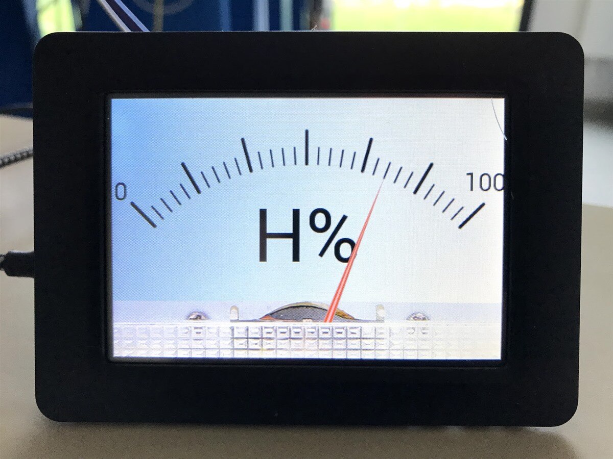

    I came in today to see two students playing around with the CleO. Here are two photos of what they came up with. It isn't the best of quality and I'll try and get a few more done, but it does give you a general idea. The images are crisp, sexy, and frankly, professional. There is, however, a small crack on the screen. Apparently a student dropped it, but it does seem to work fine. I'll give him an F later on. image
