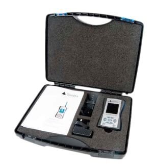

Our tools and test equipment suppliers have really liked the RoadTest program. I think the reviews that roadtesters have provided are detailed, useful, and interesting reports on these types of products. So, I've been contacted by another test equipment manufacturer. This would be another first for the element14 roadtest program. Let me tell you about the SNYPER-LTE GRAPHYTE by Siretta.
The SNYPER-LTE Graphyte is a network signal analyser and cellular signal logger, dedicated to surveying and logging the 4G/LTE (EU), 3G/UMTS & 2G/GSM European networks. The unit can be left to conduct sequential surveys in a fixed location and automatically saving them. Four types of survey can be performed: a “FULL” survey (4G, 3G and 2G combined), 4G/LTE only, 3G/UMTS only & 2G/GSM only.
It can save multiple surveys each with different logging options and all survey results can be downloaded to a PC and displayed in a HTML graphical format to clearly show the logged detail over the survey session. This can identify unreliable base-stations & intermittent cellular service which is not possible with spot surveys. The full breakdown for the HTML summary graphs are displayed in corresponding CSV files (Summary and full detail files). It also incorporates Siretta’s leading liveSCAN feature, which allows you to select a base-station signal immediately after a survey, conduct a liveSCAN logging session which can later be analysed in a CSV logged recording.
The SNYPER-LTE Graphyte (EU) is a good tool for understanding local network performance over hours, days and weeks to assist in the selection of reliable mobile network operators before cellular installations.

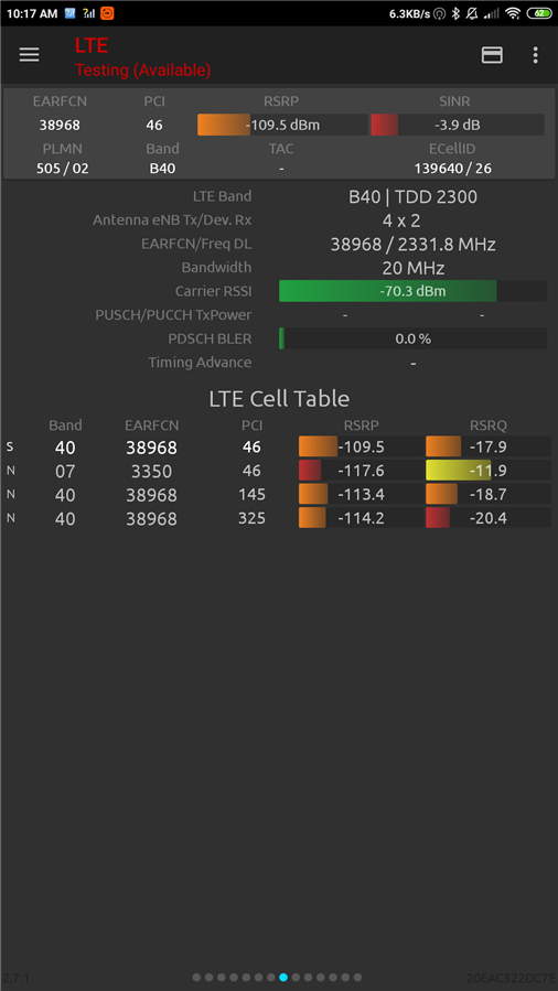

    As a radio amateur and as someone who has suffered from this - I have long been using tools such as Mobile Signal Guru (an app) running on a rooted Android phone with a Qualcomm chipset so I can at least read out information such as the RSRP, SINR, and Cell ID values to know which base station I'm on and if I'm receiving a good signal or better still, carrier aggregation. I spent quite a bit of time on this post on my blog looking at what the local carriers had in terms of frequency/bandwidth/MIMO spatial streams to make some deduction about their relative quality of coverage at my house.
    Above is a snapshot of the signal at the office - on Optus, Band 40 indoors. Not a great result. There's another base on Band 07 that might be usable, but its signal strength is poor despite having a better quality ... the phone doesn't choose to roam to it. The biggest issue with using such an app is that a lot of the better features cost a significant amount of money and that its accuracy and performance are in no way guaranteed. In fact, the values that are read can depend heavily on the antenna design of the mobile phone, the orientation in which it is held and the version of baseband firmware that is loaded on the phone. It's also not able to give a snapshot of "all band" and "all mode" performance without a lot of hoops being jumped through (i.e. manually disabling all the bands and enabling one at a time).
