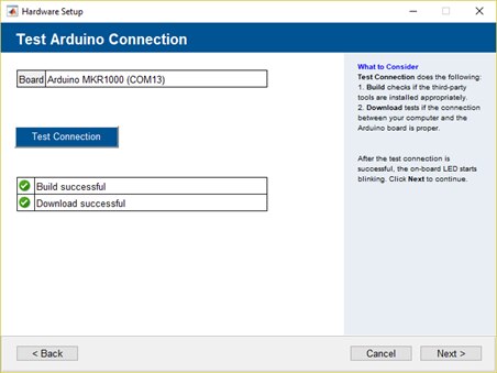

  • Thanks Madhu -  only running MATLAB on my PC, the UPLOAD SERVER Wizard still gets the same errors.
    I tried it once with normal MATLAB selection, and again once selecting MATLAB run as Admin.
    Some progress was made running MATLAB as ADMIN and making some other permission adjustments with the Windows Defender.
    MATLAB Command Window:
    >> a = arduino
    a =
      arduino with properties:
    Port: 'COM13'
    Board: 'MKR1000'
    AvailablePins: {'D0-D14', 'A0-A6'}
    Libraries: {'I2C', 'Servo', 'SPI'}
    The MATLAB Arduino Wizard fails with errors:
    C:\Users\GaryY\AppData\Local\Temp\ArduinoServer\MW\libraries\MWArduino could not be removed.
    C:\Users\GaryY\AppData\Local\Temp\ArduinoServer\MW could not be removed.
    This is a smaller error list than before.
    >> a = arduino('COM13','MKR1000','TraceOn',true)
    Updating server code on board MKR1000 (COM13). This may take a few minutes.
    C:\Users\GaryY\AppData\Local\Temp\ArduinoServer\MW\libraries could not be removed.
    The Simulink Arduino Wizard now is working to the end.
    It is import to remember to go to MATLAB Command Window and clear the connection.
    Seems maybe some firewall still blocking arduino-create-bridge.exe.
    Are there other internal programs that firewall needs to permit to work ,exchange data ?
    Thank you for all your help
    Gary

  • Greetings Madhu - I have progressed to 2.2 Matlab getting started and hit a barrier. https://create.arduino.cc/edu/courses/mod/book/view.php?id=83&chapterid=92
    1) The first point is not a stopping point, but slowed progress to investigate.
    Navigate to the "work" folder by typing the following command in MATLAB Command Window and pressing Enter.>> cd(arduinokit.workRoot)
    DOESN’T WORK My PC DIRECTORY STRUCTURE AS INSTALLED IS DIFFERENT.
    .My directory structure is c:\Users\GaryY\Documents\MATLAB    . There are no deeper folders.  I just kept moving on through the tutorial.
    2. This item was not a stopping point, but again it slowed me down to troubleshoot, and I share it for the help to other Road Testers.
    When the instructions called to Upload Arduino Server with the Motor Carrier Board, MATLAB UPLOAD SERVER Wizard error ed out the motor carrier could not be found.
    I opened the Arduino IDE 1.8.1 , and loaded the motor carrier library then this error was cleared.
    3. The item is my stopping point, need HELP :-) please to resolve.
    Upload Arduino Server errors out  with this message:
    >> clear a
    >> a=arduino
    C:\Users\GaryY\AppData\Local\Temp\ArduinoServer\MW\libraries\Wire could not be removed.
    >> carrier = addon(a, 'Arduino/MKRMotorCarrier')
    Undefined function or variable 'a'.
    >> dcm = dcmotor(carrier,3)
    Undefined function or variable 'carrier'.
    Did you mean:
    >> dcm = dcmotor(barrier,3)
    I checked the hidden directory structure C:\Users\GaryY\AppData\Local\Temp\ArduinoServer\MW\libraries\.............. All folders and directories have property set to READ ONLY. The security on them is FULL Permissions for SYSTEM, my login, and for ADMIN:.
    There is a sketch directory under MW containing some files that are deleted when the Upload Server executes. Changing the Arduino Libraries UNDER TEMP to READ ONLY is not possible while Upload Server is running.
    Any ideas how to clear this problem to MATLAB Upload Server ?   Thank you Gary
