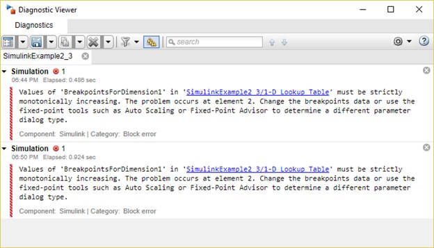

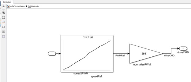

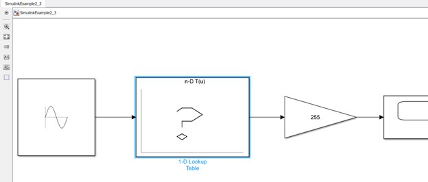

  • Madhu - sorry to drive you crazy with this observation, I've updated the contents in case someone else has this weird thing happen.
    This time

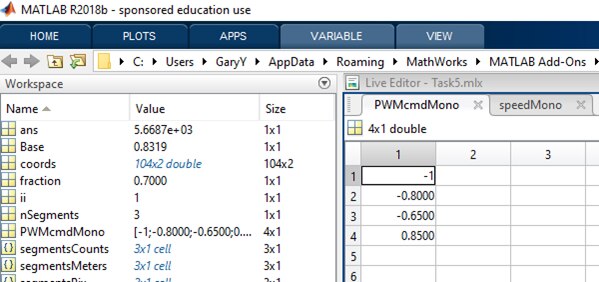

    2.3.1.3 SIMULATING A MODEL  errored while following the  example.  imageimage
    I tried modifying the curve block as the help suggested without resolve.
    I checked the VAR table data of PWMcmdMono and speedMono and the points somehow are inconsistant and are 4 X 1 array, which was strange

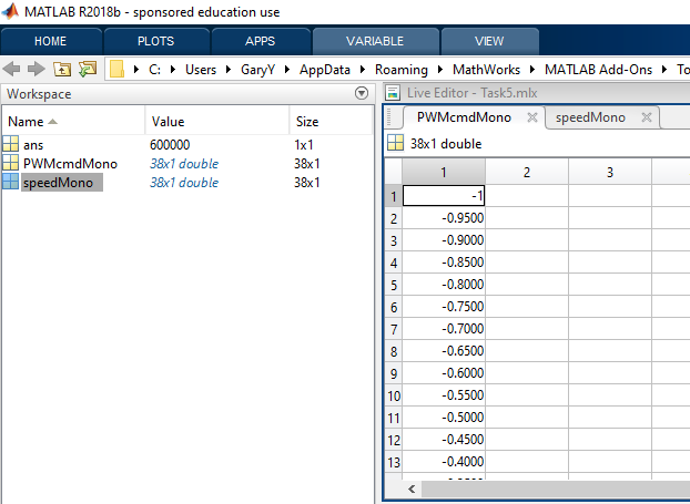

    I quit for the evening and saved my work to the Simulink model as  MyDCMotorControl., and powered down the PC.
    *** Next evening,****  PC powered up,****** and a fresh MATLAB start.
    I reopened MyDCMotorControl model, forgetting to call up the VARs in the Workspece.
    so then  I called up
    load motorResponse
    min(speedMono)
    max(speedMono)

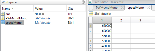

    The PWMcmdMono and speedMono are now 38x1 arrays , and the 1-D block is satisfied without error.
    I dont know why PWMcmdMono and speedMono arrays are different than yesterday,
    Anyone having this problem should close open tasks, clear out VARs, and restart app.
    Please  notice the values in speedMono are 100 times too big, therefor the gain block is not 255 for me, it is 25500 to match the Simulink Tutorial scope waveforms.
    Thanks Gary

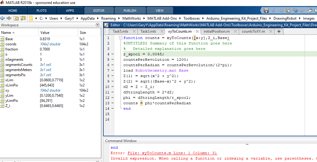

  • Thanks Madhu - Neither suggestion works into the example in TASK5 for the drawing robot.
    1) Using the first suggestion into the function xyToCounts:
    function counts = xyToCounts( [ x y ],  Z_i, Base)
    %UNTITLED2 Summary of this function goes here
    %   Detailed explanation goes here
    % Z_i = initialPosition;
    r_spool = 0.0045;
    countsPerRevolution = 1200;
    countsPerRadian = countsPerRevolution/(2*pi);
    load RobotGeometry.mat Base
    Z(1) = sqrt(x^2 + y^2);
    Z(2) = sqrt((Base-x)^2 + y^2);
    dZ = Z - Z_i;
    dStringLength = 2*dZ;
    phi = dStringLength/r_spool;
    counts = phi*countsPerRadian
    end
    provides this error:
    segmentsCounts = cell(size(segmentsMeters));
    for ii = 1:nSegments
        segmentsCounts{ii} = xyToCounts(segmentsMeters{ii},Z_i,Base);
    end
    Error: File: xyToCounts.m Line: 1 Column: 31
    Invalid expression. When calling a function or indexing a variable, use parentheses. Otherwise, check for mismatched
    delimiters.
    2) Using the second suggestion into the function xyToCounts:
    function counts = xyToCounts( xy ,  Z_i, Base)
    r_spool = 0.0045;
    dZ = Z - Z_i;
    end
    >> x = xy(:,1); y = xy(:,2);
    end
    Undefined function or variable 'x'.
    Error in xyToCounts (line 11)
    error is the same regardless if  x = xy(:,1); y = xy(:,2);   is inside function or outside the function
    Any other suggestions ? Thanks Gary
    PS My middle son got his  BS in Math a couple years ago, used MatLab alot, and didnt have any good suggestions for me   on this one :-)

  • Hi Gary,
    The online platform shows the function input to be xy which is a variable and has more lines of code. [x:y] indicates you are going from x to y in increments of 1. This is probably the cause for the error. please change your function to either  function counts = xyToCounts([x y],Z_i,Base) or function counts = xyToCounts(xy, Z_i, Base).
    If you use the second approach however remember that you need to add the following two lines of code as per the online platform instructions.
  • Hi Madhu - Could you please provide the correct code solution for creating the DRAWING ROBOT  function; Convert position to counts  in TUTORIAL 4 TASK3  line 14 ?
    Convert position to counts using a function counts = xyToCounts([x y],Z_i,Base).
    I have tried many different ways to fix my errors, got stuck, and missing some understanding of the needed syntax.
    Other functions have been followed as examples to follow, and reread the sections several times to find needed fix, no longer making progress.
    Getting this function working, will help me alot to finishing up the drawing robot tutorials, and my personal goal to use the drawing robot to draw my robot club's logo (which just coincidentally happens to use the colors black and red )
    Thanks for the help on the code for function counts = xyToCounts([x y],Z_i,Base).
