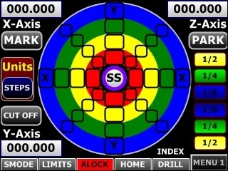

    Here is one of the CNC controller screens I had done before setting aside for this review:
    As you can see, I ran out of screen real estate using the 320x240 mikromedia TFT screen, but the display this Xplained kit came with
    also would allow for a much better GUI control interface to be made.
    The plan was for screen and joystick and push button manual controls for operator to use to make manual movements of the axis's.
    In the image shown, pressing the red "ALOCK" button would result with it turning grey like others and all of the black axis lock squares
    on the X/Y input circle disappear so full multi-axis movements for X/Y could be possible.

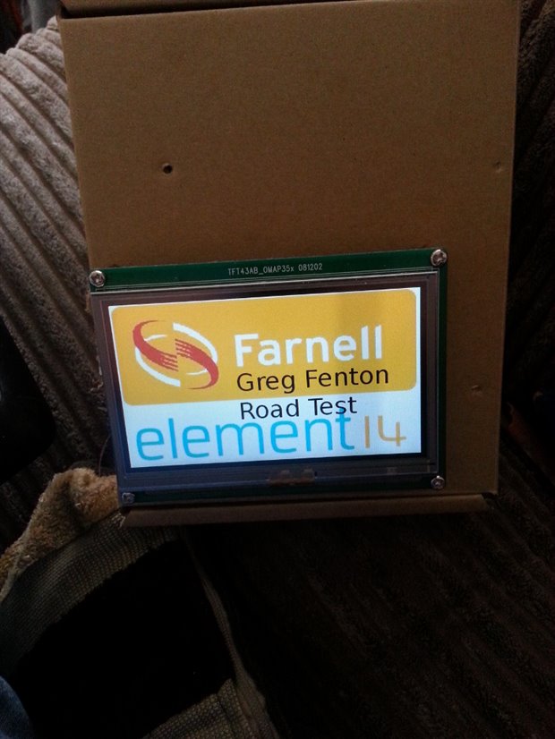

  • I currently have the device working as a picture frame with the capability of overlaying 8x8 pixel text (using a 128x128 full ASCII character bitmap which I draw over the top of the frame buffer).
    It can currently only read 24 bit .bmp files of 480x272 but I will work on other sizes, formats and look into decoding video. Ideally I want to port mplayer or VLC so I can display any image file format without lots of (unnecessary) work.
    Writing this post made me think about the linux FIFO functionality to output characters, I will look into that.
    My device automatically connects to WiFi and cabled network at boot time and displays the IP address on the LCD display.
    It also connects to my server to get the correct time, but I will knock together a script for it to connect to an NTP server and get the time from there.
    A question: does anybody know where the touch screen appears in the linux tree, if anywhere? And if not, how would one read it?

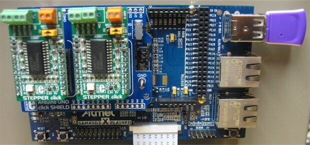

    Here is one possibility I could do coverage on using:
    2 x Stepper Clicks shown.
    Others to chose from are: DAC Click , ADC Click , GPS L10 Click , Thermo Click , 8x8 Blue LED Click.
    As you can see in that list, I already have a temperature related device (not same Click board as in the bundle), so not very enthusiastic
    to do that one again as it was one of the first ones I acquired and used, while the Steppers and DAC and GPS have been boxed up so far.

  • Nice Greg.
    I like the graphics you used for a first time display.

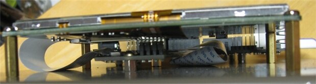

    Just got done making some HW mods and wiring for ext. power input and a few photos. As soon as I get them off the camera and find a good one, will post it.
    Image view of under TFT screen at LCD-EX mounting and the thin film cables.
    Image view of main parts mounted.
    I do have a newbie question though:  Would it be considered still within, as they say, "The spirit of the game",  to not use this particular Click board (SHT1x)
    supplied and use any other Click board from the Mfg.?
    Or two?
    I really don't have a need or usage plan for this one at this time, but do have other Click boards on hand waiting to be used
    for some intended ideas that seem to be growing cobwebs.
    Is it ok to (hopefully) present some additional or alternate possibilities to put the shield to work accommodating?

  • I just (as in the last few minutes) got the panel displaying a raw bitmap image from a cross-compiled program.
    I had to jump through a little hoop to get the file to display correctly instead of the pixel rows being bottom to top instead of top to bottom but now I have some firm footing.
    The world's most expensive picture frame lives!
    Time for some bouncy ball sprite action next methinks.
    I hope I can figure out the overlay system soon image
    Below is the code I used to put a bitmap image on the screen. I will be coding it to be able to read from a standard .bmp file shortly, and pass the filename via the command line.
    For the raw file, create a 24 bit bitmap 480x272 and strip the first 122 bytes:
    dd if=480x272x24.bmp of=f24.raw

    I just finished making and mounting everything to a scrap piece of aluminum that was a bottom to a housing I think.
    (short sided box pan and mounted parts on the outside surface so it is easy to access all edge on connections - like the programming USB connector
    and it can house batteries or low height regulated AC to DC power supply on underside. Pretty sure I have one of those laying around somewhereimage)
    Pictures will be in review of the parts being mounted in stages. One of the Xplained boards mounting holes is in a very bad location though,
    and if conductive parts are used for standoff mounting, be very careful and check that the parts (screw and standoff) do not touch
    anything on both top and bottom at that location. The problem hole is the top right one when looking at the board with LCD connector towards bottom.
    I had to put the screw that would go through that hole in a standoff and spin it in the drill press while applying a file to the side of the screw head
    and reduce its diameter a lot until it would fit between the header sockets that bracket the hole and file even more off so that it would not touch
    and short to ground the PD30 line on J19 pin socket and had to file some off of the standoff so it would not touch and short the SCL line on socket
    J20-pin 21 on the bottom of the board.
    Also had to remove the header pins from the LCD-Ex adapter board so it could be mounted on short standoffs under the LCD screen.
    The mounting holes on it are also problematic as they are too small (5/64) for standard standoff screws to fit through and required me to drill
    the holes larger. Now I have to hope that the modifications did no damage to it. I'm pretty sure that area is clear of any layered traces, but I
    could be wrong. Wish the proper standoffs for it had been included.
    I had to do a double 90 degree twist in the flat cable that goes from it to the Xplained boards LCD connection also, but it made it possible for me to
    mount the screen over the adapter and have the flat cable from the screen to the adapter easily loop back under to a straight on mating with the
    latched cable connector on the adapter.
