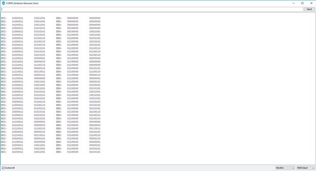

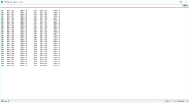

  • Hi Tom,
    all your issues sound a little strange to me. I triggered a shipment of another shield for you. It will come via Randall. The battery you mentioned should work. Since it is strong enough to deliver the starting current for the motor. Also for light bulbs you can run in problem with the power supply. When you switch on a light bulb you will get the so called inrush current (filament is still cold). This is a high current which will flow for ms until the bulb reaches its normal operating temperature.
    The TLE94112 is not in my direct product responsibility , but I had this issue with a 12 V car bulb and a 5 A power supply.  12Vx5A = 60W. I couldn't switch on the bulb (50W) because the power supply switched off because it was not able to deliver this inrush current. But later on you mention that your supply can drive the motor stand alone without the Shield switching it. This means that the supply can drive the motor. Alternating current electric motors may draw several times their normal full-load current when first energized.  The same with the inrush current for the light bulb (5 to 8 times higher than the nominal current).
    What I thought was that the inrush current drops down your supply and it will switch off or similar.. This seems to be not the case. But the voltage will drop for a short period of time which will make the multi half bridge to detect an under voltage and switch off.  Could you read out the status register SYS_DIAG_2 to SYS_DIAG_7 (see the sketch) for 5, 6, and 12V supply voltage?

  • Dear Tom,
    I approved you as a follower, now we should be able to exchange messages.
    Unfortunately, I got no sketch from Johannes, so I can't send you anything right now.
    Just a side question (could have overread it), did you also test the library for the shield?
    There is a sketch which was tested with a scope by an engineer here at Infineon and should also produce output which we can use for debugging.
    https://github.com/Infineon/DC-Motor-Control-TLE94112EL/tree/master/examples/pwm_demo
    You could run this sketch with a minimum setup (only a power supply) and we compare it directly with a board here using a similar setup.
    Or you modify this sketch and send it to us so that we reproduce the test. If there are differences, we could directly see it and compare it.
    Just a suggestion from my side.

  • Manuel and Johannes,
    I have written a sketch for testing my shield as per Johannes' instructions above.  I will run the test tomorrow as it is getting late now.  I will use different motors, power supplies, etc. and will document data, Serial Print screen captures etc. and list them here.  Excuse my lack of looping to make the sketch shorter but it is getting late and my brain is short-circuiting....lol...for now you can find it here if you want to take a look at it:  https://github.com/gl1der1/Infineon-Motor-Shield-RoadTest
    Thanks and Happy Holiday!

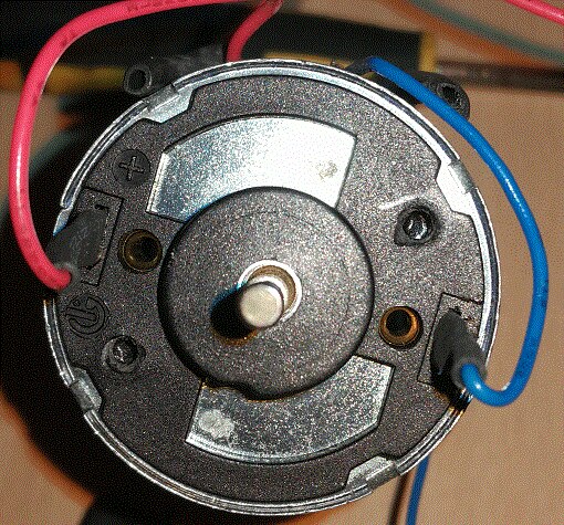

  • Hi Gerald!
    Thanks!  It has a similar appearance to the brushless motors we often use for electric remote control airplanes.  Since the cooling fan is brushless and it seems to work fine with the motor shield, I was asking because I am thinking about a possible application for remote control vehicles that use brushless motors.  As soon as I can ascertain a good working Shield, I think I will test it as well on these brushless motors to see how it behaves.  Thanks for the info and the great images!
    Tom

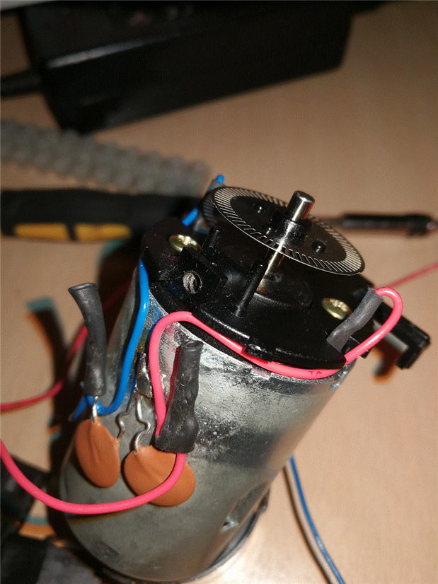

  • Hi
    Gerald, it would appear in your above post that at least one of your motors (the 12V Xinrulilian cooling fan) is a BRUSHLESS motor fan (I'm not sure about the other motor in the vise, but based on my experience with the Remote Control Electrical Airplane hobby), that motor appears to be BRUSHLESS also.  However, Infineon's User Manual for the DC Motor Control Shield with TLE94112EL for Arduino, Page 4, Section 1.2 Key Features  says "The DC Motor Control Shield has the following features:....... BRUSHED DC Motor Control up to .9A peak".....I made sure my test motors are BRUSHED----does using BRUSHLESS motors make a difference?
    The first motor i use is a permanent magnetic DC motor. -> also, brushed DC motor.
    In the application i use this motor as servo for moving mechanics.
    Best Regards,
    Gerald

  • Thanks Johannes.  Although I haven't had time to implement the tests you have suggested due to personal obligations, I intend to very shortly.  However, in the interim, I have a created a video of my current set-up for testing the Infineon Sample Sketch that I keep referencing, demonstrating the odd, erratic behavior I am getting at the unusual voltages (such as what appears to be the "best" behavior/reaction of the motors/shield to a supply voltage below the specified 5.5V lower limit).  I have dubbed narration for the sake of explanation; the video was a quick "put together" so excuse any mistakes please.  Also, in addition to this video, I have screen captures of a few Serial Monitor prints for different photos I will add to this or immediately following.  All tests (different voltages) were conducted by first turning on the USB cable to the Arduino, allowing a few seconds for the Arduino to boot up, then turning on the power supply and the voltages seen in the video.  After each run, the power was shut off and the USB was disconnected for at least a minute to allow plenty of time for everything to "Clear and reset."  I have other Sketches that I have written myself to test just single motor operation and other conditions but I have not included any of those.  The video can be viewed here or on Youtube at
    https://youtu.be/E621GOe_LHM
    5.1V Serial Print Out of SDI: and SDO;'s (See the remarks in Infineon's sample sketch for Arduino for further explanation).  Each Serial Monitor recording was initiated right after start up for that voltage setting.
    5.5V Serial Print Out
    6V Serial Print Out

  • I'm confused, and I do apologize to all if it is do to my lack of Electrical Engineering knowledge (I'm a longtime hobbyist, not an Electrical Engineer).  However I do have some questions (I am not criticizing anyone at all so please do not misunderstand my questions; I am genuinely seeking knowledge).
    Also, the referenced Motor Shield PDF says under "Scope and purpose" that "It should be used in conjunction with the TLE94112EL Datasheet."  The TLE94112EL Datahseet pdf, Page 23, Section 5 General Description, Subsection 5.1 Power Supply says in the last paragraph, "An electrolytic and 100nF ceramic capacitors are recommended to be placed as close as possible to the Vs supply pin of the device for improved EMC performance in the high and low frequency band.  The electrolytic capacitor must be dimensioned to prevent the VS voltage from exceeding the absolute maximum rating.  In addition, decoupling capacitors are recommended on the Vdd supply pin."  Referencing back to the Motor Shield User Manual, Section 2.4 Bill of Material of the DC Motor Shield Lists C1, C2, C3 Kemet 100n/50v cpacitors and C4 a Panasonic 47uF/50Capacitor (eletrcolytic).  According to the schematic and the illustrations in that manual, it appears to me that that is what C1-C4 are present on the shield for (improved EMC performance).  In addition, Figure 14 Motor Control Shield connectors shows how the motors should be connected to the shield outputs for use with the example Arduino sketch.  Although this is not exactly a "Schematic" it does NOT show any additional capacitors connected to the Motors for the purpose of EMC filtration.  Finally, the shield manual says on page 13, Section 3.1 Key Features of the TLE94112EL "Optimized EMC behavior".
    To summarize, because of those refernces I am NOT using BRUSHLESS motors or any additional capacitors for EMC filtration which appears to be the case in your video/photograph above.  Does this make a difference?   Should I be using the capacitors or BRUSHLESS  motors instead?
  • Hi
    6. I have placed multiple Multimeters while attempting to run the motors to monitor Amperage and Voltage. I have tried using the "Maximum" setting on the multimeters monitoring Amperage and no single motor has ever gone over 0.700 Amps (this includes start-up and stall conditions). Voltage range is consistent as far as the fact that the Shield will only turn the motors at the voltage ranges specified (between about 5.1 and 6.2 Volts).regardless of the motor type or power supply used. (For example, when using the 12V lead-acid battery, nothing happens-- using 4 "D" cells (1.5V x 4 =6V) I get the proper response, (although if the particular motor being used is rated for higher parameters, it of course, does not produce the proper rated RPM or Torque).
    As I mentioned here https://www.element14.com/community/roadTests/1760/l/infineon-dc-motor-shield-w-tle94112el-for-arduino#start=50 ; I work with two motors at 12V_DC.
    This motor drives with 0.07A without load, total blocking current: 0.8 to 1.1A max; at 12V_DC.
    The two capacitors on the motor is for EMC. - see application manual.
    The second motor, drives with 12V_DC about 0.11A nom.
