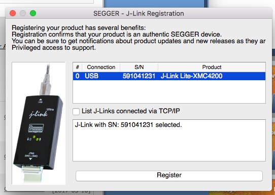

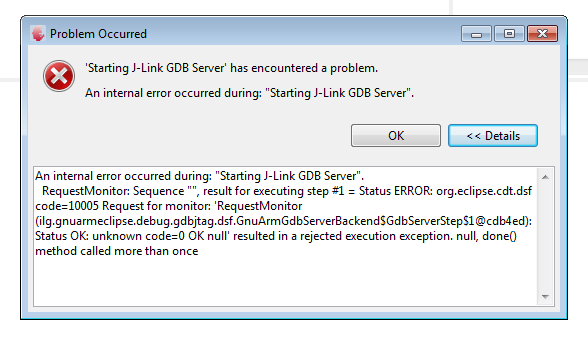

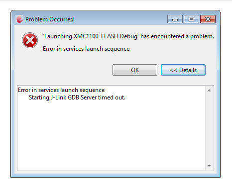

  • Opened a TAC case on Infineon (after registration) just now. I have submitted the same text and attached images as in the post above describing the issue. It's 21.00 p.m. here in Spain.
    I'll keep you update of the further response(s) by Infineon tech support.
    Enrico
  • One of the great points of these Roadtests is the whole user experience.
    You're comments will hopefully be fed back to someone in a suitable position to rectify future responses.
  • Hello Thomas.
    Thank you for your detailed reply. Me too I had the suspect reading the other users issues and problems that the board is far to be perfect. My persk al impression about the "Arduino" compatibility is just some last minute add-on to make commercially more attractive the board.
    It is interesting the CPU of this hardware, faster and morw complete, and the board has a good design in my opinion but the production result is almost a delusion.
    I wlll try to ask the support too just to see what happens, then I will post on thia thread. We are not just making a roadtest here but I think very useful these opinions exchange just to acquire a good evaluation of the product that it is not knky hardware and software but as you say it is also all relate the company approach to the customers.
    When testing the unknown there is always the doubt that we are doing the things wrong or we have not understood well the documebtation. This does not seems me this case image
    I agree with you that with the information we have in mind it is not the worth to spend more time debugging the 1100 board, better to concentrate on the shield that instead seems very well working on native Arduino.
    The only thing that I feel better than Arduino was the DAVE IDE based on Eclipse; easier to install and maintain than the coeresponding AVR Studio (Visual C based image) with a lot of libraries,  documentation and valuable material and examples.
    I hope that @racansy can give us a faster support (maybe a board replacement) but it is a good idea to follow the official Infineon support channels to see what the common customer will face on. All this is part of the roadtest, unfortunately.

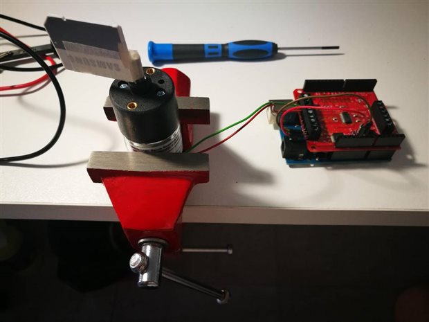

  • Hi   is possible I've been trapped in another hardware issue ? I have started managing the motor control shield and the XMC1100. Something seems ok something not. I have tested the DC motor controller board and it worked fine, just with the motor example provided by Infineon, on an Arduino UNO board. The image below shows the simple test I have done
    (there is also a very short video of the motor moving here: https://youtu.be/FK6u0Kf5HLc )

    On Mac, accordingly with the Infineon documentation I have also insalled the JTag drivers pack for the board programming through the virtual serial exposed to the computer through the JTag. To double check that the JTag package was installed correctly on the Mac machine I have also registered the board to SEGGER and the JTag registration package shown me the expected presence of the XMC board JTag as shown in the image below.
    On the Windows machine instead I have installed the DAVE development environment from Infineon so no need to install the JTag drivers.

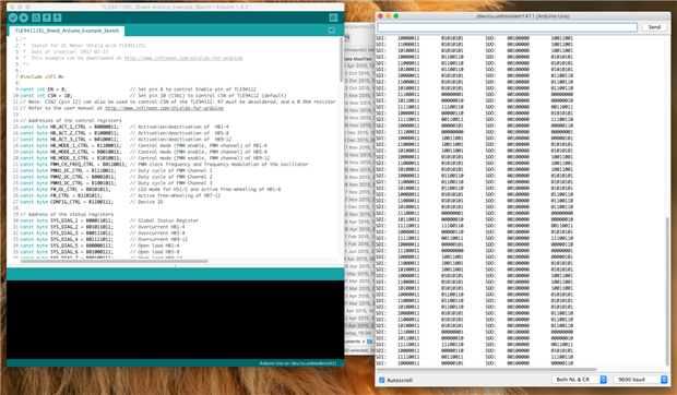

    Mac behavior
    When I connect the board on the Mac to the Arduino IDE via USB its serial connection is recognised and I start compiling (always the same motor controller example sketch. But when the IDE tries to flash I get a message that the selected serial port does not exists. Weird!

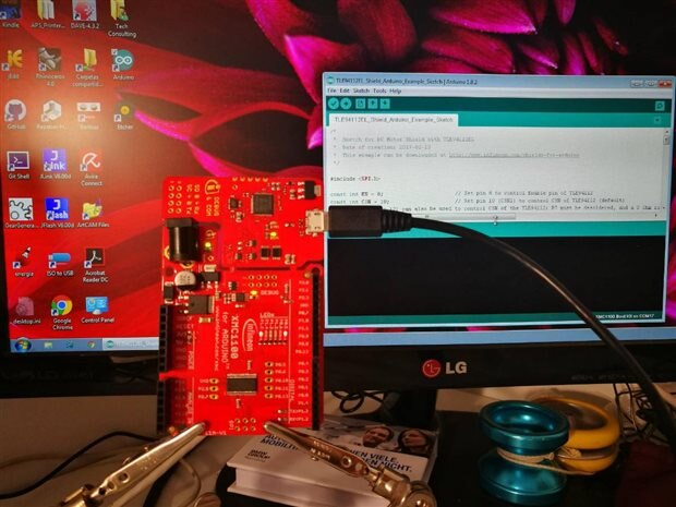

    Windows behavior
    On Windows as I connect the board it is recognised through a serial connection and I can compile and upload the sketch with the following exceptions
    1. The LED COM on the JTag flasher is always off while I expect blinking during the programming phase.
    2. The upload process (after the compilation) is super slow, it needs about 2 minutes to compile the uploading process while on the same machine the same sketch needs just few seconds (it occupy about 8% of the Arduino memory space)
    3. When I receive the upload complete the board continue to do nothing related to what expected in the sketch
    4. The Arduino IDE serial monitor always shows random characters from the board. Non-ASCII characters.
    I have checked the communication speed (9600), the cabling (tried with different cables) and the board integrity.
    The image below shows the state of the board also when a sketch is uploading or when it is expected some kind of activity.
    The image below shows what should be expected on the serial monitor while the DC motor controller shield is running (from Arduino with the shield)
