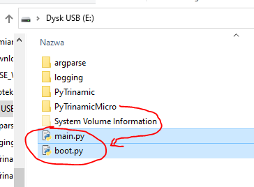

The driver
TMCM-0960  board driver installation sequence.
After inserting to the USB port it was quickly recognized as PYBFLASH.
The board is also available as the storage device (of very small capacity, less 100MB in fact), the possibility of extending the space using an SD card is very convenient.
But we need to remember that native storage will be inaccessible when using the SD.
Unfortunately I realized soon that my system recognized the drivers improperly.
It was inaccessible in the clients terminal shell.
First I tried to reinstall drivers
But then I discovered that the driver signing issue arose
the driver is not digitally signed
Since the driver is not digitally signed, Windows may prevent you completely from
proceeding with the installation.
I had to go to the test mode to install Unsigned Drivers in Windows 10
https://www.maketecheasier.com/install-unsigned-drivers-windows10/
Base contents of the board storage folder
README.txt
This is a MicroPython board
You can get started right away by writing your Python code in 'main.py'.
For a serial prompt:
 - Windows: you need to go to 'Device manager', right click on the unknown device,
   then update the driver software, using the 'pybcdc.inf' file found on this drive.
   Then use a terminal program like Hyperterminal or putty.
 - Mac OS X: use the command: screen /dev/tty.usbmodem*
 - Linux: use the command: screen /dev/ttyACM0
Please visit http://micropython.org/help/ for further help.

successful installation of the py on the board (SD card):
py install.py E:\
On the boards SD card I have now:
I moved the main.py and boot.py scripts out of PyTrinamicMicro/platforms/motionpy1
to the root
