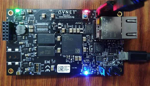

Some photos of the MicroZed powered up and attached with the carrier card:

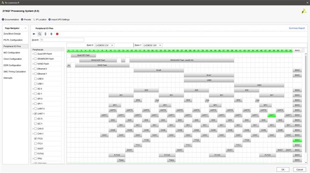

One important point to note here is that the PS-Pmod is directly connected to the Processing System of the Zynq, thus it can be accessed only inside the processing system and cannot be accessed by the programmable logic.
To interface the Pmod LCD, first, we need to look at the MIO connections. It is not necessary to add any extra module to the block design because when the block automation is done for Zynq, the Fixed IOs connect the MIOs to the onboard components.
The mappings of the MicroZed MicroHeaders and the PS-Pmod are given below.

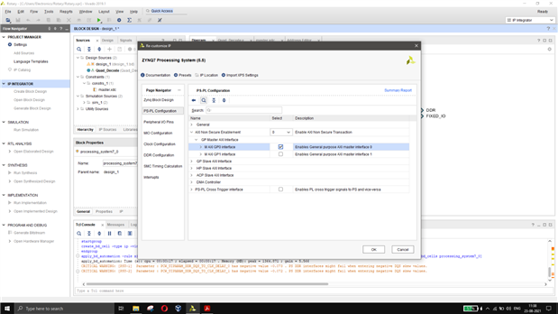

Now that we know the mappings, we need to think about the logic required to interface the LCD. Given below is the excel sheet which explains the logic.
Configure the Zynq according to your requirements and disable unused peripherals.
{gallery} Zynq
Disable unused peripherals

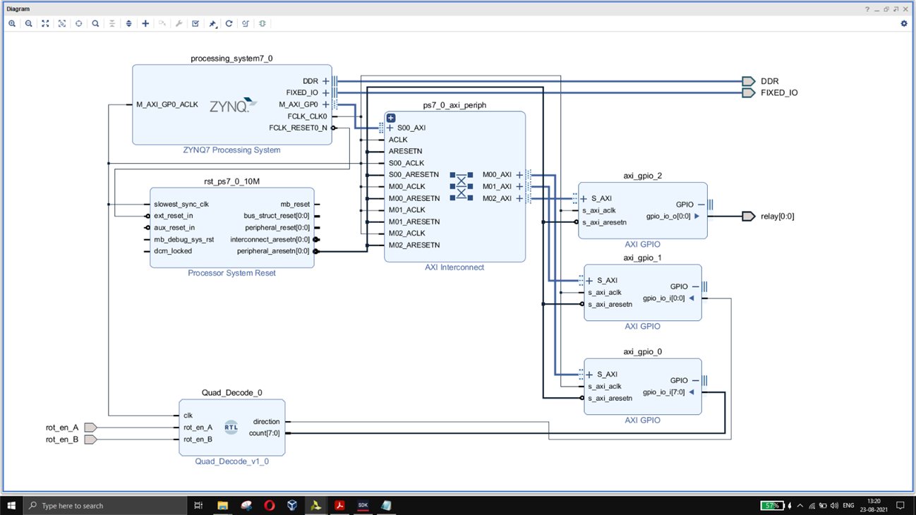

2.4 PL-Pmod - Programmable Logic Pmod:
The PL-Pmod can be used both with the processing system and the programmable logic. In this section, I'll be adding a Quadrature Decoder Hardware module to the Programmable Logic of the Zynq.
Also, we need to use the AXI GPIO to interface between the programmable logic and the processing system.
Given below is a custom-made rotary encoder Pmod which is used for the PL-Pmod.
{gallery} PL-Pmod
Verilog Code for Quadrature Decoder
Add the Zynq IP
Run Block Automation

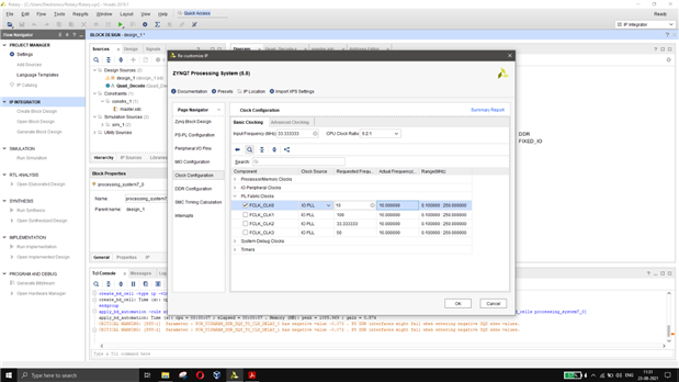

Configure AXI Master
Configure PL fabric Clock for Quadrature Decoder
Add the Quadrature Decoder Module and AXI GPIO and give connections
Make External
Completed block diagram
Constraints File
The changes in code for the above-mentioned project is given below:

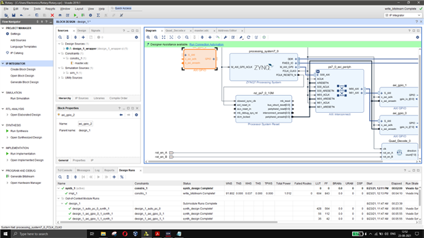

Add an AXI GPIO to the block Design
Only one-bit output for Relay (I'm using a single relay module)
Run Connection Automation
Update Constraints file
Completed Block Design:
