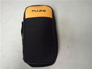

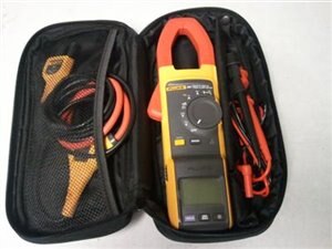

Right out of the box I was impressed with the solid build quality and the nice carrying case with compartments for the test probes and the iFlex current probe.

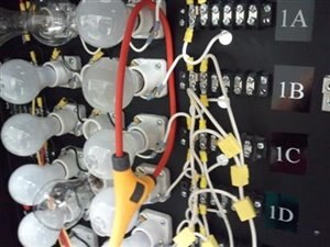

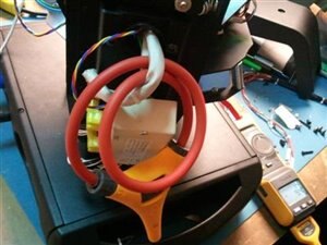

I decided to give the iFlex probe a try.  Here are a couple of examples.  The first photo shows how one could measure the total current in multiple load strings where a clamp-on would not be practical.  The other shot is an example of running the probe through a tight bundle of wires and using two loops to be able to scale the current up where the load is fairly light.  This happens to be a 400W HID lamp with about 5 Amps of current being driven by a high frequency ballast.

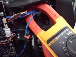

With LED products, measurement of DC current is also common.  Here, I am looking at the DC feeds to some LED modules in a moving light fixture.  The boss won't let me reveal the actual current but it is a lot higher than you might expect.  (Did I say "high power LEDs?")  If you look at my element14 Avatar you might get a better idea what I'm talking about.

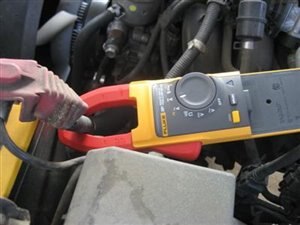

Although Fluke probably did not target the automotive industry with this product, I did try some tests measuring DC current on my Toyota Tacoma pickup truck.  Here you can se a remote measurement of the starting current.  I can see this as a valuable tool for testing and trouble shooting DC currents as well as AC.
