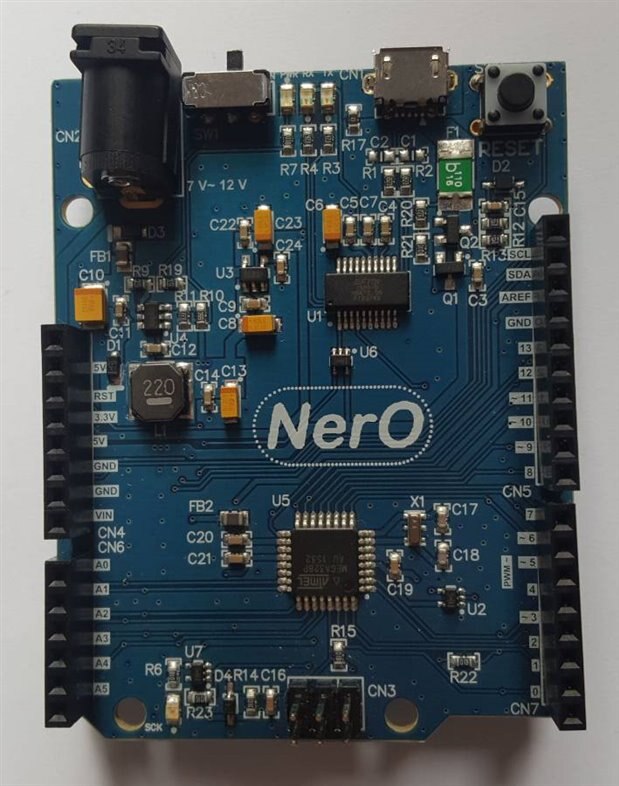

Nero

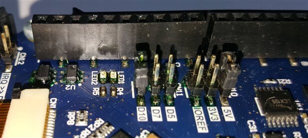

To start with the Nero: this is a pretty looking board, with a well designed PCB layout. It's equipped with long headers that can be used to attach the Cleo on one side, while still having access to the standard Arduino headers on the other. In a configuration like this, one has to keep in mind that not all pins can be used for other purposes: four digital pins are claimed by the Cleo. As well as the SPI pins, which of course could also be used as digital pins without the Cleo on top. I couldn’t help noticing that the soldering of the headers could have been cleaner: there where little blobs of solder on top of the pins, as we can see in figure. It also must be said that the layout of the board looks good, that quality components have been good and that the smd soldering is straight and solid.

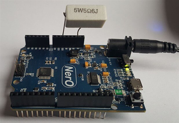

The main feature of the Nero is the onboard buck converter, which can source up to 1A  by 5Volts, without  overheating. A normal Arduino is usually equipped with a lineair voltage regulator (ldo). They are cheap and will conveniently convert the voltage of the source, to the desired voltage. For an Arduino is that 3.3Volt or 5Volt. This conversion, however, is far from efficient. If we convert 12Volts into 5 Volts with an ldo, in an application that uses 1A, that would mean 5*1 = 5 Watts are consumed by the application. But the remainder, 7*1 = 7 Watts will be converted into heat. In other words: far over 50% of the battery capacity will be wasted. And since the wasted energy is fully converted into heat, we quickly run into heat problems if we try to source too much power from and ldo.
This is where the buck converter comes in. For this review, it’s sufficient to say that buck converter uses a switching circuit, in combination with an inductor and a few capacitors to reduce the voltage to a lower level, without wasting so much of the energy as an ldo does. The result is that we can source more power from the buck converter, without wasting battery capacity and running into heat problems. I decided to put it to the test right away and placed a 5.7 ohm resistor between the 5V output and GND. This will result in a current of almost 0.9A and a power dissipation in the resistor of 4.4 Watt. As we can see on the photo, that is way too much energy for a simple 0.25 Watt resistor. It started smoking first and then glowed up red. Just keep in mind, that an LDO converting 12 volts to 5 volts would dissipate even more energy! I repeated the same trick with a ceramic resistor of 5.6 ohm. That one did survive and I let it sit there for a while. Although the resistor heated up to the point where it became unpleasant to touch it, the board itself remained cool. So I think it’s safe to assume the claims of FTDI are true: we can source at least up to 1A from this board.
All in all the Nero is a nice board. A critical note is the MCU of choice: the Atmega328. Of course, it makes the board conveniently Arduino Uno compatible, but the 328 has it limitations. Especially combination with the Cleo, that will use both the SPI and a couple of digital pins as resources. However, that should not be a reason not to buy the Nero, when in need of an Arduino with a proper power supply. I am happy to have in in my collection now. And the price for the device is more than reasonable: a little over 21 euros at Farnell. Including VAT that comes down to about 25 euros in The Netherlands. That makes the Nero a very affordable Arduino clone, manufactured with quality by a respectable company.
