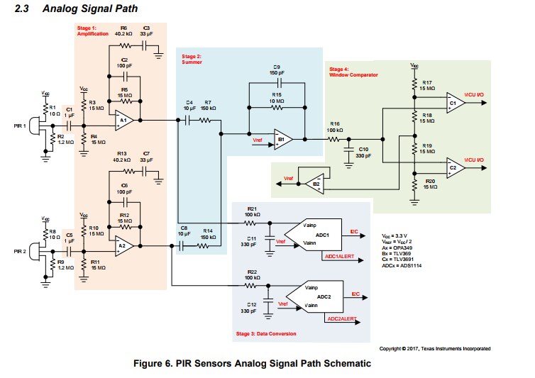

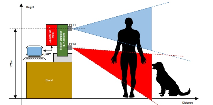

The analog signal path is really the meat of this design. The data from the 2 PIR sensors is condtioned and split to follow 2 parallel paths, one path to generate interrupts when there is a motion event, the other to capture the data in a digital format for analysis. The PIR sensors are arranged on the board and fitted with fresnel lenses optimized for receiving IR energy in a manner that is helpful for detecting motion in 2 different pathways. A high path and a low path. In this manner you can determine additional characteristics about the subject of the motion event.
The above diagram is directly from the documentation for the board. The analog signal path is broken down into 4 stages.
1) Amplification
2) Summer
3) Data conversion
4) Window comparator
Amplification:
PIR sensors typically output very small AC signals, in order to be useful the the amplitude of the signal have to be increased. This is the function of the amplification circuit.
Summer:
This section of the design combines the two signals from the PIR sensors and conditions them for the Window comparator.
Window comparator:
This part of the circuit is intended to take the output of the summer and generate interrupts to be processed by the microcontroller. This part of the design that I found to be unstable. The interrupt lines were in constant flux, which I discuss later,  they were not usable as interrupts.
Data Conversion:
OK. This is the fun part, the PIR signals travel a parallel path into the A/D converters at the same time they go to the summer stage. There are 2 14 bit A/D converters on this board, each set to separate I2C addresses to allow the microcontroller to access them separately. There are interrupt lines available to alert the microcontroller when a conversion has been completed, but I found them unecessary as I was capturing a set number of samples over a distinct period of time so it was adequate for me to simply poll the A/D converters and grab the last successful conversion result.
In addition to the analog signal path described above there are also a few other components mounted on the board to aid in the process of detecting false triggers. There is also an HDC1010 Temperature and Humidity sensor. Rapid changes in ambient temperature can be interpreted as motion in an IR sensor, this device is available to allow you to monitor the condition of the environment the board is deployed in and gives you one more piece of data to use when making the determination as to whether you have detected a valid motion event. Also an OPT3002 light sensor. Rapid variations in lighting can also trigger a motion event, so again, more data, better decisions.
