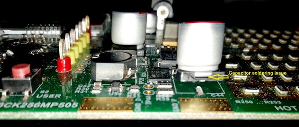

After the initial testing, I decided to observe the output voltage on a DSO. I used R&S RTM3004 to observe the output.
To my surprise I noticed that the boost output RMS voltage is changing from 15 V to 13.25 Volt when load is varied. It is also observed that the output voltage display is not clean. The oscilloscope displays are as shown in figure 2.
  Figure 2a: Noise in the boost O/P Voltage
Figure 2b Noise: zoomed time scale
I
I compared the noise level of the Boost voltage output with the buck voltage output and confirmed the noise level is acceptable for buck but not for Boost output.
On close examination of the PCB, I found what was wrong: the electrolytic capacitor C44 soldering was imperfect. There was a dry solder, and the capacitor was hanging on one leg! See figure 3.
Figure 3: Dry soldering in the capacitor lead
Tested the board again after re soldering the capacitor.  This time everything went on well. The output is very clean and stable even on full load.

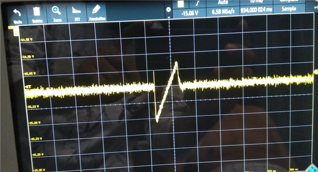

The 3.3 V output is found rock stable from no load to full load.  For the Boost output, it is found that, while switching from full load the no load, Output voltage produced a glitch as shown in the figure 4.
Figure 4. Glitch in the output when load switched off.
