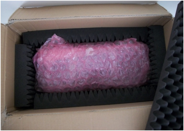

Then I opened the package. The oscilloscope was well packed in bubble wrap and surrounded by a layer of protective foam:
Here is what I found inside the box: The oscilloscope, power cable, four analog probes packed in separate bags, two digital logic analyzer probes with connectors, and various documents with useful information about this product.

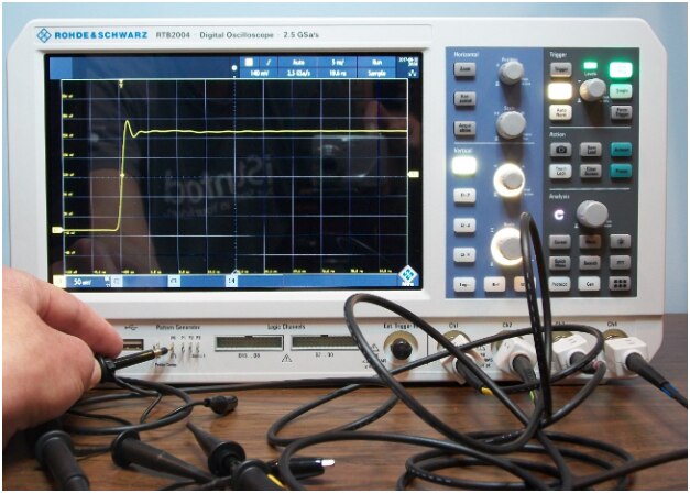

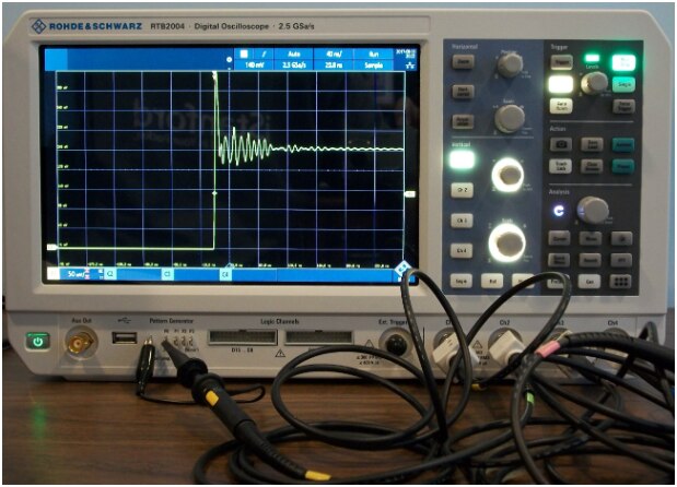

First step after power up was to calibrate the probe compensation using the small screwdriver included in the probes kit and following the instructions document that came in the probe bag. Each probe has three compensation trimmers, one for low frequency compensation mounted on the hand-piece and two for high frequency compensation mounted on the connector:
I followed the instructions in the probe manual, and I connected the probe to the 1kHz square wave output on the oscilloscope front panel. I then adjusted the oscilloscope settings to display the 1kHz square wave signal, and I continued with compensating the low frequency trimmer, T1, on the hand piece. Following that I compensated the high frequency trimmers, T2 and T3. Here is a picture of the channel 1 probe connected to the 1kHz signal generator:
This connection worked well for the low frequency compensation; however, when I tried to do the high frequency compensation the loop inductance of the ground introduced significant ringing in the waveform, so much that it was impossible to see when the top and bottom edges are horizontal. Here is a picture of the waveform with ringing:
And when magnifying the horizontal time base to 5ns/div as in the instructions manual The waveform looked like this:
I then tried to understand what causes this ringing and I discovered that as I play with the probe ground wire the ringing changes. Thus, I started to suspect the loop inductance of the ground probe as the source of this ringing. To validate my assumption I removed the ground wire from the probe and I connected the probe directly to the pulse generator pins by touching the center signal pin of the probe to the generator output pin and the probe shield/ground directly to the generator ground.
Here is a short video that shows how I adjusted the low frequency (LF) and high frequency (HF) probe compensation trimmers for one of the probes:
I then continued with compensating the other three probes the same way I compensated the one for channel 1.

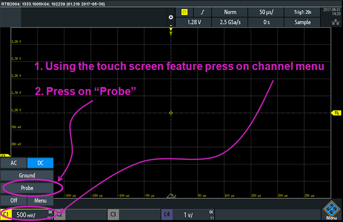

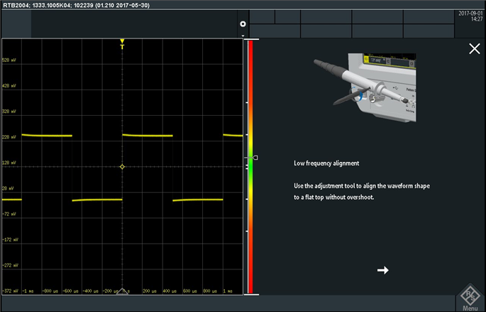

First I wanted to follow up on a comment I received for part 1 of this blog series from Rick, who has pointed out that there is a built-in wizard that helps the probes compensation.  So I wanted to explore this feature of the Rohde & Schwarz RTB2004 oscilloscope. I have accessed the probe compensation from the channel menu:
Then the probe settings menu opened.  On this menu I then pressed on "Probe Adjust" selection:
and then the probe compensation menu showed up.  I was impressed of the detailed explanations with drawings of how to hold the probe on the pulse generator pins so that the ground part at the tip of the probe touches the ground pin and the tip of the probe touches the signal pin:
On this screen I selected "Channel 1" probe for compensation, and this took me to the next screen for low frequency probe compensation:
I like the drawing that shows how to insert the adjustment tool into the probe and how to rotate it to perform the compensation.  These are very clear instructions and I think very beneficial especially to beginners and students.  After completing the low frequency alignment I pressed on the "Next" arrow, which took me to the high frequency compensation screen:
Here I followed the instructions until I completed the probe compensation.

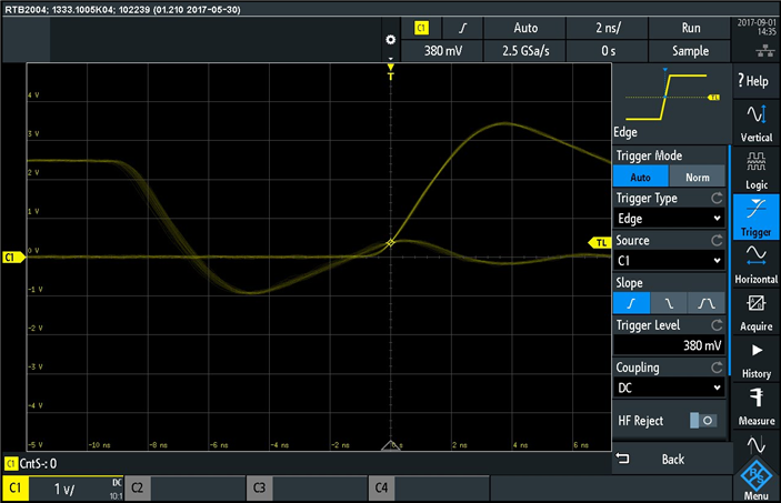

So let's look at the trigger menu of the Rohde & Schwarz RTB2004 oscilloscope:
Let's see now what happens when we change the trigger level (from 1.28V shown in the above picture).  Before we look at this I wanted to magnify the x-axis and see more details about the rising edge of the waveform:
Notice that I also changed the trigger edge from "falling edge" to "rising edge", as shown in the "Slope" section of the trigger menu.  In this example I have lowered the trigger level from 1.28V to 460mV.  The waveform "shifts" on the horizontal axis so that the trigger point is always in the center of the x-axis of the screen.  I then continued to lower the trigger level until the displayed waveform became unstable:
Notice there are two waveforms overlapping on the screen above. This happened at 380mV trigger level, so let's understand why this happens by looking at the picture below:
This is why we have two overlapped waveforms, one is triggered on the rising edge and the second is triggered on the ringing of the falling edge.

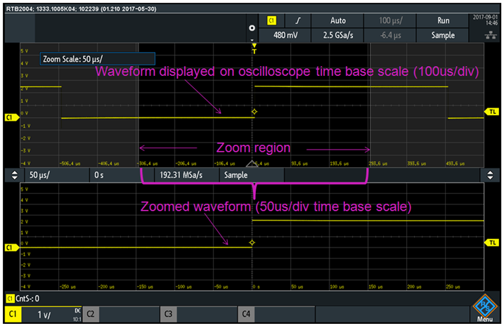

We can magnify the x-axis by adjusting the time base (time unit / division) or we can use the "Zoom" built-in function of the Rohde & Schwarz RTB2004 oscilloscope.  I like the zoom function because I can keep the time base unchanged, thus displaying multiple rising and falling edges and I can use the "Zoom" function to see the details of each edge.  Here is an example of using the zoom function:
Notice the zoomed waveform is shown on 50 us/div while the oscilloscope is setup to 100us/div.  The zoom window can be magnified by touch screen "dragging" the zoom region edges closer to each other.  My experiment continued with gradually increasing the zoom magnification:
So the steps shown above helped me zoom and see the details of the rising edge in the center of the screen.  Following similar steps I was able to see the details of the falling edge on the right side of the screen:
The highlighted region on the top waveform shows the zoom window, and the trace at the bottom represents a magnified view of the top trace in the zoom region.

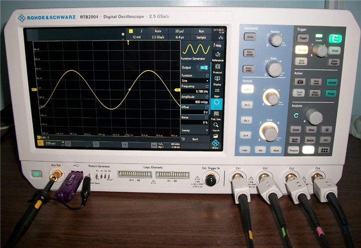

so I connected channel 1 probe to the "Aux Out" output f the oscilloscope and I then accessed the function generator menu from the main menu selection on the right side of the screen:
I like the touch-screen keypad for entering the numeric values for frequency, amplitude, offset, and noise.  Going now back to the math function, I first setup an addition between the sinusoidal and square wave signals displayed on channel 1 and 2:
The sum of sinusoidal and square wave traces is represented by the blue trace.  Next I setup a subtraction ch1 - ch2 (sinusoidal waveform minus square wave waveform):

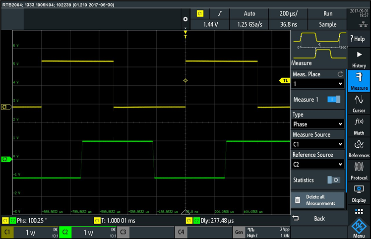

In this experiment I setup channel 1 to measure the probe compensation generator signal on the front panel and channel 2 to measure a square wave signal produced by the built-in function generator.  With this setup I then used the built-in waveform measurements to measure the delay between these two signals and the phase difference, as shown in the screenshot below:
Notice the delay between these two signals is 277.48us (as shown at the bottom of the screen).  This delay is related to the phase difference measured and displayed also at the bottom of the screen.  The relationship involves the period of the signal.  A full period represents 360 degrees phase, so the measured 277.48us represents 277.48us / 1000us = 0.27748 of the period (1000us is the period of these signals as displayed at the bottom of the screen).  Now we can find the phase difference by multiplying 0.27748 by 360 degrees, which gives us 99.89 degrees. The oscilloscope measures 100.25 degrees phase difference, which is close to what we have calculated.

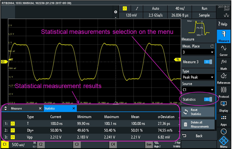

Another type of measurements built-in the Rohde & Schwarz RTB2004 oscilloscope are statistical measurements.  To evaluate statistical measurements I setup a 10MHz square  wave signal generated by the built in function generator.  I intentionally used the ground clip of the probe instead of a coaxial connector to create some loop inductance and see a little overshoot and ringing on this waveform (see lab setup in one of the pictures above).
On this waveform I measured the period, duty cycle, and peak to peak voltage.  These measurements are shown at the bottom of the screen.  Next I activated the statistical measurements by pressing the "Statistics" selection of the measurement menu, as we can see in the picture below:
The statistical measurement values are displayed at the bottom of the screen in a table.  For each measurement type we see the current measurement in the sequence of continuous measurments, the minimum value that has been measured, the maximum value, the mean value, and the standard deviation.  Notice the standard deviation is very small compared with the mean value.  This is typical for "clean" signals, but let's see what happens with noisy signals.  The Rohde & Schwarz RTB2004 oscilloscope has a feature to inject noise in the signal generator output, which I find very beneficial for lab experiments and circuit characterization.  So I added some noise on the square wave signal, using the noise selection in the measurement menu, as shown in the screenshot below:
Noise injection is entered as percentage using a numerical keypad displayed on the screen and activated when touching the "Noise" selection on the function generator menu. I started by adding 10% noise:
Notice the standard deviation has increased, meaning that the sequence of continuous measurements capture different values of period, duty cycle, and peak-to-peak voltages every time they sample the signal (due to the added noise).  The waveform looks a little "fuzzy" due to the added noise.  Let's add more noise and see what happens:
So I increased the noise to 25%, and we can see the displayed waveform is fuzzier than before and the standard deviation has increased.  Minimum value has decreased and maximum value has increased.  Let's increase even more the noise.  Here is the waveform and measurements for 50% added noise:
and here is the waveform and measurements with 100% added noise:

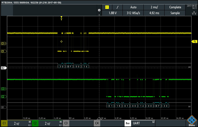

Next I built an experiment to evaluate the serial protocol analysis function.  In this experiment I used one of my projects that has an UART serial interface between a computer and an FPGA board.  The measurement setup is shown in the picture below:
  Channel 1 was connected to the TX line and channel 2 to the RX line (of the computer side of the UART interface).  This is 3.3V UART bus so I setup the trigger levels somewhere in the middle of the swing.  The serial protocol analysis function can be activated from the on-screen menu.  On this menu I selected "UART" type interface, as shown in the figure below:
Next I needed to configure the UART parameters to match the settings I have in my FPGA project.  Rohde & Schwarz RTB2004 oscilloscope has a very clear graphical menu for configuring the serial bus parameters, as we can see in the following screenshot:
The trigger function was set to trigger on the TX start bit. With these settings I started to send data through the serial interface from computer to FPGA and back.  Here is a screenshot of the captured data packet:
The yellow trace shows the TX line and the green trace shows the RX line.  Below each waveform we see the values of the sent data in HEX format (30 BF 00 14).  This is an instruction sent to the FPGA.  The FPGA responds immediately in this case with values (E1 16 01 00) followed by a copy of what it has received from the computer (14 00 BF 30) which is a “reversed order” version of the TX line data.

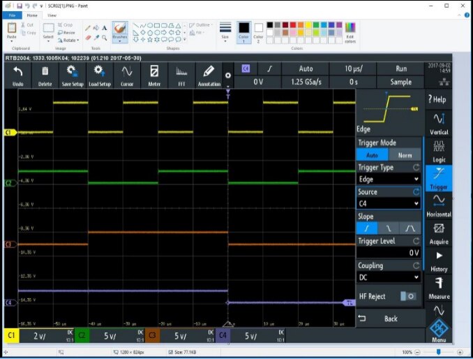

I started with selecting the 4-bit binary counter pattern and connecting the four channels of the oscilloscopes to each of the pattern generator pins.  Here is a screenshot of the 4-bit binary counter pattern displayed on the RTB2004 screen:
Channel 4 shows the MSB and channel 1 the LSB of this 4-bit binary word.  The pattern generator menu displays a drawing of this pattern.  The counting direction can be changed from the "Direction" menu field.
