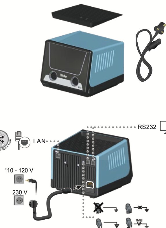

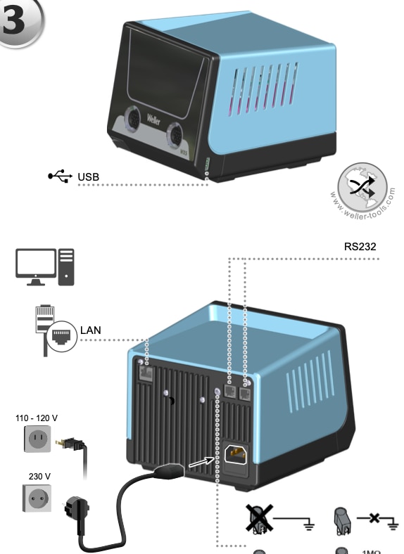

The documentation is a bit sparse, The manuals does not have many text, but mainly contains pictograms on how to connect peripherals, or how to control the menu structure on the touch screen. Weller also provided instruction Videos on YouTube ( https://www.youtube.com/playlist?list=PLsRp37s1aIpg3VjBjPUOHItg1fYkRPoju).
As an example, it took me some time before I found out that the unit is equipped with an USB port. On page 3 of the official hardware manual (https://media-weller.de/weller/data/OI/WEL_WXsmart_Station_Manual.pdf) where ports and connections are shown, the USB port is not mentioned at all. The WXsmart_Menu manual (https://media-weller.de/weller/data/OI/WEL_WXsmart_Menu_DE_EN_2023.pdf) shows the same information, but there the USB port is mentioned.
| First manual | Second manual |
For the advanced functions it was very hard to find information. For instance in my roadtest application I mentioned to work on export of the acquired data to an SQL database as described in the product leaflet: https://www.weller-tools.com/sites/default/files/products/documents/WEL_DATA_WXsmart_%20T0053451299_US.pdf.
Unfortunately I did not find any information on how to export data to an USB stick.

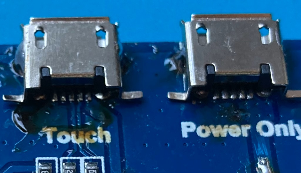

With my old EC 2002 this is a very challenging tasks, as you can see. For now the power port I ignored and soldered wires, for the touch-screen, with small PCB traces that is almost not possible, so I'm very curious how the WXsmart performs.
In order to get some experience, I played a bit with a few usb breakout boards. First I removed the connector with the hot air iron. The very first thing I detected is that I forgot to turn on the WXair, after that was fixed I learned that the station does not allow to connect two 'AIR' units at the same time, so no hot air and desoldering iron together:
Removing the usb connector with the hot air iron appeared to be quite easy:
I did this for two breakout boards, and next step is soldering them back first with the normal iron, and second with the hot-air iron.
For the normal Iron, I used the very small RTPS 001 C MS tip for the connections, and the larger RTMS 022 S MS for soldering the chassis.
I had to switch tips a couple of times, and once in a while the station did not recognise that a new tip was plugged in. I had to remove and insert the tip again before it was recognised.
Next test is with the hot air iron. Before soldering I applied som flux:
In the end the connector appeared a bit slanted on the board, and in the end I was a bit more comfortable with the normal tips, specifically since they are so small. Here the two results, left hot air, right the normal tips.

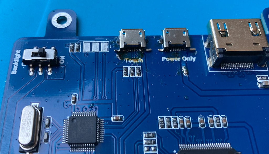

After these trails, it comes to the real work, so lets fix my raspberry pi monitor board.
The connectors were already off, but I needed to remove some left over solder. This worked the best with a normal tip, heating it up, and the desoldering iron to remove it.
Then I placed the connectors, first soldered the wire with the small tip, and then the chassis with the larger tip.
And here the result, difficult to see, but the connections are fine.

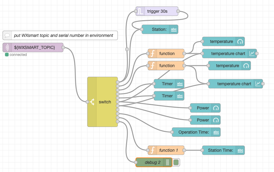

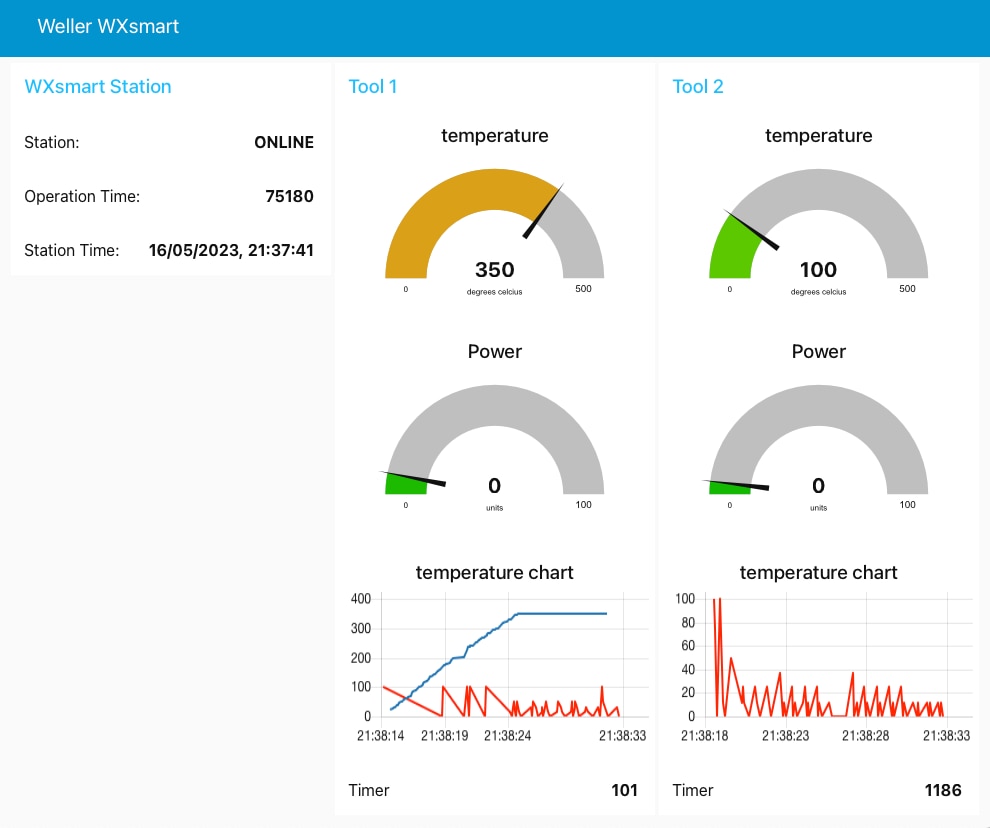

Now the MQTT broker works, there are a lot of possibilities. For this review I made a quick and dirty Node-Red dashboard. Here is a picture of the flow:
What the flow briefly does is: it listens for WXsmart messages, defined by WXSMART_TOPIC in the environment file in the Node-Red root folder (for serialnumber fill in the real number):
pi@rpizolder:~ $ cat .node-red/environment
WXSMART_TOPIC=WXSMART/serialnumber/STATUS/#
pi@rpizolder:~ $
It filters for specific strings, such as Tool 1 temperature and power, and displays it in a widget on the dashboard. It also checks whether it receives ONLINE from te station, if not it is probably of, and with a watchdog timer the dashboard shows OFFLINE. Here is a picture and video from the dashboard:
The code is far from ready, but getting it up and running with the setup problems described above took me quite some time.
Anyway, this very brief example gives you enough handles to build upon, you are welcome to Clone or Fork it from my Github repository:
https://github.com/AgriVision/NodeRed_WXsmart_MQTT_Control
