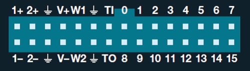

Depending on the different needs and wants of the ADALM2000 M2K, There are 3 main categories of users:
    • ADALM2000 users normally interact with real-world analog signals using Scopy or Alice.
    • Everyone should read this section, as it describes the device, and describes how to get the drivers and host software installed properly.
  1. ADALM2000 Application Developers:
    • Want to write their application interface for the ADALM2000 to run on the PC, but do not need to modify the ADALM2000 firmware or need to know the details on the ADALM2000's inner workings
    • Use Scopy's scripting ability. Write scripts in javascript and then call scopy via the command line.
    • Use libm2k to write C++/C#/Python applications that capture and generate data from the host PC.
    • normally write custom software or HDL (for the FPGA) that runs directly on the ADALM2000 device. This may put the ADALM2000 in different modes, and support different external USB devices (including LAN (via USB), or WiFi (vs USB)), extending the capabilities of the device. This includes all the information to compile HDL projects, compile kernels, change to custom USB PID/VID, and/or run custom user space applications
ADALM2000 M2K Connector Pinouts
