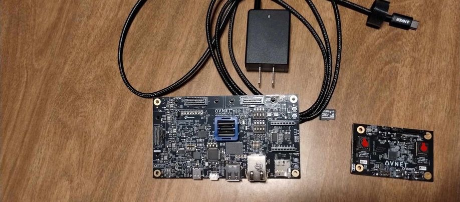

Contents:
  • Zuboard 1CG
  • Camera module (not used)
  • A beefy 3 A USBc power adapter
  • A nice Anker USBc cable
  • An 8 GB SD card (also not used)
Hardware Overview
Zuboard 1CG
  • Dual-core ARM Cortex A53 MPCore
  • Dual-core ARM Cortex-R5F MPCore
  • 81,900 logic cells of AMD Zynq UltraScale+ FPGA fabric
  • 1 GB ISSI LPDDR4 memory
  • 256 MB ISSI QSPI flash memory and microSD non-volatile boot options
  • USB 2.0 controller, 100/1000 Ethernet and JTAG via microUSB
DualCam camera module
  • The camera was not used
Power adapter
  • Capable of 15 V and 3 A
  • Power on LED indicator
Power cable
  • A nice, braided Anker USBc cable
  • Approx 6 ft length
microSD card
  • 8 GB Delkin Devices Utility+ microSD card.
  • UHS 1 rating (10 MB/s minimum sequential write speed)

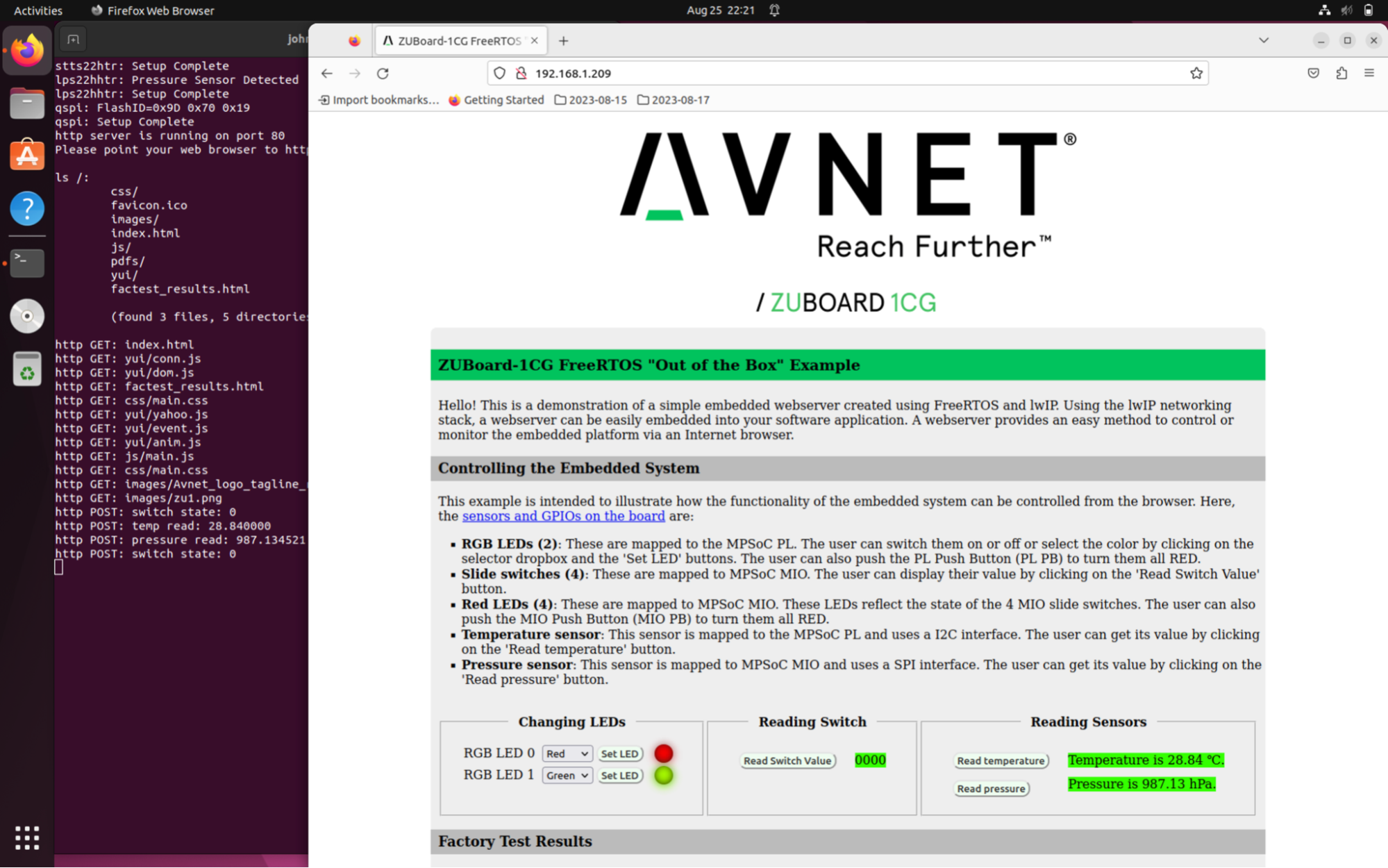

The ZUBoard comes preloaded with a test program in the onboard QSPI flash memory.  After connecting to the JTAG/UART debugging port with microUSB to the USBc dongle to my laptop and making it available to my virtual machine, I connected the supplied USBc cable to the power adapter and the power indicator LEDs lit up.  I found it easiest to connect the ZUBoard directly to my home network so it would be assigned an IP address by DHCP and routable from other computers in the house.  I ran sudo screen /dev/ttyUSB1 115200 in the terminal.  When I pressed the power button (SW7), the board came to life.  POST messages rushed past on the terminal and, critically, I was able to see the IP address of the board.  Putting this into my web browser allowed me to access the embedded webserver on the board and run the test.  I especially enjoyed changing the colors of the LEDs.  Everything worked perfectly out of the box!

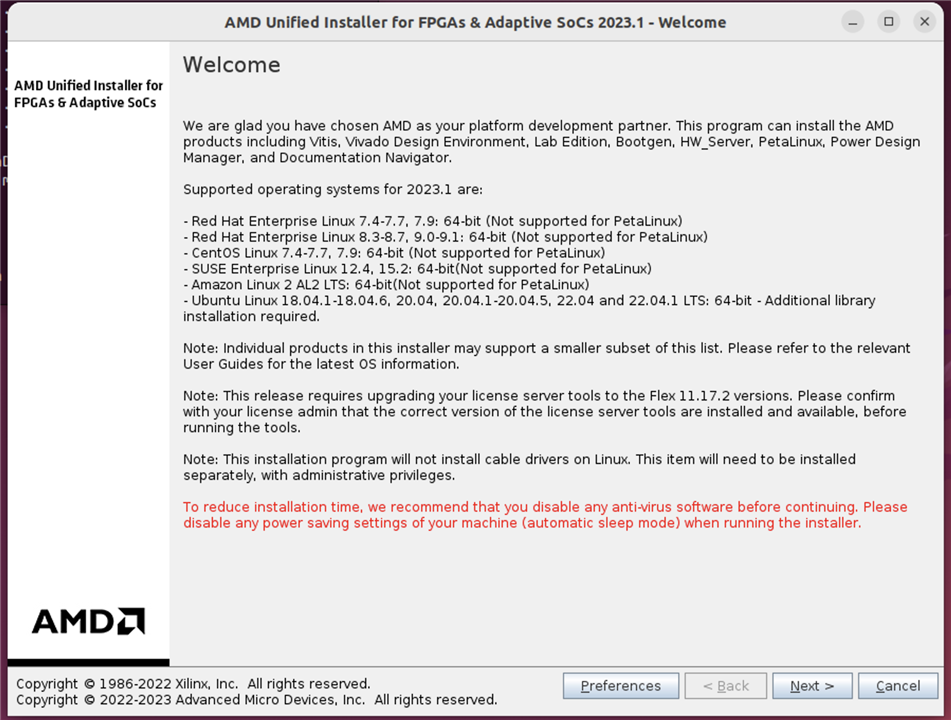

I reviewed system requirements for Vitis on the Xilinx website.  Seeing that macOS is not supported, I provisioned a new virtual machine in Parallels.  I saw the requirement for CentOS 7.9.  Since CentOS 7 has only been getting maintenance updates since 2020 and isn’t recommended for new development at this point, I decided to try version 9—do not do this!
I downloaded the Vitis installer from the Xinlinx website to my virtual machine.  I ran it with the command sudo ./Xilinx_Unified_2023.1_0507_1903_Lin64.bin.  I got an error right away that my operating system (CentOS 9) was not supported.  Furthermore, the list of supported operating systems as shown in the screenshot below indicated that CentOS was not supported for PetaLinux.  I do wish this was made more clear on the table of requirements on the website!  This would certainly not suit as I intended to use PetaLinux on the ZUBoard.  For these reasons, I decided to go with Ubuntu LTS.  After installing I realized I’d installed 22.04.2 instead of 22.04.1 but I did not get an error message when I went to install Vitis.
I tried several times to install Vitis.  Each time it would finish downloading and installing but hang at the same point just short of halfway through of the third Final Processing phase (see screenshot).  Not wanting to interrupt, I disabled the sleep functions on my laptop and virtual machine and left it to run overnight.  The next day, seeing no progress, I would shut down the virtual machine, increase the resources, and try again.  On the second attempt, I allocated four processors and 8 GB of memory.  On the third attempt I allocated eight processors and 16 GB of memory to my guest Ubuntu system.  Ostensibly, this attempt had also failed but when I restarted the virtual machine to try for a fourth time, the Vitis installer said it detected an installation of the software.  Installed or not, I am not sure that it is configured properly.
For one final attempt, I increased the memory for the virtual machine to the 32 GB and ran the installer again.  This also failed.  I was disappointed that all configurations tested up to and including 8 processors and 32 GB of memory for the virtual machine were insufficient for the Final Processing stage to finish.
