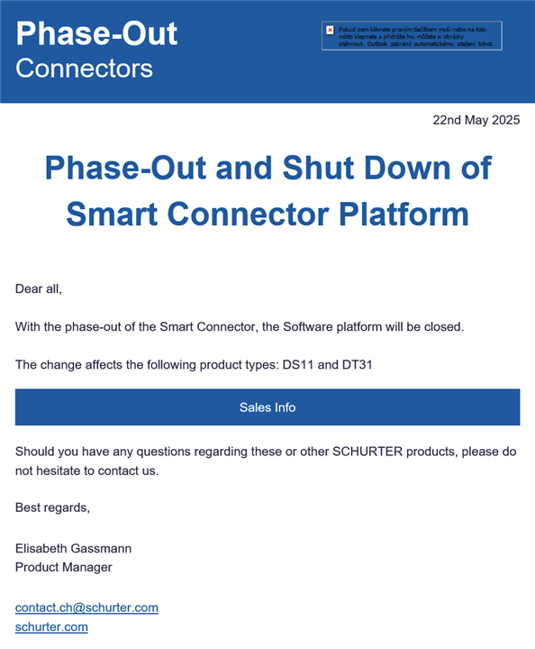

Before closing the review and giving some score, let’s go back to begin and let’s return to embeddable version of this connector. Since DS11 version is used for OEMs, the end users of DS11 most probably will never see Schurter mobile app as well as any other Schurter stuff. Instead, they will see app from integrator of the connector. Schurter cloud allows OEMs to integrate device to their own systems and it is completely possible to rebrand whole Schurter solution to your own app and even make it slightly better. API basically allows implementing exactly the same as Schurter did in web dashboard and mobile apps. I still missing some feature which may be useful for OEMs. For example, now it is impossible to automatically provision device. Provisioning requires using Schurter mobile app and I did not find any way how to implement it on my own. If I make my own device with integrated DS11, I need to implement selection of Wi-Fi network and entering password in my branded mobile application but currently I did not find any documentation about Bluetooth API which should I need to implement in my app. At last, I originally expected that there is some possibility to adjust behaviour of button and RGB LED. But it is not. I thought that I will be able to set RGB colour and blink mode using API somehow and for example bind some cloud action to button presses, but there is nothing like this nowadays (or I did not find it).
My conclusion is positive. It is nice device. Hardware side is very well built. Device looks robust and safe. In comparison with Chinese cheap craps, it is properly certified by trustworthy authority. This is the most valuable part of the device, I think. Measurements seems accurate. I am slightly disappointed from iOS app. I had issues with it which Schurter resolved but still it show slightly misleading data, filters peaks and functions are limited in comparison with web dashboard. Web dashboard is well built and useful. Web dashboard also shows data better in comparison with iOS app. There is currently no way how to redeem more than 3 days of data except digging them manually using API. API is nice and easy to use. Subscription plans are not clear, so it is hard to judge. Device support only basic networking protocols and do not support any modern networking technologies (no 5 GHz networks, no IPv6, no WPA Enterprise, …).
