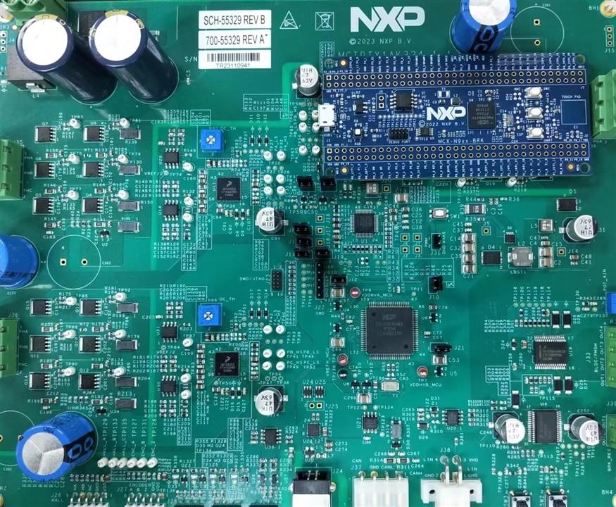

The MCTPTX1AK324 is a reference design board for PMSM motor drive, Based on the 32-bit Arm® Cortex®-M7 S32K3 microcontroller and the GD3000 pre-driver, the MCTPTX1AK324 controls three sensorless-based PMSMs, one direct current (DC) motor and four valves under low CPU loading.
bottom of the PCB
The PCB board is big in comparing with small NXP-MCX-N947-BRK board with Dual ARM-M33 cores, for which NXP provide application on PMSM drive as well.
While It is easy to understand S32K324 with dual ARM-M7 cores is much high performance. The diagram for the  MCTPTX1AK324 shows that 3x 100W PMSM  motor, 1x 20W DC motor and 4x Direct Drive load can be controlled by this Reference design.

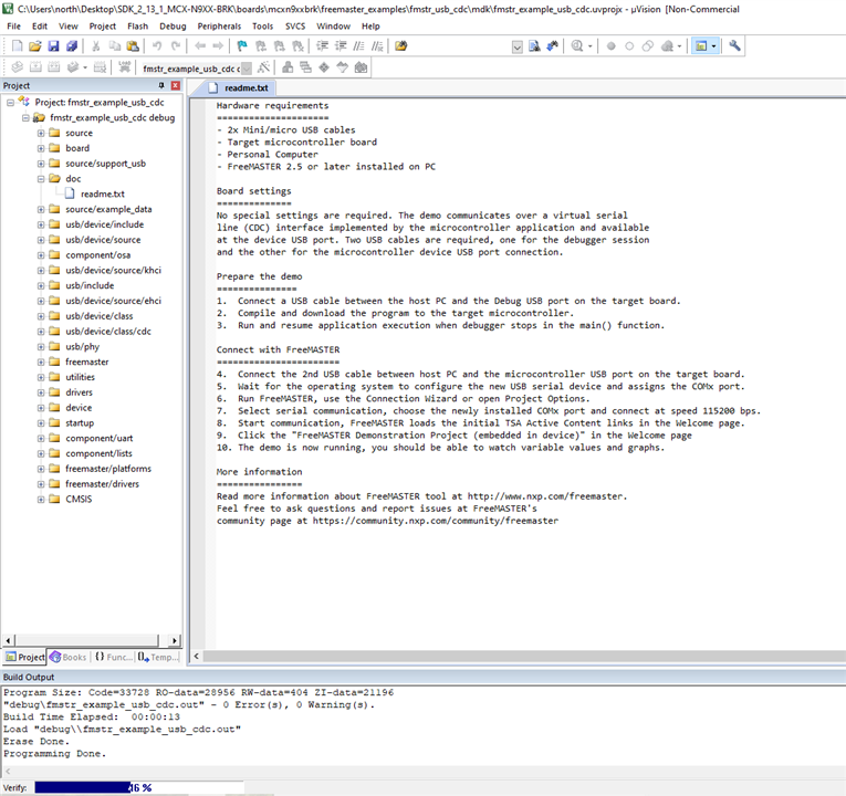

For comparation , NXP-MCX-N947-BRK board  is tested first with Example Freemaster project on USB-CDC, as explained below, Keil MDK v5.39 is used as IDE.
Then, use connectio wizard to find USB-CDC in 115200
Start the Freemaster project to demonstrate the motor speed and direction control,

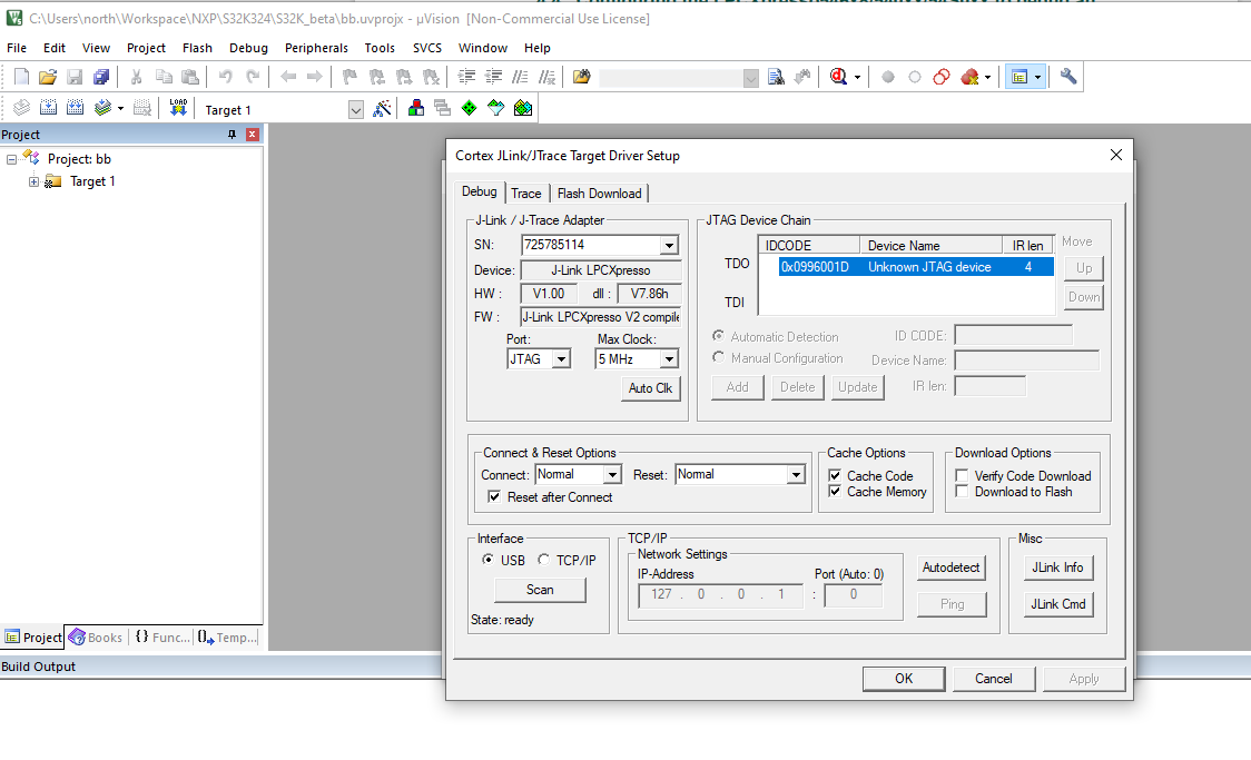

I simply install MDK package for S32Kxxx and probe the S32K324 MCU with one small CMSIS-DAP debugger,
The core can be probed in setting page of any project in MDK, But it is not recognized as NXP chip, just general ARM core MCU. But that is enough to tell the board is well and ready to go.

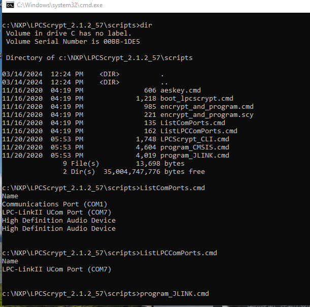

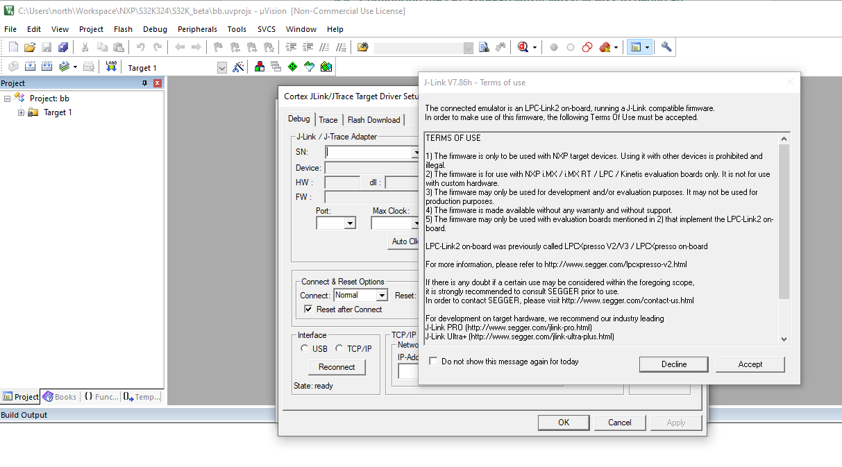

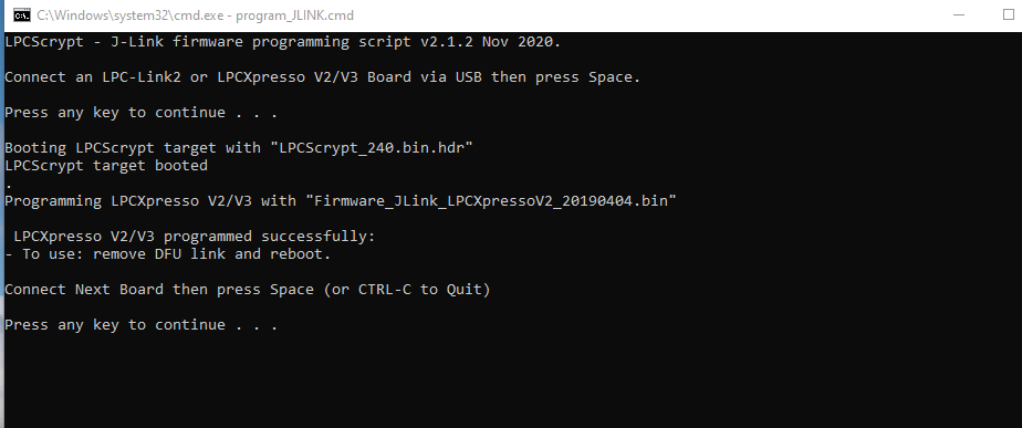

But for now, only Jlink and PE micro is supported in S32 Design Studio for S32 Platform. I choice NXP Jlink OB version debugger first, then I pick one LPC54628 xpresso EVB with which debug out can be used.
The out-of-factory drive for LPC54628 xpresso EVB is CMSIS-DAP, I need to flash into Jlin with LPCscript v2.1.2_57 in DFU mode.
Flash successfully,
Set the JP5 and select debug out with JP2
Now, the debugger is recognized as Jlink as follows, but the S32K324 is not recognized by this jlink driver
Now , the MCU core is recognized as Unknown
Here comes result, the LPCscrpt v2.1.2_57 Jlink driver can not support S32K324, So does the CMSIS-DAP in S32 DS v3.5. But CMSIS-DAP can do in Keil MDK v5.39.

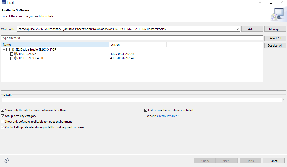

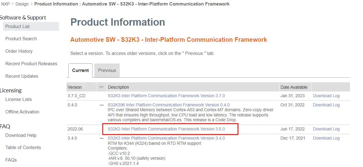

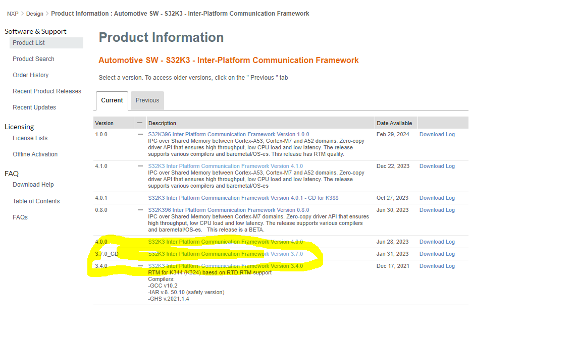

Another Problem is IPCF package, the instruction require IPCF3.6.0
But IPCF v3.6.0 is not accessible in official site,
Here is the bug, the IPCF v3.7.0 is not compatible since it support S32K396 only, if no IPCFv3.6.0 is available , use IPCF v3.4.0, it works. I use IPCF v4.1.0, it seem work as well

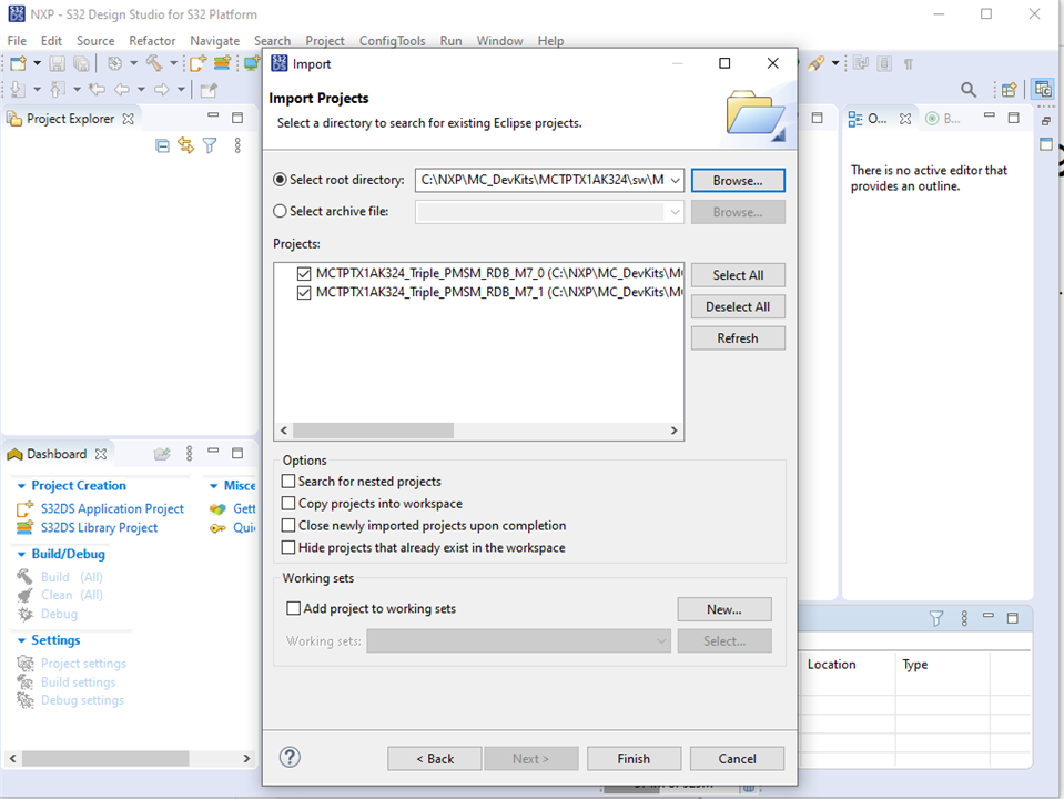

5 Example Application Software
Import the application software project, this is dual ARM-M7 core application, so two projects in one workspace,

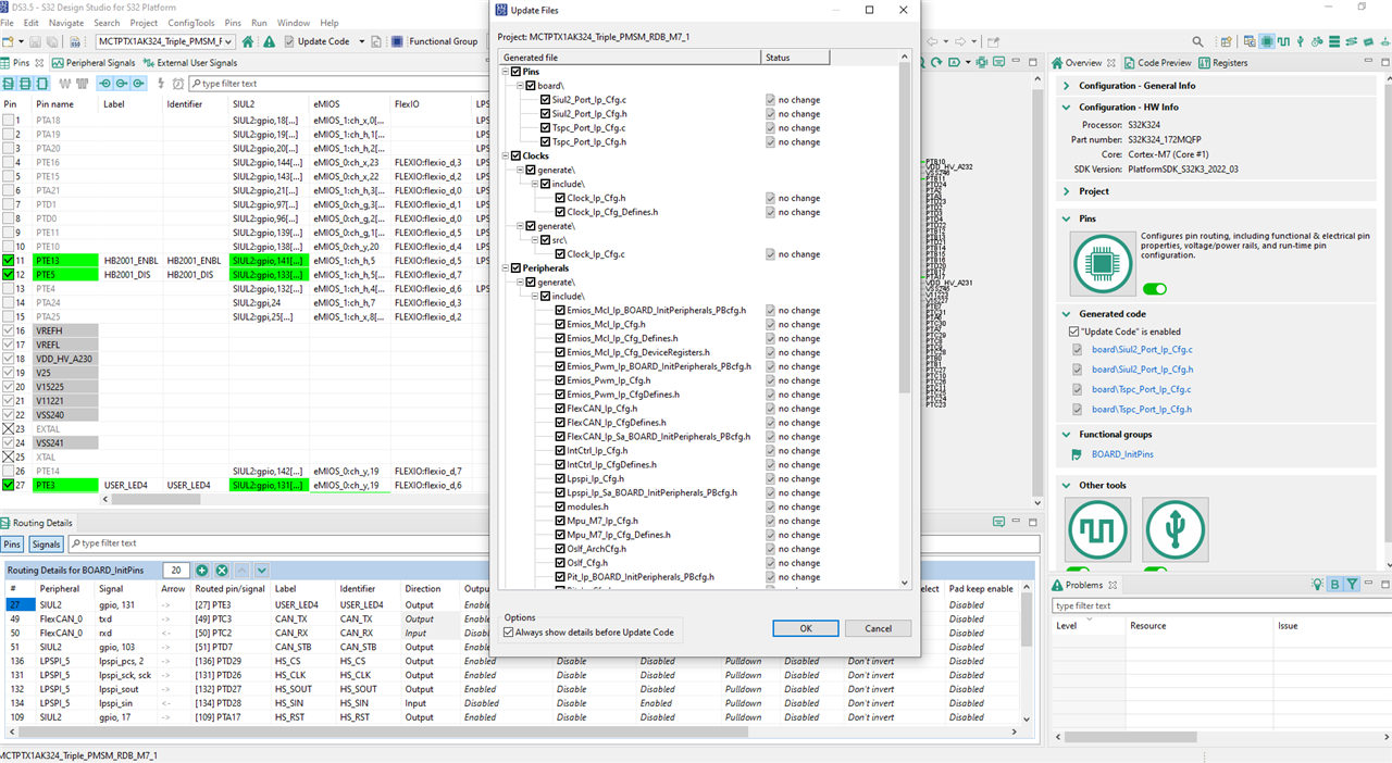

After import the Example Application Software and prepare compatible packages, open the .mex file.
Then update the peripheral configuration. That is important step, not mentioned in user manual,
If you could not configure the packages and software, you would not see this screenshot, normally you will see "plateformSDK_S32k3_2022_03" related errors.
Sometimes , there are error in pin configuration, close it , do not save configuration , update the package and reload the project, it will be OK as above screenshot,
Update the code, the red mark means the ipcf_lp_cfg.h file is not available and shall be deleted from project,
Here is the UI after code updated, no red marks now,

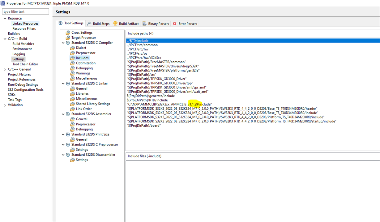

Save the configuration and revise the package library for AMMCLIB

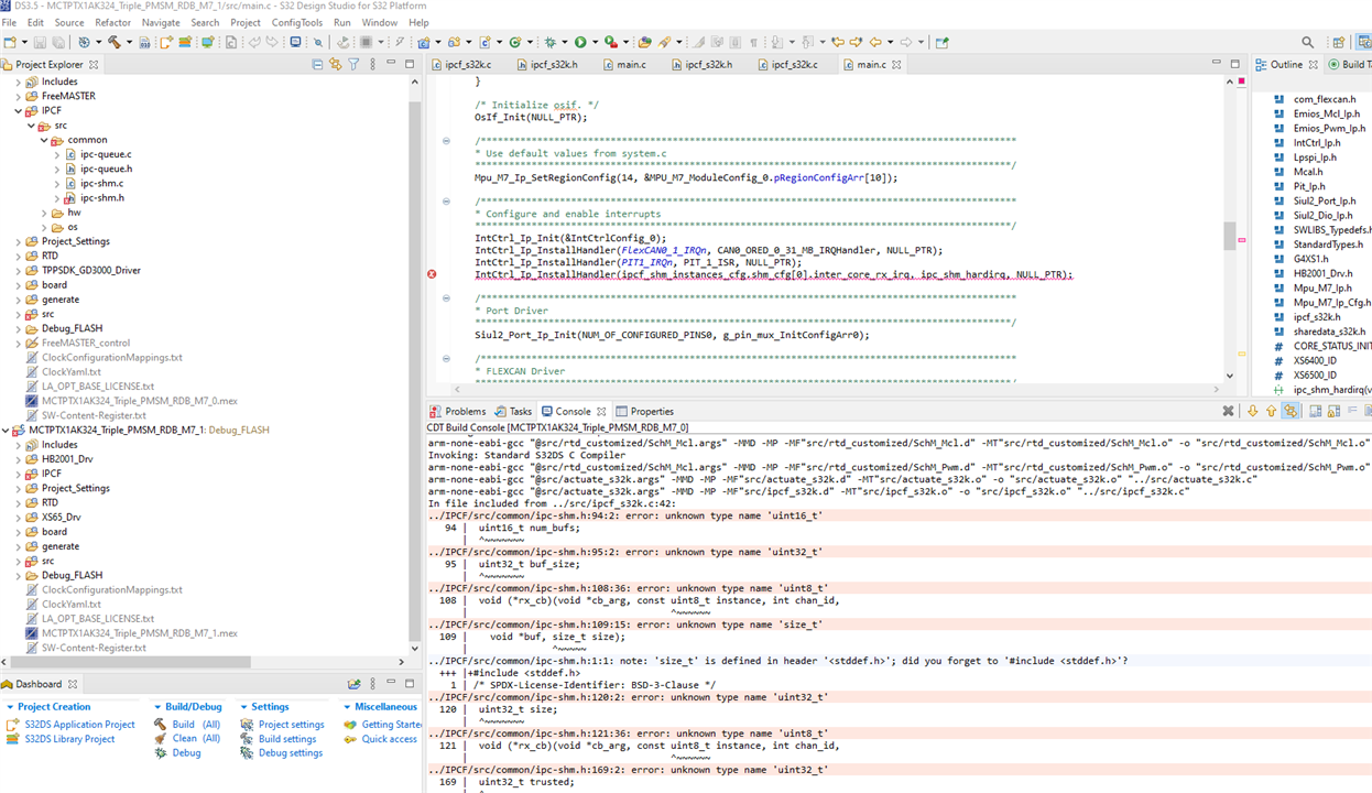

build the project
There are many errors. The definition of u32int etc  are missing. I guess the  ipcf_lp_cfg.h is important and can not be deleted.
6 Conclusion and Next to do
Although missing ipcf_lp_cfg.h stops me for this roadtest. I think there is still way to go. The inter processor communication is not a-must for  the roadtest, revise the project to run on single core can skip the problem as next step.
