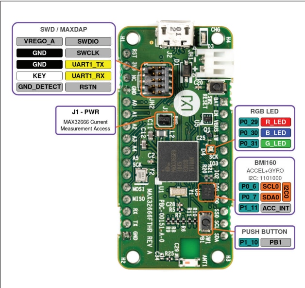

MAX32666FTHR Pinout Diagram
Top View – Debugger Header Pinout | RGB Light Pin Config | Push Button Pin | BMI160 (6 Axis IMU ) I2C Pinout  | Current measurement jumper

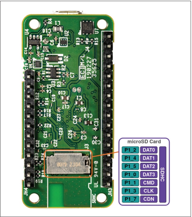

Bottom View: MicroSD Card Pin config

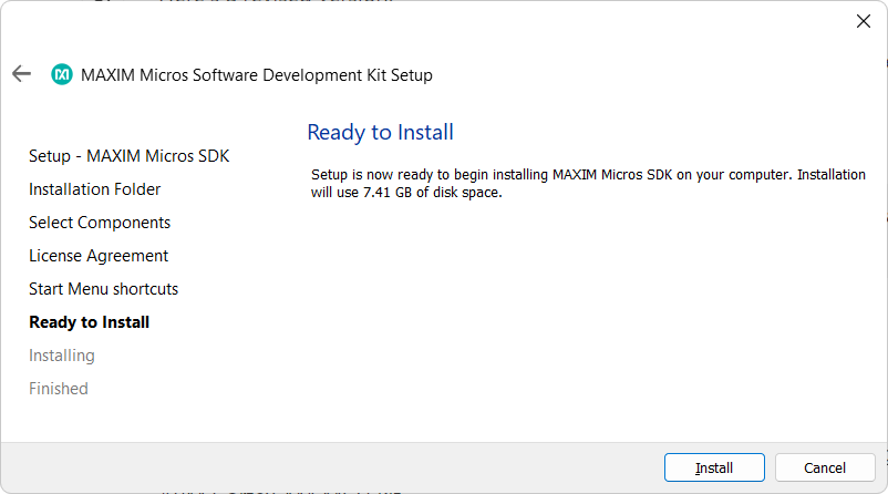

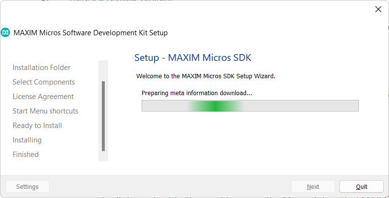

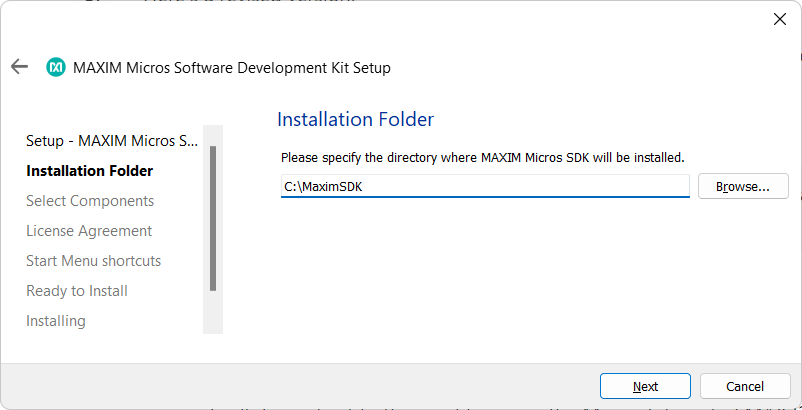

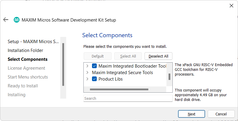

SDK Installation Process:
To begin the SDK installation, follow the steps outlined below. During the installation process, you may be prompted to provide some information, similar to the requirements of a typical application installation. On my Windows 11 PC, the entire installation took approximately 20 minutes.
Installation Steps:

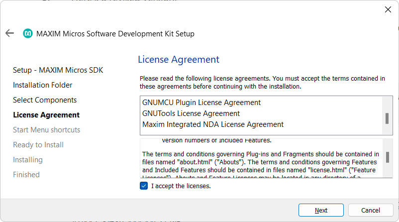

  • License Agreement: Accept the terms and proceed to the next step.
  • Component Selection: I opted for the default selected options.
  • Installation Path: I used the default path in the C drive with a new folder, then clicked 'Next.'
  • Installation: The installation used around 7.41 GB of memory space. Some data will be downloaded during this process, so an internet connection is required.

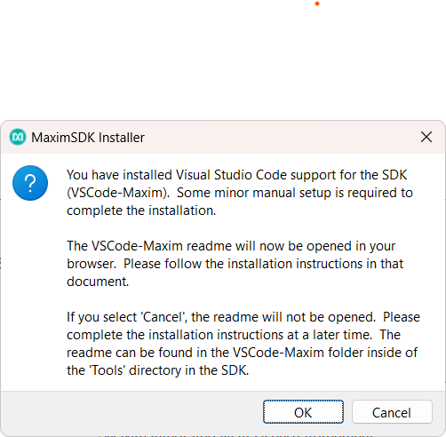

  • VS Code Setup: after Install complete ask for setup VS Code plugins. Process link - https://github.com/analogdevicesinc/VSCode-Maxim/blob/v1.7.0/README.md#vscode-maxim
This SDK installation process includes the Eclipse-based IDE, with all relevant plugins and the SDK toolchain pre-configured. While there are also VS Code-based plugins available, I chose to proceed with the Eclipse-based IDE setup, as it aligns with my preferences.

IMAGE TITLE: License Agreement

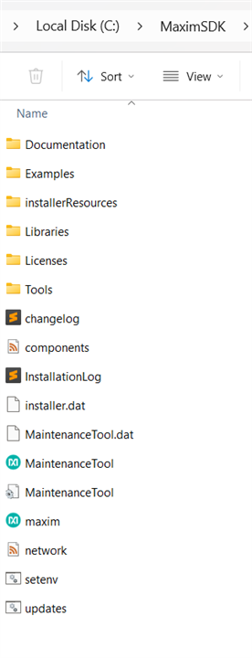

After the installation is completed, navigate to the installation directory and run setenv.bat. This script will configure the global environment settings.
The setup folder for MaximSDK is organized as follows:
To open Eclipse, navigate to C:\MaximSDK\Tools\Eclipse\cdt and run eclipse.exe. You may be prompted to specify a workspace path on the first launch. Choose a convenient location for the workspace and open the Eclipse window.

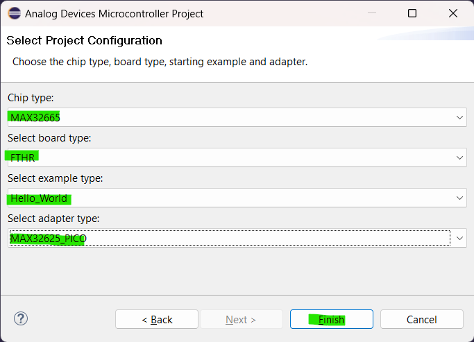

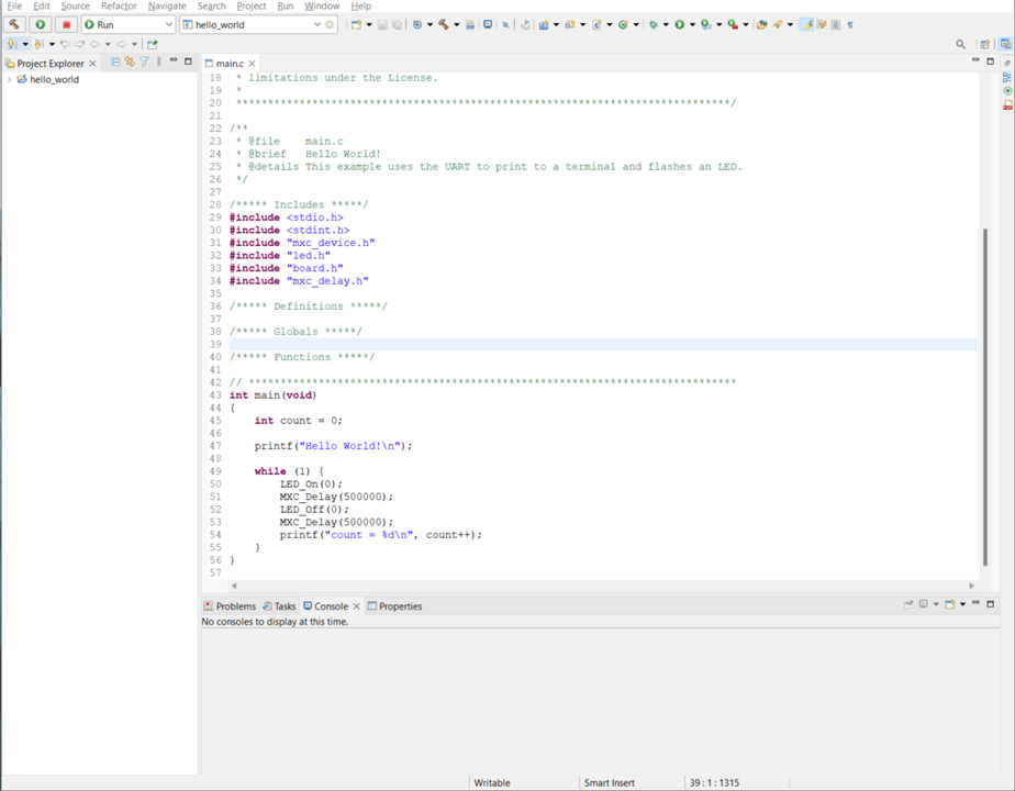

First Example Code (Hello world)
To create your first project and print Hello_World in the debug window, follow these steps:
{gallery}Hellow_world Project create
IMAGE TITLE: Select Analog Device MCU
IMAGE TITLE: Select MAX32665
IMAGE TITLE: Set project parameter -> Finish
Step 1: Create a New Project
  • Navigate to New Project and select C/C++ > Analog Devices Microcontrollers
Step 2: Configure Project Settings
  • Set the Project Name and Location. Use the default location for this project.

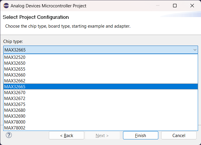

Step 3: Select Device and Configuration
  • In Chip dropdown menu, choose MAX32665 instead of MAX32666. Although the dropdown may not Show MAX32666, select MAX32665 as both are from the same MCU series.
  • Board Type : FTHR.
  • Select Hello_world from the Example Type dropdown.
  • Choose MAX32625_PICO from the Adapter Type dropdown.
  • Click Finish to complete Hello_World Example creation.

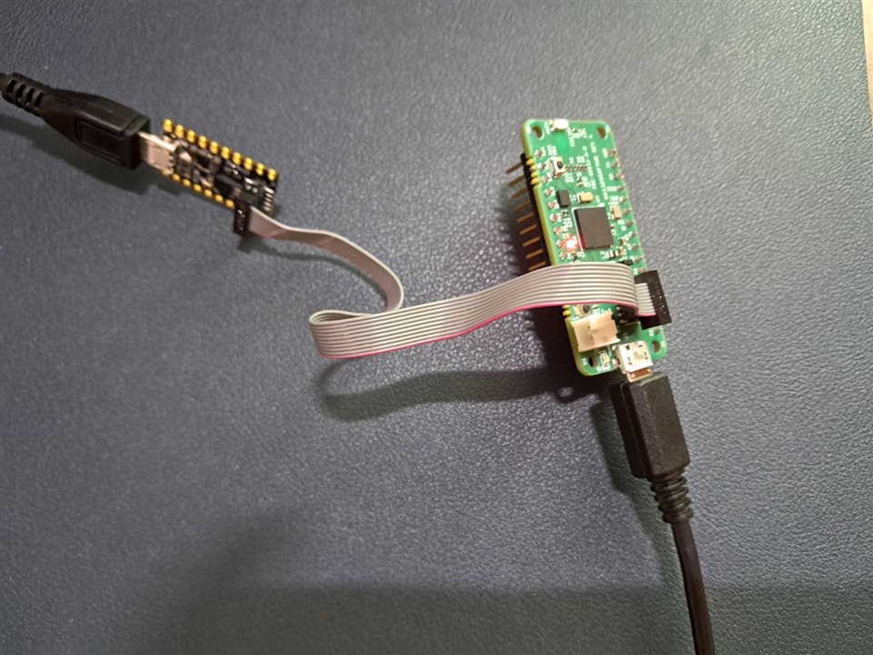

Eclipse IDE created a 'Hello World' project that looks like below. The project was built and executed using the standard Eclipse build process, and the HEX file was flashed onto the FTHR Kit.
{gallery}Hello World Example
IMAGE TITLE: Eclipse View
IMAGE TITLE: FTHR Kit and Debugger Connection with PC

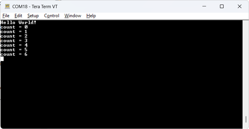

Result :
Open any serial terminal :I used TeraTerm and connected to the Detected COM port. Set the baud rate to 115200. In the terminal, you will see the output as shown below: the message 'Hello World!' is printed, and incrementing count = 1 ++. Additionally, the LED 0 (red LED) on the FTHR Kit blinks according to the programmed logic.

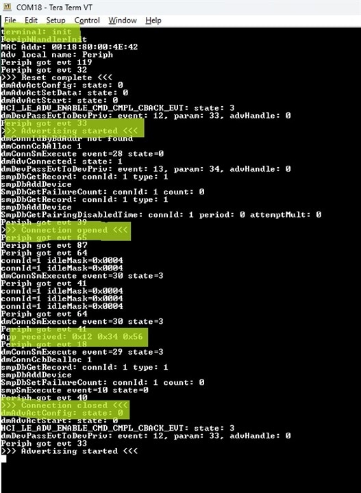

BLE Peripheral Example
create a New Project as mentioned process in the Hello World Project. and in the final step select the example code as BLE_Periph in the example dropdown. and build project and Flash.
Serial Terminal Output
I have highlighted the following event logs: 1) Advertisement started, 2) Connection established, 3) Data sent from mobile to device (e.g., 0x123456), 4) Device disconnected, and 5) Upon disconnection, advertisement restarted and reconnection initiated.

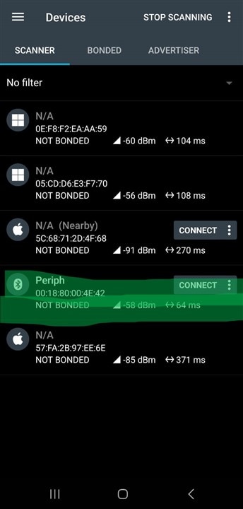

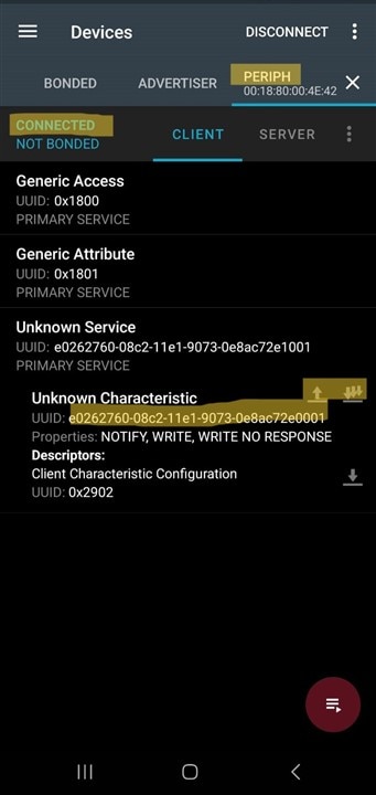

For the BLE test, I used the NRF Connect Android application to conduct a connectivity test and send data via the GATT Custom profile.

IMAGE TITLE: nRF Connect App - BLE Advertise List
IMAGE TITLE: Connected Device Service List
