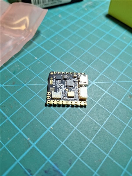

Unboxing
That stage (pleasant indeed) doesn't need to be explained.
The board is small (definitely not basic arduino form factor) “tiny” 22.86 x 22.86 mm
Details of dimensions and pinout are described on that sites:
https://docs.arduino.cc/learn/hardware/nicla-form-factor
https://docs.arduino.cc/resources/pinouts/ABX00061-full-pinout.pdf
That makes Nicla compatible with the Portenta and  MKR family.

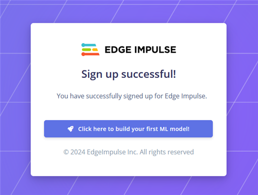

Edge Impulse provides 14-day free trial for the “Enterprise” plan with Full platform access for enterprise companies needing enterprise-wide collaboration and advanced tools
I I registered with the free “Community” plan which provides up to 2 projects

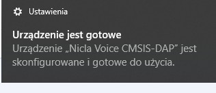

Primary communication and programming is provided with usb connection.
Nicla Voice is shown in the system manager as CMSIS-DAP device.
Details of of how Nicla is recognized in Windows are shown in the video below

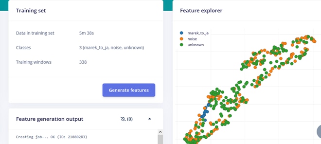

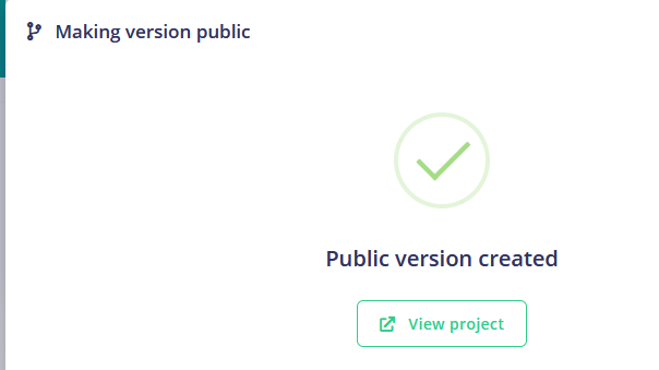

Machine Learning Tools integration via the Arduino Cloud
https://app.arduino.cc/integrations

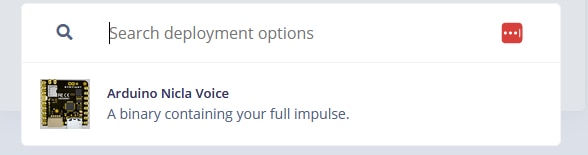

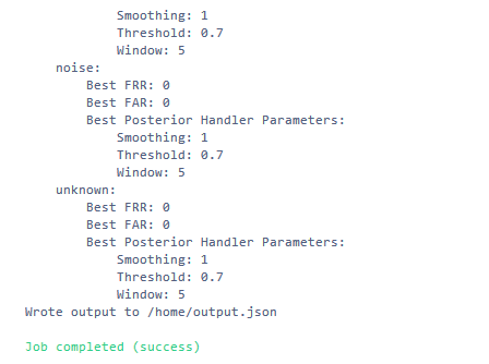

With active Arduino and Edge Impulse  account
I could go again to my project at arduino cloud

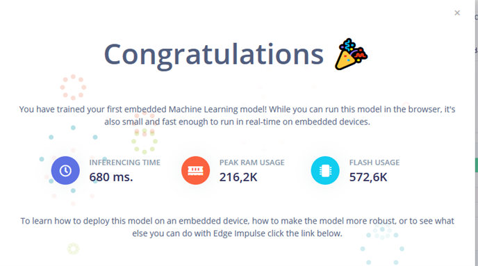

In the video we can see process of training the model
and deployment
and finally success!!!

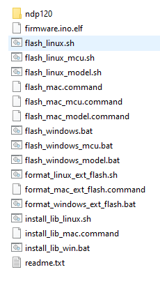

Now I have exported package (zip archive) with built Nicla Voice firmware
 archive  content:
Flash Machine Learning model onto the Nicla Voice
To flash Machine Learning model created with Machine Learning Tools integration onto the Nicla Voice,
we need to install the Arduino CLI and Edge Impulse CLI.
(according to the instructions from Edge Impulse)
 Installing some additional dependencies would be also required

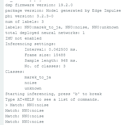

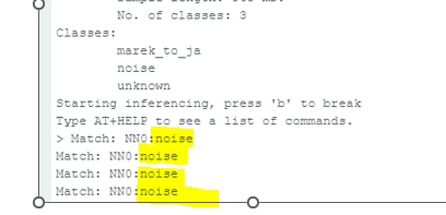

unfortunately I had errors trying to run the firmware
screen from the serial monitor:
Hello from Edge Impulse on Arduino Nicla Voice
Compiled on Nov 13 2023 09:35:32

My model (firmware) also works:
my voice was not easy to recognize
but sometims it is successful

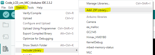

example code requires the following libraries:
arduino-libg722-a1.0.0         https://github.com/pschatzmann/arduino-libg722
arduino-audio-tools-0.9.8   https://github.com/pschatzmann/arduino-audio-tools

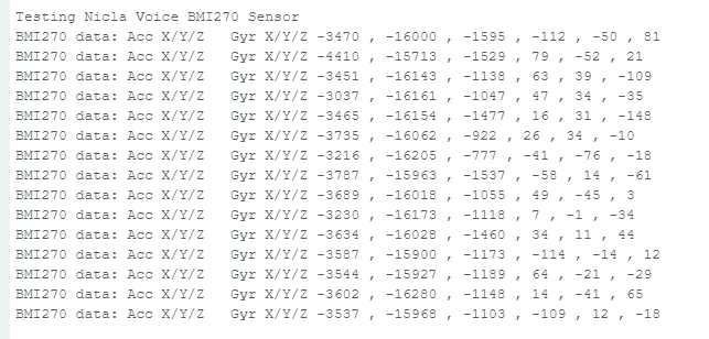

Accelerometer and Gyroscope data acquisition
There I wanted to see capabilities of Nicla’s Inertial Measurement Unit
Onboard BMI270 is the 6-axis ultra-low power Inertial Measurement Unit (IMU)
It consists of a 3-axis accelerometer and a 3-axis gyroscope.
They can provide information about the board's motion, orientation, and rotation in a 3D space. The BMI270 is designed for wearables and offers low power consumption
and high performance, making it suitable for various applications, such as gesture recognition, motion tracking, or stabilization.
The example description is available in Nicla user manual
(https://docs.arduino.cc/tutorials/nicla-voice/user-manual )
Motion Detection with Nicla Voice and Machine Learning Tools
https://docs.arduino.cc/tutorials/nicla-voice/motion-detection-ml/
Details in the video:
gyroscope data on serial monitor

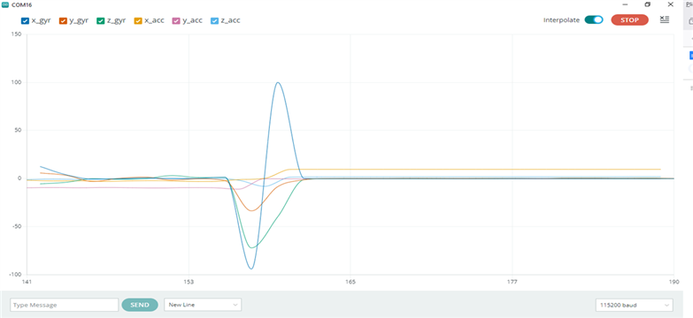

Data are even better visualized on arduino IDE serial plotter:
