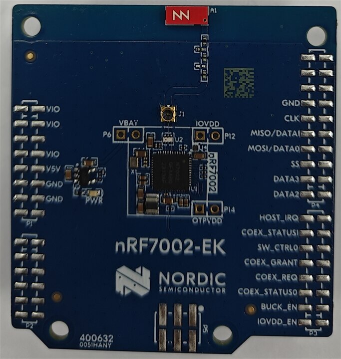

The nRF7002 evaluation shield kit
nRF7002 Wi-Fi® companion IC is Dual-band 2.4 GHz and 5 GHz Wi-Fi 6, Compatible with IEEE 802.11ax (also known as Wi-Fi 6) and earlier standards IEEE 802.11a/b/g/n/ac , with Onboard 2.4/5 GHz antenna,Default Serial Peripheral Interface (SPI) to DK
The SSID scan function shall be used in nRF wifi drivier in nRF SDK.
To communicate with the host processor, the nRF7002 EK supports SPI or QSPI interfaces. The unique wireless coexistence support on the nRF70 Series ensures that protocols such as Bluetooth Low Energy, Thread, or Zigbee can seamlessly co-exist with Wi-Fi The nRF7002 is fully integrated into Nordic's nRF Connect SDK,as nRF wifi drivier.nRF Wi-Fi driver (nordicsemi.com) As the block diagram shows. This is how it can work with other nRF chips by connecting the nRF7002 EK to an nRF52840 DK you can evaluate the cost-effective combination of nRF52840 and nRF7002.

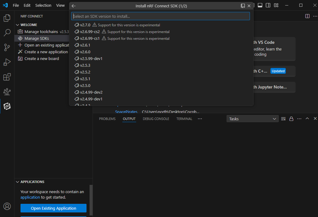

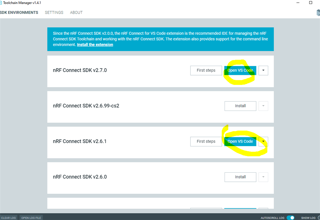

3.1 Download and install VS code and nRF connect for desktop, then select nRF SDK to install
open tool manager to install nRF SDK then open installed  VS code , but this is legacy nRF SDK installation. That is not well done now.

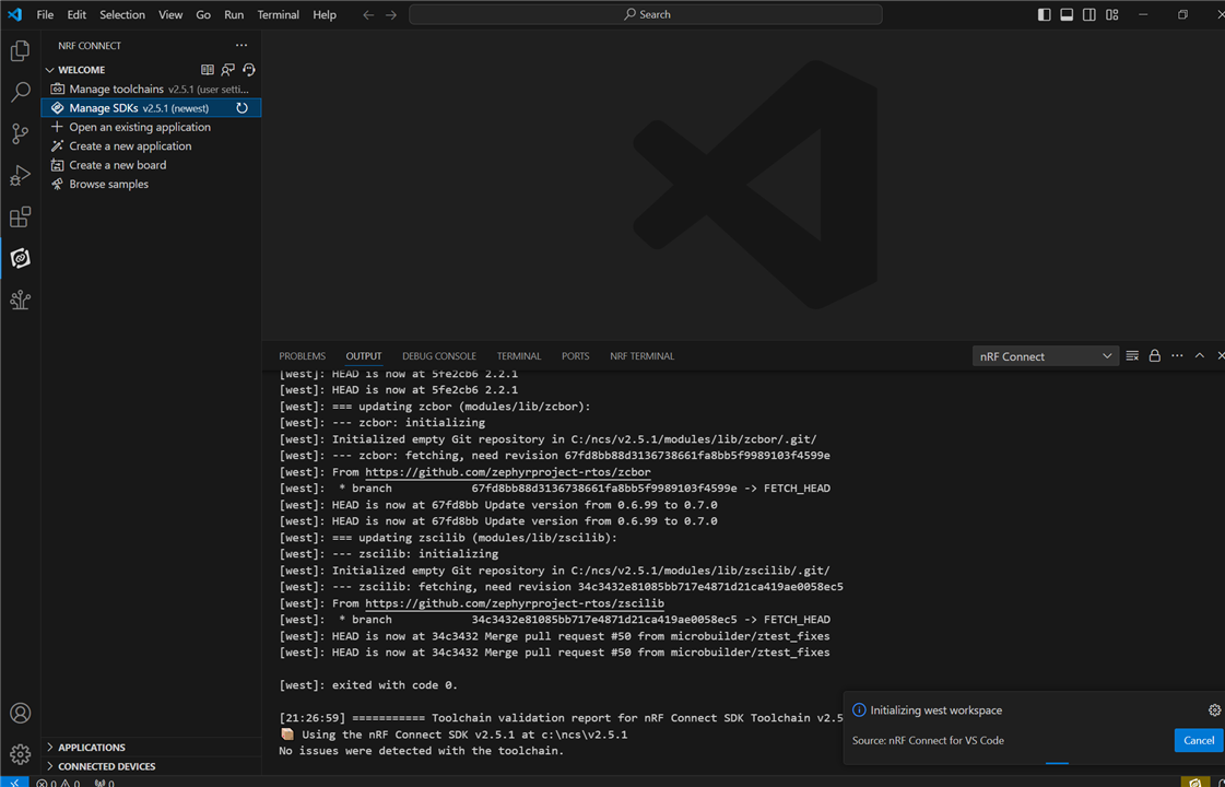

3.2 Install nRF SDK in VS code extensions. First install selected toolchains
Then install selected nRF SDKs
That nRF SDK after 2.6.0 seems would take too much time and occupy more disk space. The version 2.7.0 is experimental. It takes too much time to find out version 2.5.1 is enough for this roadtest.

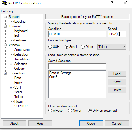

Open putty , select first newly discovered port as 115200bps

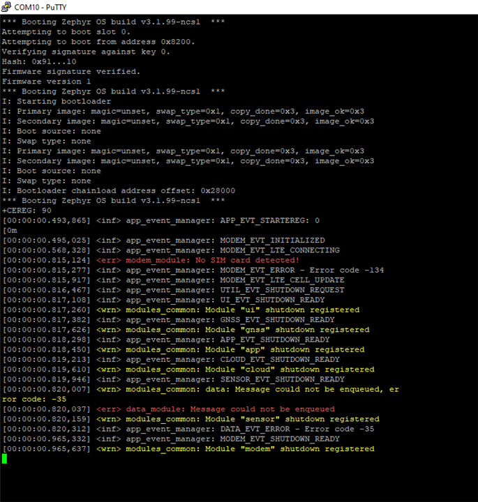

Then feedback operation log for this sample project.

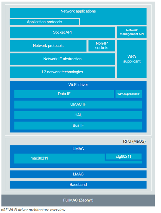

4.2 nRF WIFI driver
The nRF wifi driver is important in this solution. The nRF9160 can work with wifi driver as well as nRF7002 DK, the sample code is same for both choice. It can be select with configuration in west command line
west build -b nrf7002dk/nrf5340/cpuapp
or
west build -b nrf5340dk/nrf5340/cpuapp -- -DSHIELD=nrf7002ek
as Sample description  in wifi radio test sample
Or go deep for Kconfig
Since nRF70 Series device is a companion IC and can be used with any Nordic Semiconductor System-on-Chips (SoCs), such as the nRF53 and nRF91 Series SoCs. Enable the driver by using the CONFIG_WIFI_NRF700X Kconfig option. The nRF7002 EK driver communicates with the nRF70 Series device using the SPI interface. The driver uses the SPI interface to send commands to the nRF70 Series device, and to transfer data to and from the device.  Refer to nRF Wi-Fi driver (nordicsemi.com) , nRF70 Series Wi-Fi layers (nordicsemi.com), and Network APIs — Zephyr Project Documentation
