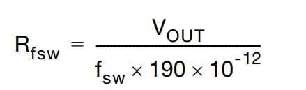

The SiC967EVB-A module has a number of jumpers and resistors that need to be configured properly to achieve a particular result.
This section shows the process I went through to configure the module for my application.
The default input voltage is nominally expecting 48 V DC. My input source is 12.3VDC, so I needed to change R6 from 43K to 68K.
The formula to calculate R6 is as follows:
R6 = (Vin – 1.4) * R5 /1.4 where R5 = 10K
Since I want a non-standard voltage, I had to replace R10 from its original value of 43K to 94K
The formula to calculate r10 is as follows:
R10 = Rfbl * (Vo – Vfb) / Vfb where Rfbl = 10.2K, Vo = 8.2, Vfb = 0.8,
To have R10 define the output voltage, J5 must be in the first position next to R10.
