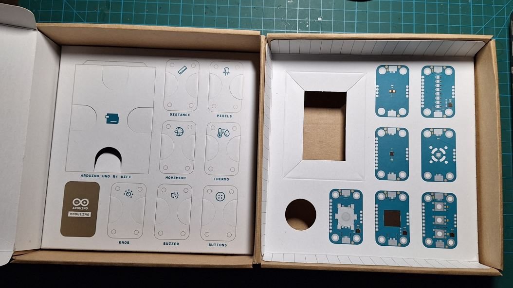

 UNBOXING   image
At this point, I want to emphasize how much joy the packaging aesthetics bring to young Arduino enthusiasts,
along with the revolutionary "Plug and Make" concept that enables project building without the need for soldering,
thanks to Qwiic connectors and cables.
Additionally, the practical storage box for the UNO R4 WiFi board and modules is a great touch.

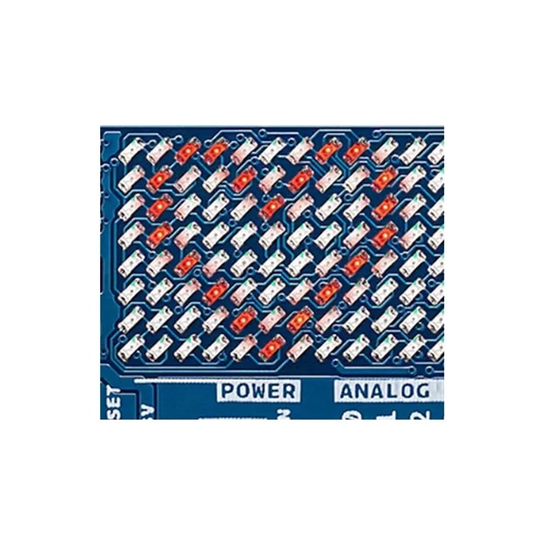

The board enables Wi-Fi communication, is equipped with an LED Matrix, Real-time Clock (RTC),

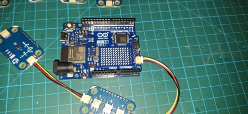

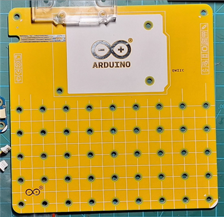

The SET
The AKX00069 Arduino Plug and Make Kit features the UNO R4 Wi-Fi, enabling seamless wireless integration with the Arduino Cloud.
It includes seven Modulino® nodes, easily connectable via I2C Qwiic cables for a fully solder-free experience.
This kit provides an intuitive introduction to IoT and electronics, allowing effortless project customization.
It’s hard to overstate the advantages of using the Modulino Base Plate and Modulino nodes.

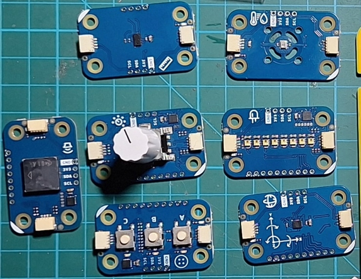

The seven modules included are:
  • Modulino Knob - a rotary encoder control with a push button, too (controlled by STM32C011F4)
  • Modulino Pixels - an RGB LED Strip with 8 pixels (controlled by STM32C011F4)
  • Modulino Distance - a precise VL53L4CDV0DH  distance sensor that uses a time-of-flight laser

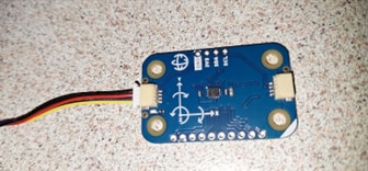

  • Modulino Movement - an 6-axis inertial measurement unit LSM6DSOXTR for accurately measuring the tilt, roll, and yaw
  • Modulino Buzzer - a small but loud buzzer for playing sounds and musical tunes (controlled by STM32C011F4)
  • Modulino Thermo - a temperature and humidity HS3003  sensor
  • Modulino Buttons - a circuit that has three buttons (controlled by STM32C011F4)

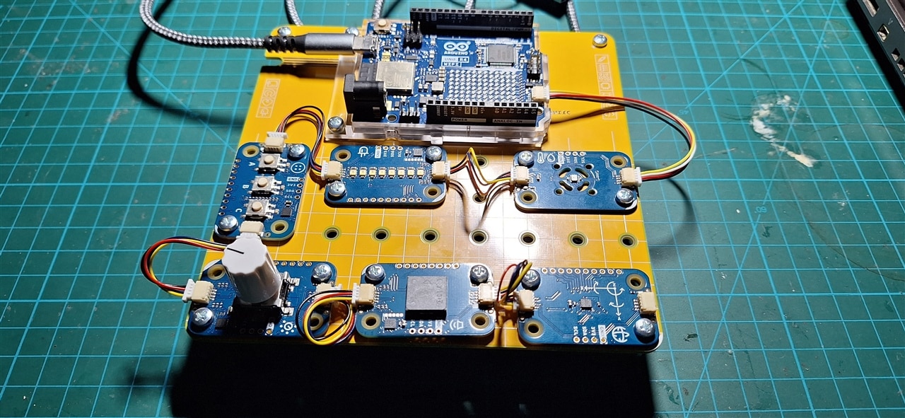

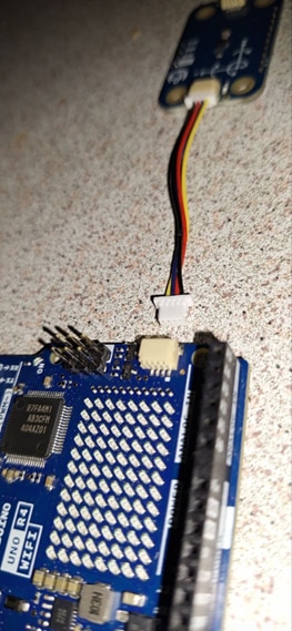

Qick assembly of the SET

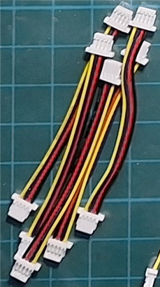

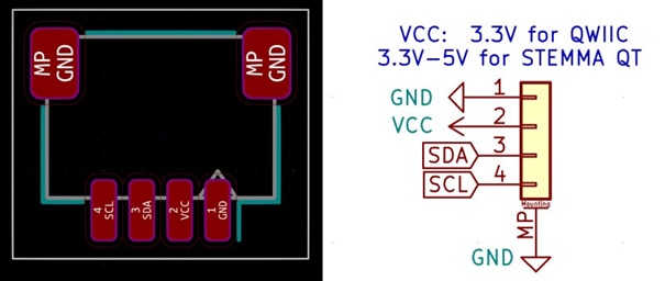

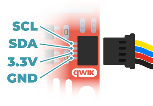

Qwiic connector
The Arduino Plug and Make Kit simplifies prototyping with seven Modulino® nodes using SparkFun's Qwiic standard for modular I²C devices.
This solder-free system allows quick and secure connections via a single Qwiic cable, eliminating wiring errors with polarized 4-pin connectors (JST-SH raster 1mm).
The 1 mm-pitch Qwiic connectors save space, and the daisy-chaining capability enables seamless I²C bus expansion, making it ideal for scalable projects.
SparkFun Qwiic Connect System:   https://www.sparkfun.com/qwiic
Qwiic Overview and FAQ:     https://forum.digikey.com/t/qwiic-overview-and-faq/44944

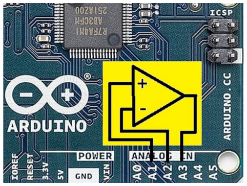

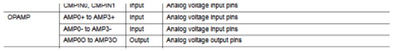

- Arduino UNO R4 WiFi OPAMP
https://docs.arduino.cc/tutorials/uno-r4-wifi/opamp/

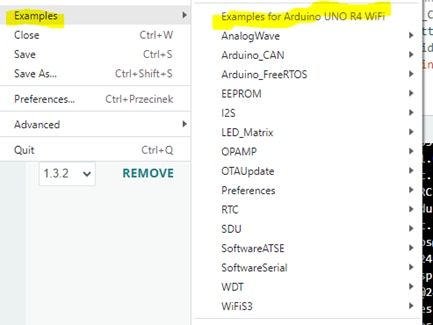

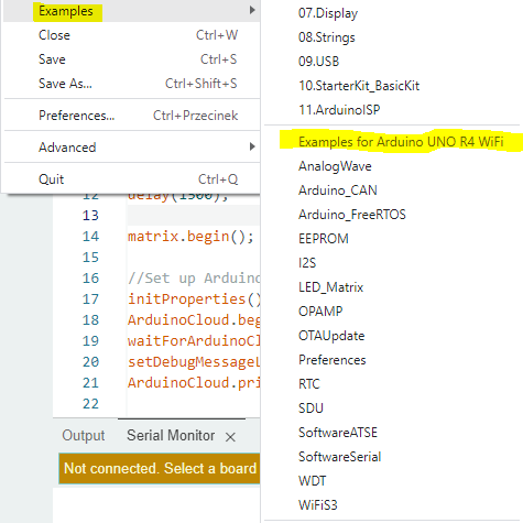

The sketches are available in DEMO examples in Arduino
Select the proper board in Arduino IDE
go to examples

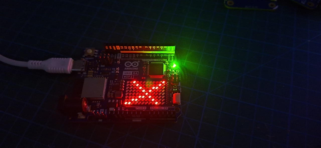

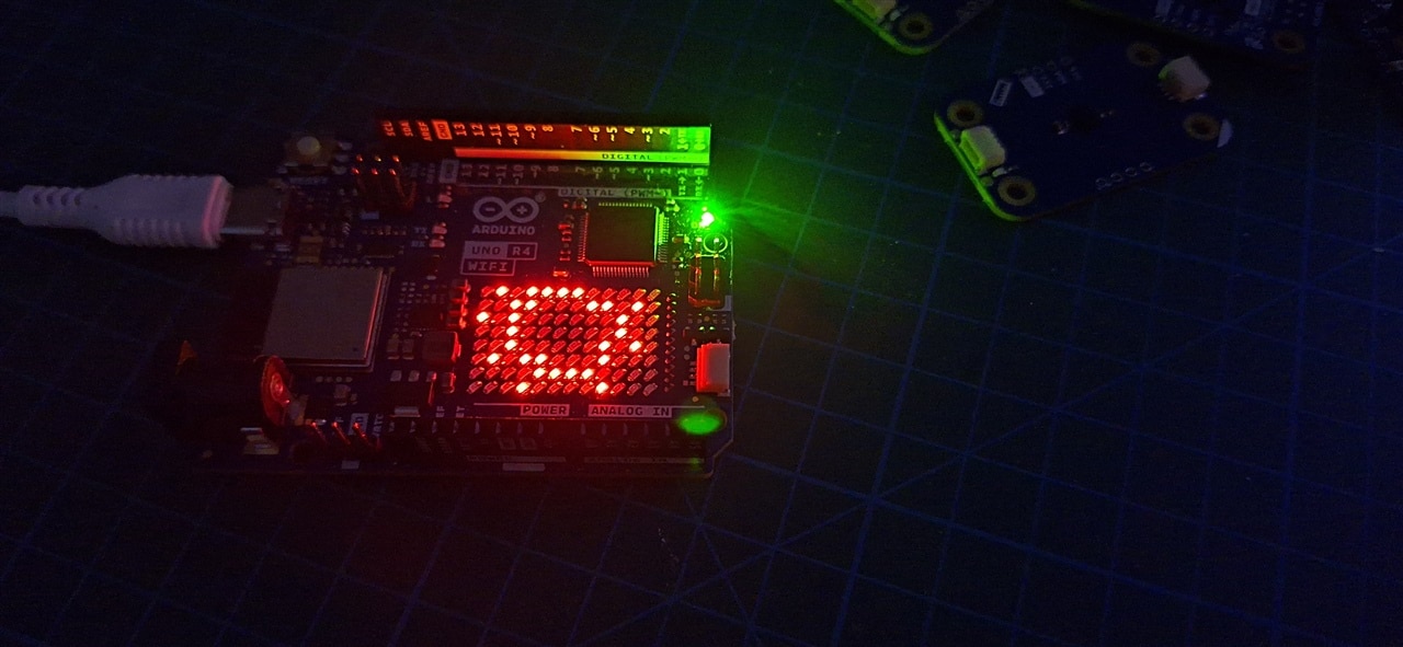

Tetris Animation Sketch
The UNO R4 WiFi comes preloaded with a Tetris animation
vid1 R4 Tetris animation

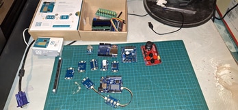

As seen in the previous tests, I wanted to revisit some old Arduino projects with my daughter, who is also participating in the roadtest.
I decided to check the compatibility of the R4 with my old "Shields" extensions. This wasn’t as straightforward.
The old programs required modifications, and I couldn’t manage on my own everywhere, but thanks to help from online forums,
I can confirm the compatibility of the Arduino UNO R4 WiFi with old systems and projects. Below is the "MultiFunctionShield" example.

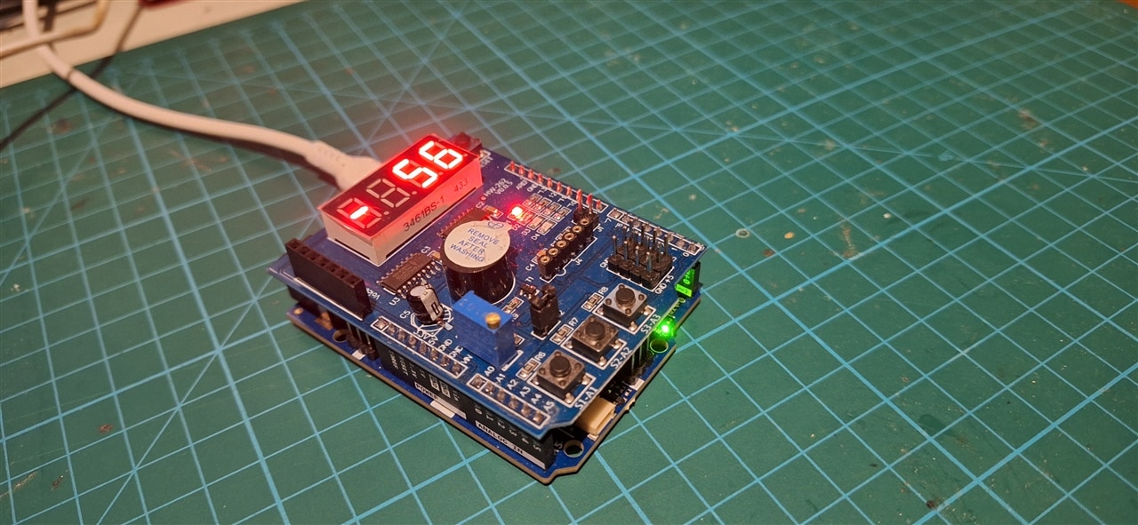

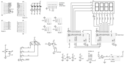

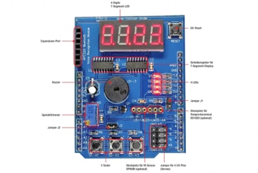

Multi Function Shield
image  image
I used the solution described on the website:
https://www.elektroda.pl/rtvforum/topic3997354.html
Used library:  MultiFunctionShield
Without library modification I had an error : Library only for Arduino Uno, Nano and so on with ATmega328
WARNING: library MultiFunctionShield claims to run on avr architecture(s) and may be incompatible with your current board which runs on renesas_uno architecture(s).
- only for ATmega328
Modifying the "architecture" in the library allowed the project to work with a different MCU.

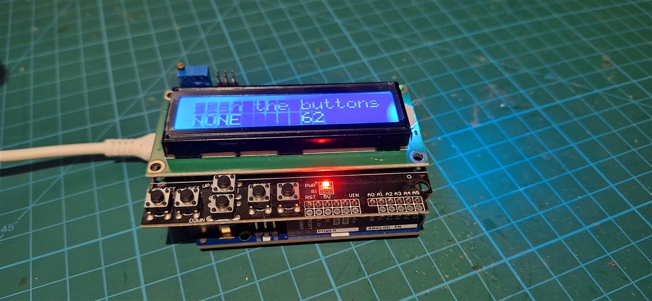

And yet another famous and popular extension module for the old Arduino turned out to be compatible with our new UNO R4.
Arduino R4 WiFi i D1Robot LCD Keypad Shield
I ran it thanks to:  https://www.elektroda.pl/rtvforum/topic4006031.html
libraries used LiquidCrystal and AnalogMultiButton
That works fine!

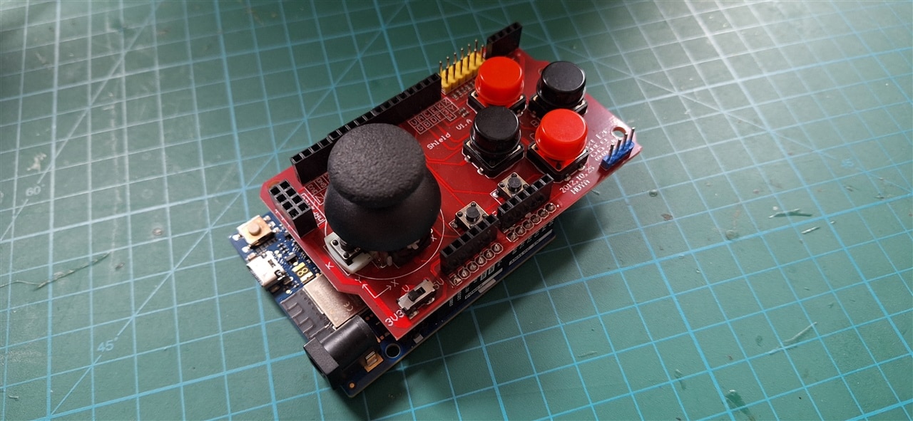

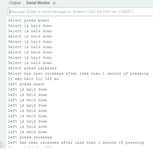

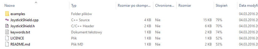

My memories of past attempts to create a gaming system on Arduino were revived: the Joystick shield.
Joystick shield
I used  JoystickShield Library with examples
https://github.com/sudar/JoystickShield

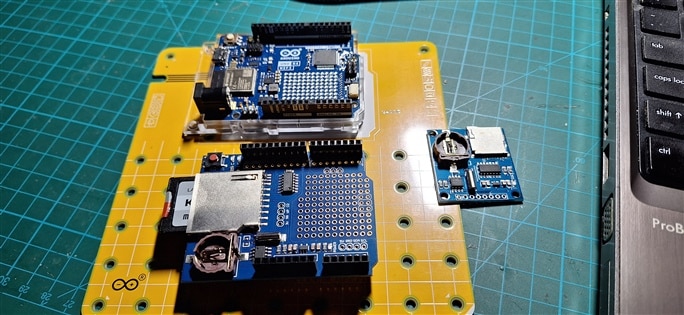

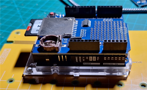

Data Logger Shield
image  image
I dug up one more old board that was once used for data logging when Arduino didn’t have many communication capabilities.
It has an SD card port and an RTC with battery backup. I didn’t expect the integration to be so simple.
The “Adafruit Data Logger shield” has stood the test of time and proved to be trouble-free to use with the Arduino R4 WiFi.
Additionally, I was pleasantly surprised by the DHT11 sensor library, which, although not updated for years, is written in such a way
that it still works with the R4 (as well as with other platforms). A simple temperature logger to the SD card was successfully set up without any issues.
And by the way, the UNO R4 WiFi has its own RTC (Real-Time Clock). To use it, it’s necessary to connect the battery according to the schematic.

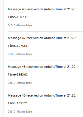

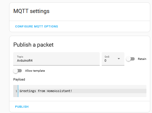

Arduino R4 WiFi to Home Assistant via MQTT
I am an enthusiast of the smart home system 'Home Assistant,' so I wanted to check if Arduino R4 WiFi could integrate with my setup.
It turned out to be very simple. I didn't create a large project. I decided to set up communication via MQTT, and the results were very satisfying.
using
[ArduinoMqttClient]
connected via WiFi
and talking via MQTT using the broker
on HomeAssistant MQTT terminal:
sending message to Arduino UNO R4
results on the serial terminal (Arduino) :
clever boy - no mistakes in communication!

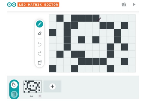

 Using LED matrix
Convenient tool - LED matrix editor
binary result of the above
Displayes on the LCD MATRIX

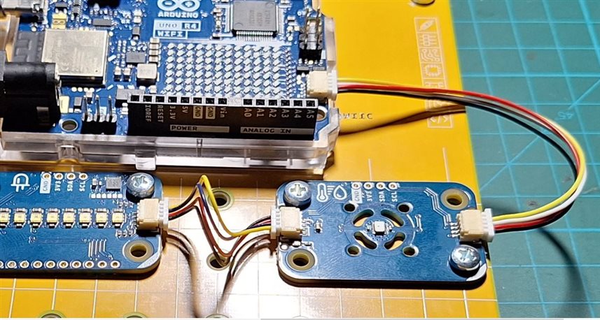

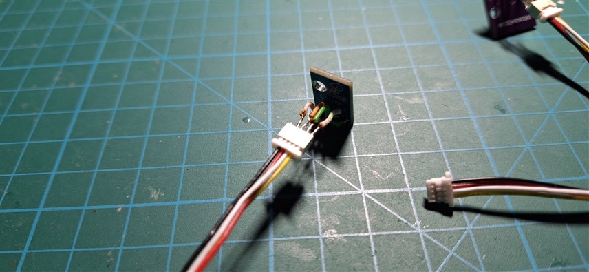

Trying with own environment modules
In addition to using the temperature and humidity module from the kit, I wanted to check the communication with other popular sensors.
Additionally, we learned how to use the Qwiic connector. This wasn’t so easy at the beginning. The instructions refer to projects in the Arduino Cloud,
but I couldn’t immediately find the description for programming the second I2C bus. But more on that in a moment.

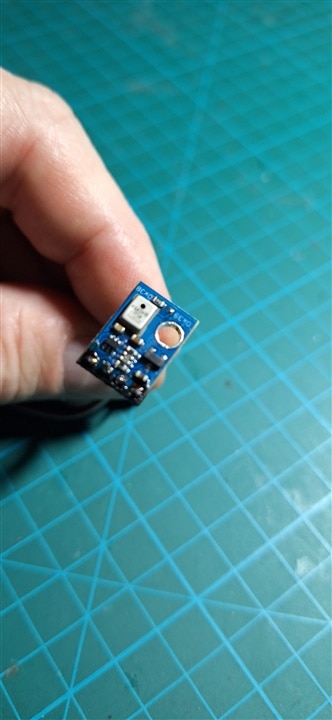

AHT20 and BMP280 sensors
imageAHT20
imageBMP280& AHT20 combi module
image my QWIIC sockets
According to:
https://gist.github.com/maxpromer/a8448e843a924ad8fcb0ed2a0f69a302
library: Adafruit_BMP280
https://github.com/adafruit/Adafruit_BMP280_Library
Arduino library for AHT20 Humidity product
https://github.com/dvarrel/AHT20
library: AHT20

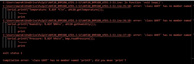

Compilation faults
Seems to be Incompatible with the Arduino UNO R4
Example from library Adafruit_BMP280
no sensor?
Example from library AHT20
no sensor?
attempts failed

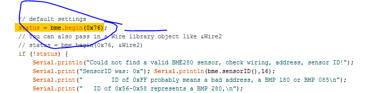

I knew I had to properly program the second I2C bus used when using Qwiic. However, I couldn't find a simple guide or example.
First tried some libraries and modifications
Finally, I decided to check if the sensors were even detectable. For this, I used the 'I2C-Scanner for Two Buses' project.
 I even ran a program to display the I2C sensor addresses on the LED matrix.
Ultimately, I managed to find a solution. Someone had already dealt with it on the forum: https://forums.adafruit.com/viewtopic.php?t=205037.
It's important to remember to declare the second bus using Wire1.begin();.
Additionally, in the case of the BMP280 sensor, I had to correct the line of code: Adafruit_BMP280 bmp (&Wire1);.
And for the AHT20 sensor, in addition to Wire1.begin(), you need to use aht.begin(&Wire1).
And that was all it took.

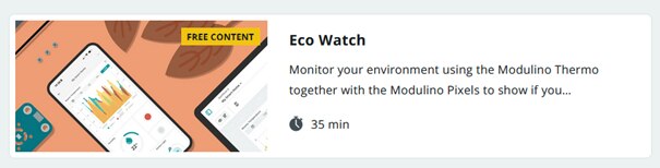

 Library Modulino

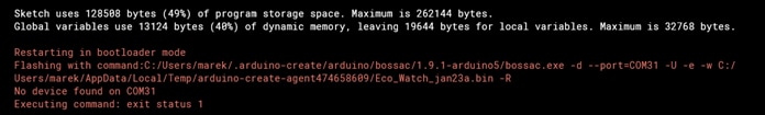

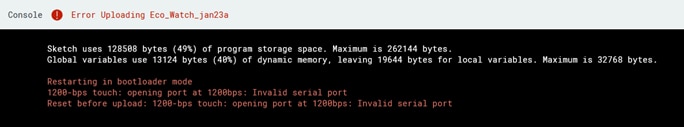

On the other hand, I couldn't get the Modulino modules to work in projects built in the Arduino IDE.
I couldn't manage to use the Modulino libraries correctly, or perhaps something else was missing.
 again and again:
 Compilation error: thingProperties.h: No such file or directory

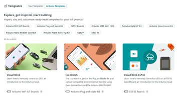

And at that moment, I decided to switch from testing in the Arduino environment to ARDUINO CLOUD.
Programming Arduino R4 using web browser and cloud
ARDUINO CLOUD TEMPLATES
https://create.arduino.cc/editor
 https://courses.arduino.cc/plugandmake/lessons/project-eco-watch/
Eco Watch template
But sometimes also some errors occurred HARDWARE issue/ firmware????
The solution:
