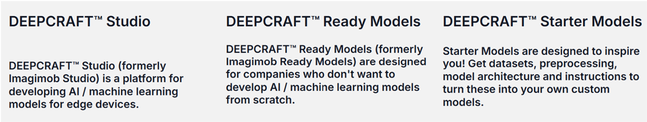

Imagimob DEEPCRAFT Products
DEEPCRAFT AI
DEEPCRAFT Studio
DEEPCRAFT Studio is a user-friendly, end-to-end platform for developing and deploying AI/ML models on edge devices. Its guided workflows and intuitive tools simplify data preparation, model training, optimization, and deployment for users of all technical levels. This platform excels at creating robust, high-quality, efficient, accurate, and lightweight models optimized for deployment in commercial products, enabling seamless operation on resource-constrained edge devices. This facilitates the integration of AI capabilities into diverse products, including smartphones, wearables, autonomous vehicles, and industrial equipment. A key advantage is its focus on security and privacy, incorporating robust measures like data encryption and access control.
Helpful Link
Development Platform for AI / Machine Learning on edge devices - DEEPCRAFTTm Studio
DEEPCRAFT Ready Models
Ready Models are pre-trained AI/ML models ready for deployment on edge devices. These models are designed to reduce development time and cost by eliminating the need for custom model creation, extensive data collection, and lengthy training.
Ready Models cover applications such as:
  1. Audio: Detecting specific sounds like alarms, sirens, or machinery faults, useful for real-time monitoring in industrial or security contexts.
  2. Radar: Detecting object presence and movement for applications like inventory tracking, AGVs, and surveillance.
  3. IMU: Analyzing human motion (e.g., falls) or machinery vibrations, relevant for healthcare, safety systems, and industrial monitoring.
These models are designed for straightforward integration across various hardware and operating systems. Their compact and optimized nature minimizes resource usage and power consumption on edge devices. Using Ready Models allows developers to quickly implement AI/ML functionalities without requiring deep in-house AI expertise, accelerating prototyping and product development. They provide a fast path to incorporating machine learning into PSoC 6 AI Evaluation Kit projects for experimentation and proof-of-concept work.
Helpful Link
DEEPCRAFT Starter Models
Starter Models are open-source resources designed to accelerate your Edge AI development. They provide datasets, preprocessing steps, model architectures, and implementation guides, allowing you to create production-ready solutions. Covering diverse use cases and sensor types, these models are ready for your specific refinements and training. Their aim is to inspire innovation and facilitate a quick start to your Edge AI projects. If you have DEEPCRAFT Studio, you already have these Starter Models. Studio offers 3000 free computation minutes monthly for development, evaluation, and testing, so you can begin immediately.
Helpful Link
Starter Models make it easy to get your project going!

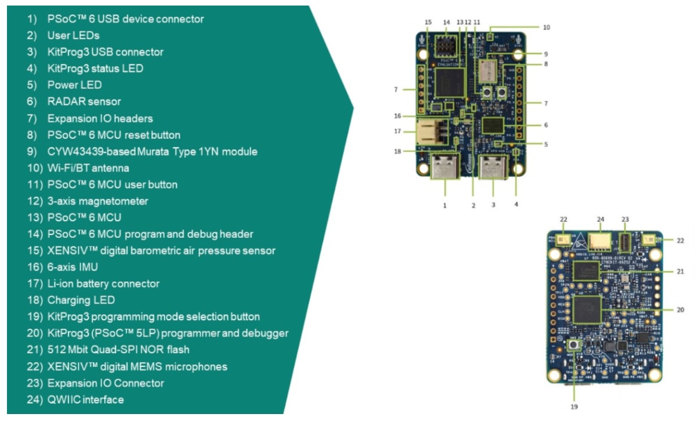

Brief diagram lists all the components on the board.
The following diagram lists all the components on the board. Please refer to the user manual for a detailed description of each component and its importance.

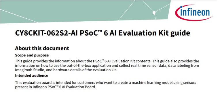

Follow the "CY8CKIT-062S2-AI Getting Started Guide".
Link: Getting Started Guide
User guide Please read the sections “Important notice” and “Warnings” at the end of this document
002-40023 Rev. *A www.infineon.com 2025-03-03
This document is a getting started guide for the PSoCTm 6 AI Evaluation Kit, a development kit for machine learning applications. The kit includes a PSoCTm 6 MCU, AIROCTm CYW43439 Wi-Fi/Bluetooth® combo module, 512 Mb NOR flash, onboard programmer/debugger (KitProg3), and various sensors.
  • Key software requirements for using the kit are ModusToolboxTm software and DEEPCRAFT Studio.
  • The kit comes pre-programmed with an example that demonstrates sensor data collection and streaming.
  • Users can test this out-of-box application using a serial terminal or DEEPCRAFT Studio.
  • Instructions are provided for connecting the board to a PC, configuring the serial port, and interpreting the data output.
  • The guide also details how to use DEEPCRAFT Studio to create a new project, capture real-time data from the board's sensors, and label the data for machine learning model creation.
Overall, this guide provides a step-by-step walkthrough for setting up and using the PSoCTm 6 AI Evaluation Kit, enabling users to quickly begin developing machine learning applications.
My experience running through the document.
  • I followed section 2.1 “Flashing the streaming firmware”  in the getting started guide. I was able to install it successfully.
  • I then Downloaded and installed DEEPCRAFT Studio.
  • I was able to follow section 2.4 “How to collect and label real-time data from the sensors?”  to  Use Deepcraft studio.
  • At the end of the document on page 13, at the end of 2.4.4.3 links are given to lean more. “After collecting the data, add data to the required project and start with the machine learning workflow in DEEPCRAFTTm Studio. See Create project and Add data to project to know more.”
  • On page 14, how to collect data from the PSoC 6 AI Evaluation Kit's various onboard sensors using DEEPCRAFT Studio is described. It mentions that within the software, each sensor (Microphone, IMU, Magnetometer, Barometric Pressure, and Radar) has a corresponding "node" that needs to be connected to a "data track" to start gathering information. It also points to further online resources with specific instructions on how to set up and collect data for each individual sensor node within DEEPCRAFT Studio.
  • The PSoC 6 AI Evaluation Kit includes several supported code examples, as outlined in Section 3 ("Supported code examples") on page 15.
    • One example, mtb-example-ml-deepcraft-deploy-ready-model, showcases the integration of a pre-built model library from DEEPCRAFTTm Studio within ModusToolboxTm. This example features six distinct models for baby-cry, cough, alarm, siren, and snoring detection, as well as hand gesture recognition. Refer to the README file for comprehensive information.
    • Another example, mtb-example-ml-deepcraft-deploy-motion, demonstrates the deployment of a Machine Learning model developed in DEEPCRAFTTm Studio on a PSoCTm 6 microcontroller. This specific implementation utilizes IMU sensor data for gesture detection. Further details can be found in its respective README.
    • The mtb-example-ml-deepcraft-deploy-audio example illustrates the deployment of a Machine Learning model from DEEPCRAFTTm Studio onto a PSoCTm 6 microcontroller. In this case, the model is an acoustic model designed for keyword spotting. Additional information is available in the README file.
This concludes my experience running through this document. My evaluation using the following 6 points: Document ,Structure and Clarity ,Content Completeness,Technical Accuracy ,Ease of Use ,Target Audience ,Overall Effectiveness  is described below.
  1. Document Structure and Clarity
  • The guide adopts a functional structure aligned with technical documentation standards, beginning with an introduction to the kit and progressing through setup instructions. Major sections include Kit Contents, Software Requirements, and Out-of-Box Application Testing, each subdivided into logical subsections. Headings follow a hierarchical format (e.g., ## for sections, ### for subsections), though some subsections lack sufficient granularity for complex topics like sensor integration.
  • Prose is concise but occasionally overly technical, assuming familiarity with terms like ModusToolbox and DEEPCRAFT Studio. While grammatical errors are minimal, the passive voice dominates, reducing readability for non-expert audiences. Visual aids—such as terminal command screenshots and QR code placement diagrams—are well-integrated but lack annotations explaining their relevance to adjacent text.
  1. Content Completeness
        The guide covers essential topics required for initial setup but omits critical context for advanced use cases:
  • Kit Contents: Lists components (e.g., PSoC 6 AI Evaluation Board, inlay card) but neglects to explain the functional significance of hardware features like the BGT60TR13C radar sensor.
  • Software Requirements: Specifies versions (ModusToolbox v3.4+, DEEPCRAFT v5.3) but does not clarify compatibility with alternative IDEs or operating systems beyond Windows/Linux.
  • Troubleshooting: Limited to basic UART configuration issues, ignoring common pitfalls like driver conflicts or sensor calibration failures.
        Notably absent are:
  • Guidance for transitioning from the out-of-box demo to custom ML model deployment
  • Safety warnings related to high-frequency radar sensor operation
  • References to supplementary resources (e.g., community forums, API documentation)
  1. Technical Accuracy
        Technical instructions demonstrate rigorous validation, particularly in:
  • Terminal command sequences for sensor data streaming
  • Pinout diagrams matching engineering sample boards
  • Firmware version alignment with DEEPCRAFT Studio dependencies
        However, the guide contains minor inconsistencies:
  • UART pin labels (TX/RX) differ between text descriptions and schematic diagrams in early revisions
  • Ambiguous references to “latest software” without explicit version checks
  • Assumptions about default baud rates (115200) that may not hold for all host configurations
  • Code snippets and CLI examples are functionally correct but lack inline comments explaining parameters or error-handling strategies.
  1. Ease of Use
        The guide prioritizes task-oriented navigation, enabling developers to complete setup in ~30 minutes. Strengths include:
  • Numbered steps for installing ModusToolbox and configuring terminal emulators
  • Clear visual indicators for hardware jumpers and USB ports
  • Expected output samples for validating sensor data streams
        Areas for improvement:
  • Visual Aids: Diagrams lack scale references; terminal screenshots use inconsistent font sizes
  • Procedural Gaps: No guidance for recovering from failed firmware updates or debugging CRC errors
  • Cross-Platform Support: Windows-centric instructions (e.g., Tera Term) with minimal Linux/MacOS equivalents
  1. Target Audience
         The document assumes:
  • Proficiency with embedded toolchains (e.g., flashing firmware via MiniProg4)
  • Familiarity with machine learning pipelines (data acquisition → model training → deployment)
  • Basic understanding of UART/I2C protocols and sensor fusion concepts
        While appropriate for experienced engineers, it creates barriers for:
  • Hobbyists or students new to PSoC architectures
  • Data scientists exploring edge AI without embedded systems background
  • Teams evaluating the kit for procurement decisions
        To broaden accessibility, the guide could:
  • Add a glossary of terms (e.g., “DEEPCRAFT,” “PSoC 6”)
  • Include cross-references to foundational tutorials (e.g., Arm Cortex-M programming)
  • Offer simplified workflows for non-ML applications
  1. Overall Effectiveness
        As a getting started resource, the guide succeeds in:
  • Enabling rapid hardware/software validation
  • Demonstrating sensor data collection workflows
  • Establishing baseline expectations for kit capabilities
        However, it falls short as a comprehensive development companion due to:
  • Insufficient exploration of ML model optimization techniques
  • No performance benchmarks (e.g., inference latency, power consumption)
  • Omission of design patterns for multi-sensor synchronization
        Recommendations for Improvement
  1. Expand Troubleshooting: Add flowcharts for diagnosing connectivity issues and corrupted firmware.
  2. Enhance Visuals: Annotate diagrams with callouts for critical components and interface labels.
  3. Address Diverse Skill Levels: Create tiered sections (Beginner/Advanced) with optional deep dives into PSoC 6 architecture.
  4. Integrate Community Resources: Link to GitHub repositories, example projects, and Infineon’s support portal.
  5. Provide Performance Metrics: Include tables comparing sensor accuracy, sampling rates, and power profiles across operating modes.
        By implementing these changes, the guide would better serve its dual role as both an onboarding tool and a long-term reference for AI-driven embedded development.
