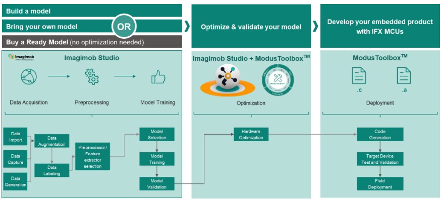

The Infineon PSoCM6 AI Kit offers a range of capabilities for users interested in artificial intelligence (AI) and embedded system development. It provides a platform to build, optimize, and validate models, as well as develop embedded products using Infineon Microcontrollers (MCUs).
Model Development and Product Creation
Users can either build their own models or purchase ready - made models. The kit allows for model optimization and validation, which is crucial for ensuring the accuracy and performance of AI models. After the model is ready, it can be integrated into embedded products developed with Infineon MCUs.
Development Tools
Tools like Modus Toolbox and DeepCraft studio are available for the development process. These tools support various aspects of the development cycle, from data acquisition to model deployment.

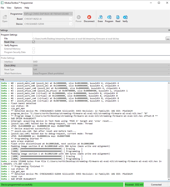

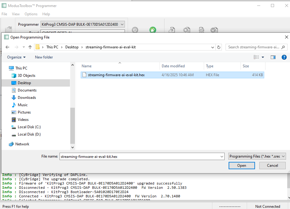

Install and connect the  PSoC 62S2 AI kits, but the board can not be detected, since the firmware shall be updated first
Install Modus toolbox programmer, the kitProg3 driver can be update, it does not matter if continues.
Update the firmware for KitProg3 first
the download the data stream firmware
connect the board and program it
until it is successful.

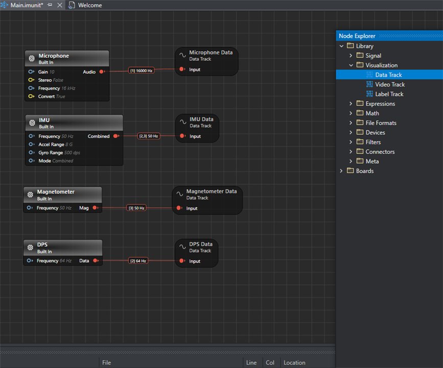

3.2 Data streaming with Deepcraft Studio

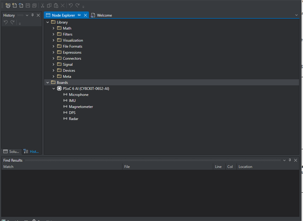

Now the board is shown, and available sensor, since the data is exchange according to protocol 2 instead of protocol 1
local camera is camera on PC, it is available for data streaming as well,

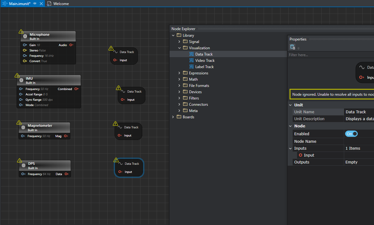

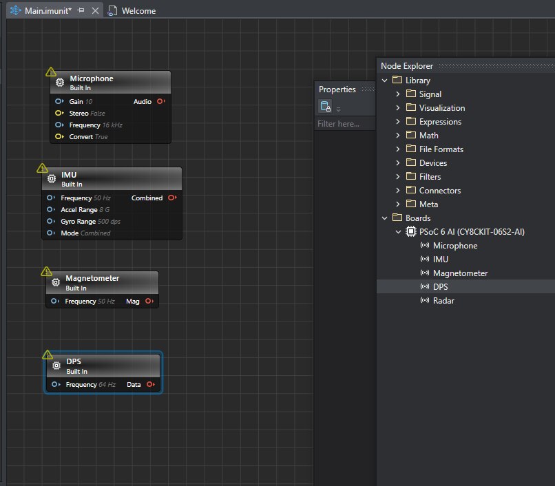

Create on UX project

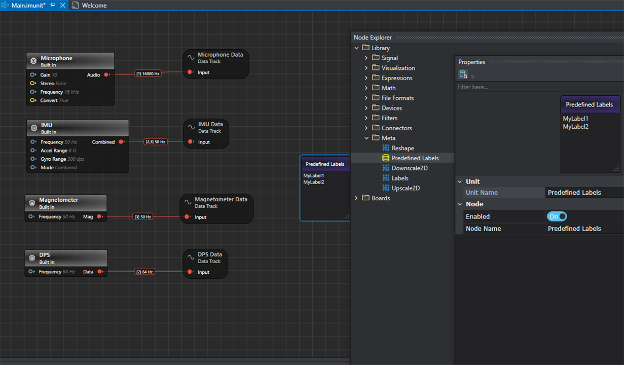

drag the sensor to left panels
add data tracks
and connected them
add preset label , this is used in training and labeling.
change the label as you like, this is for label the data blocks,

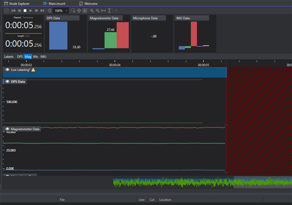

once completed, start on live session , the sensors in different track show how data streaming
start recording, the data is coming
select part of the data block and fit label as prefefined before
the save the live session, and tick select tracks
repeat the process for data streaming and saving the sessions.

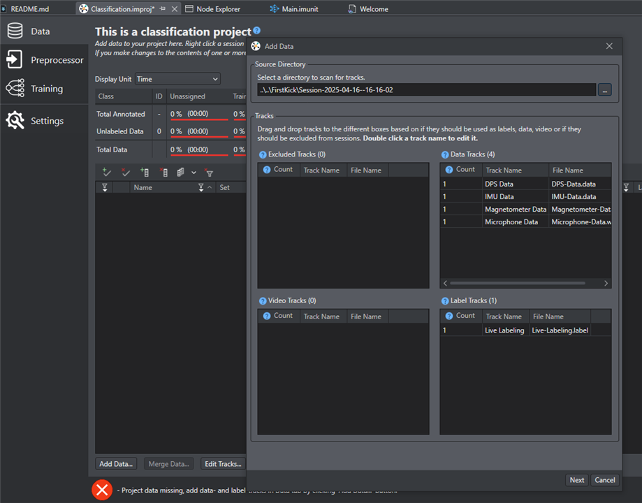

3.3 Create one training project
upload the data from the saved session files, scan the file for data
Now , the data is ready for training and modification

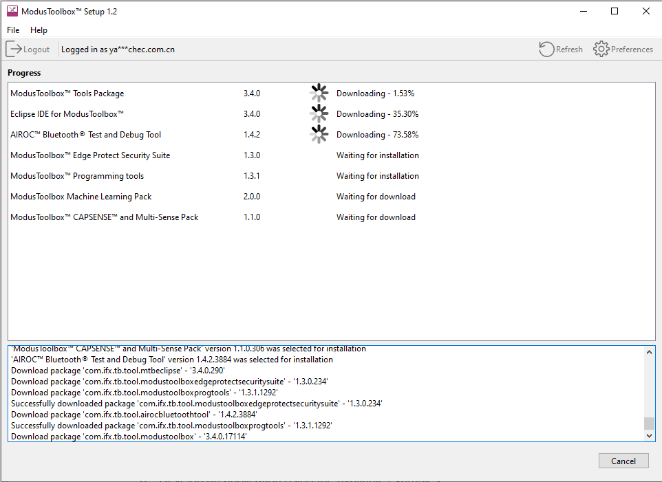

4.1 Install the Modus Toolbox and install package with dashboard
install packages

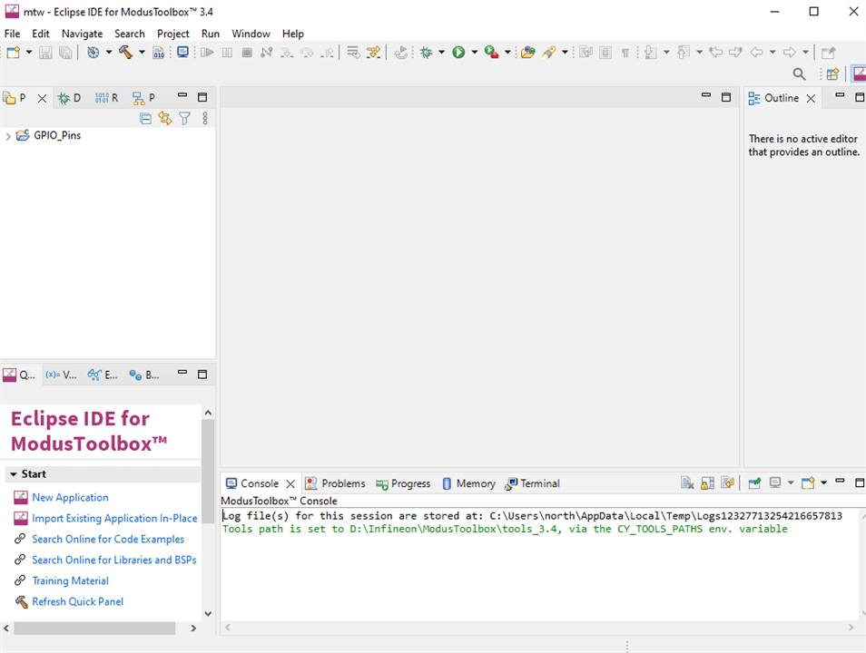

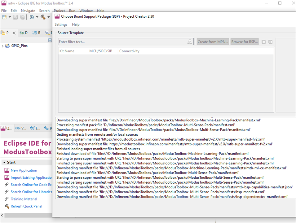

Start the Modus toolbox
choose BSP

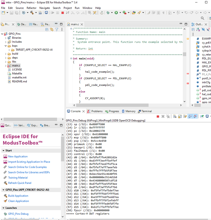

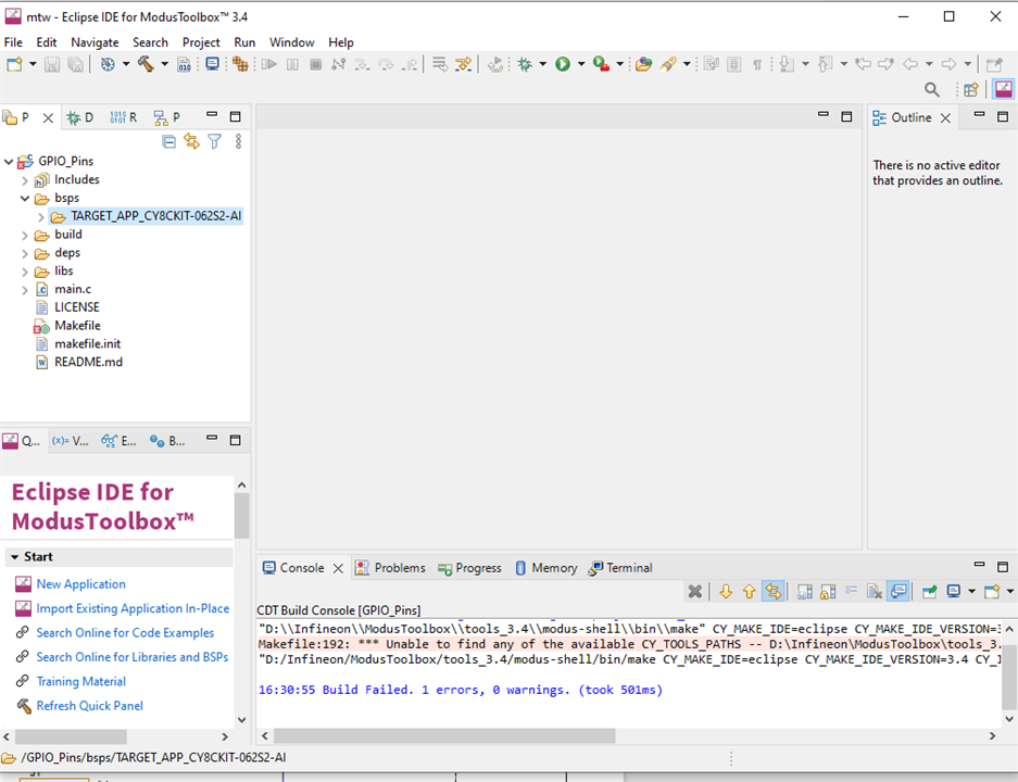

import the simle GPIO toggle program to test the program, modify variables as windows 10 fits well
with parameter modified, the program can be built well

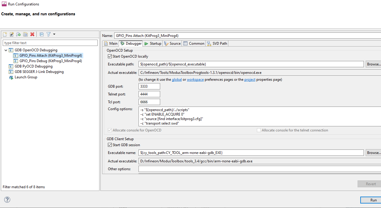

start run configuration and select kitProg3
it can be flashed and runs

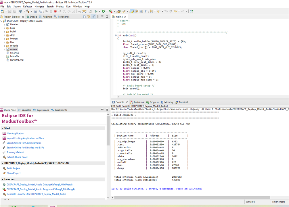

4.3 Import Deepcraft Studio model deployment program and build it

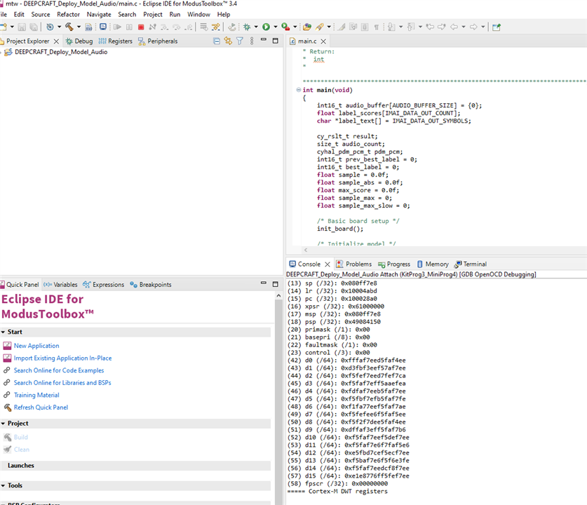

debug configuration
build and flash the program, it runs well
Open the Serial port for output
