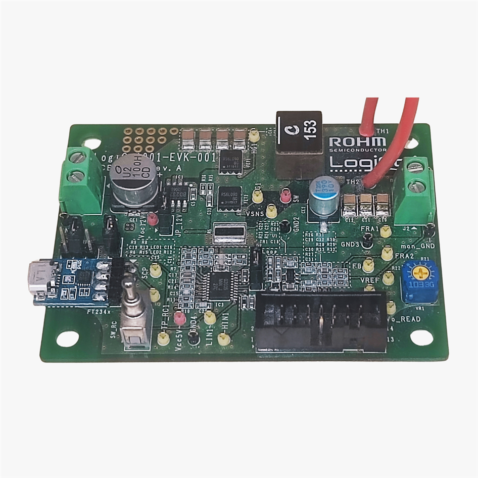

The ROHM LogiCoATm BUCK Converter (part of the LogiCoA001-EVK-001 Evaluation Kit) is a next-generation compact power management solution, designed for efficiency, flexibility, and integration with various microcontroller-based and industrial applications. In this review, I’ll walk through its specifications, features, and my hands-on experience using basic electronics tools.
2. Product Overview
This EVK (Evaluation Kit) combines the LogiCoATm series BUCK DC/DC converter and provides test points, jumper configurations, and pre-wired components for rapid validation. It helps engineers quickly evaluate the behavior of the BUCK converter without requiring deep circuit design experience. Figure 1 shows the overview of LogiCoA f LogiCoATM Power Solution. LogiCoATM Power is a solution adopting analog-digital hybrid control to a switching power supply and consists from 3 elements, (1) Microcontroller for Power Supply Control (LogiCoATM Microcontroller) ML62Q203x/ML62Q204x (hereinafter referred to ML62Q20xx group), (2) Operating System for Power Supply Control Microcontroller, RMOS, and (3) Power Supply Application. Refer to the explanation application note [1] for detail information of analog-digital hybrid control.

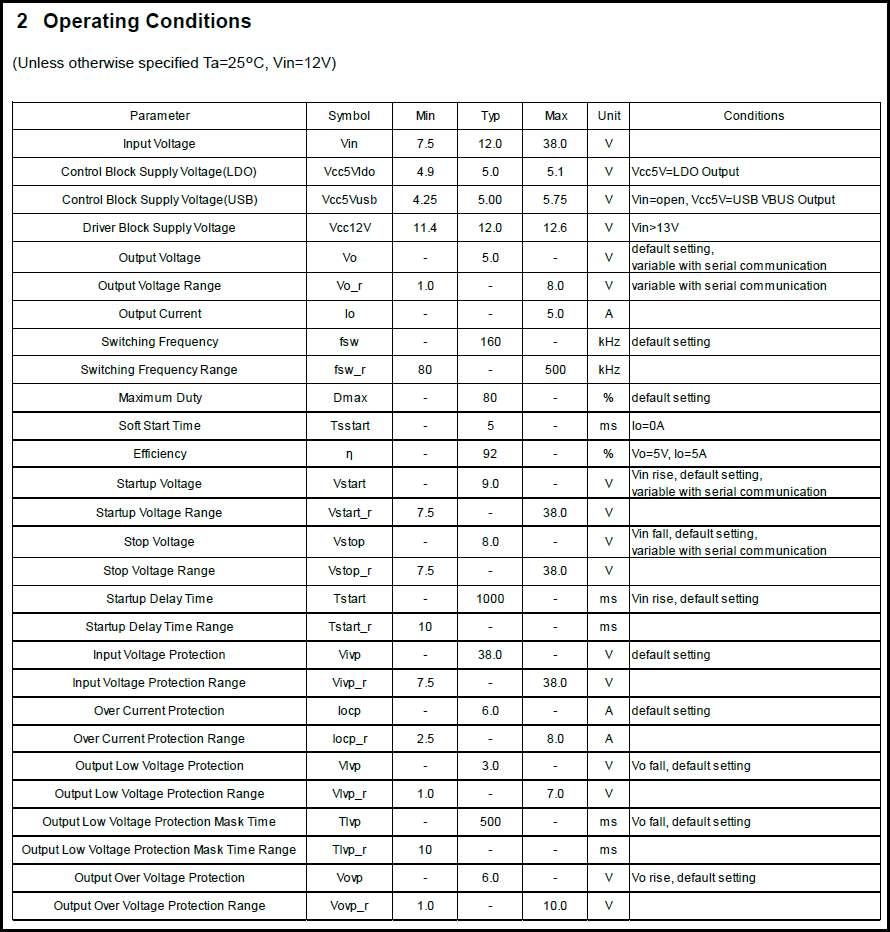

The operating condition is as shown below.

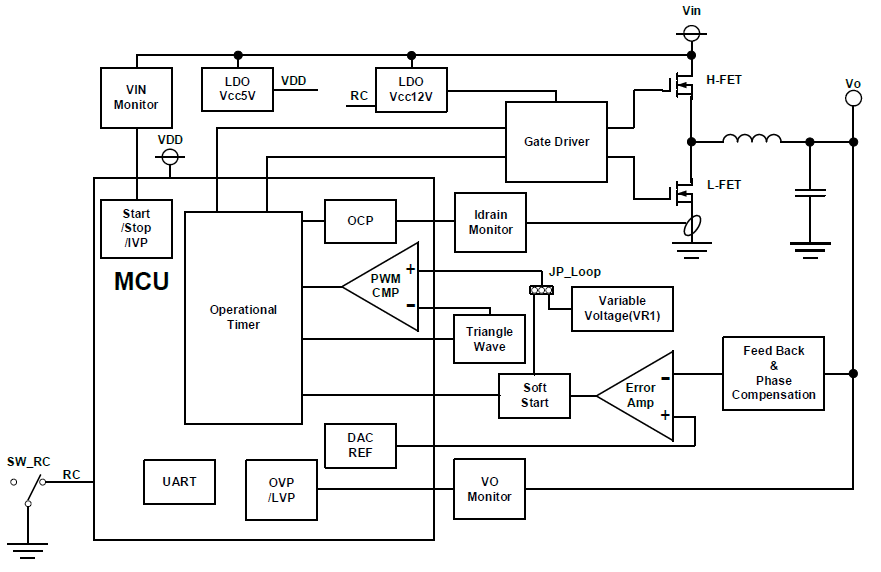

And below is the block diagram of the EVK

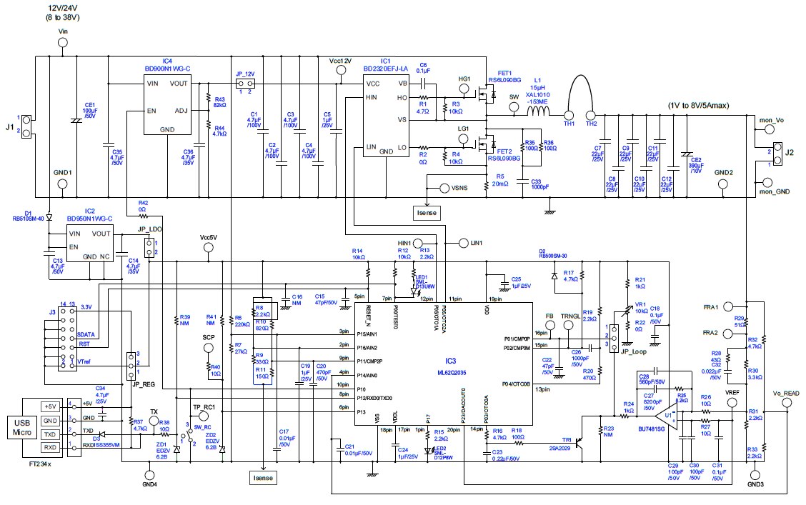

The Schematic

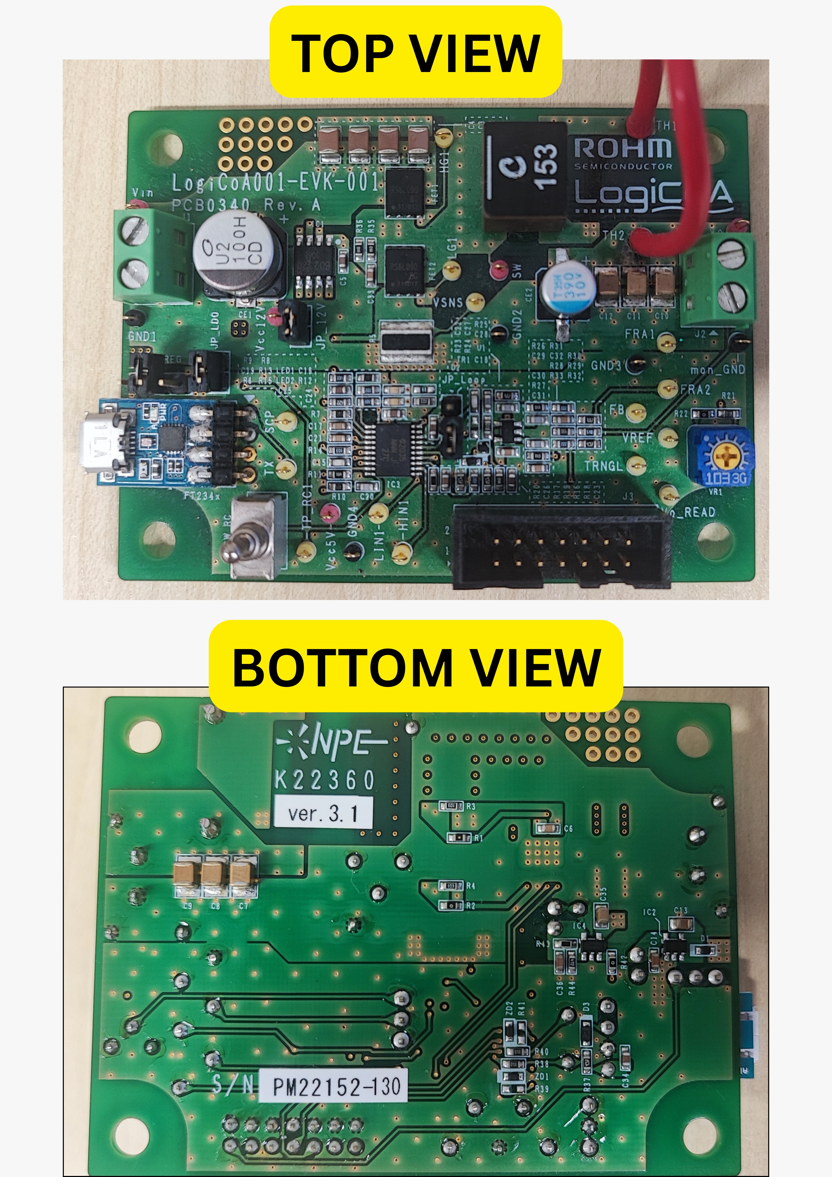

The Front and Bottom View

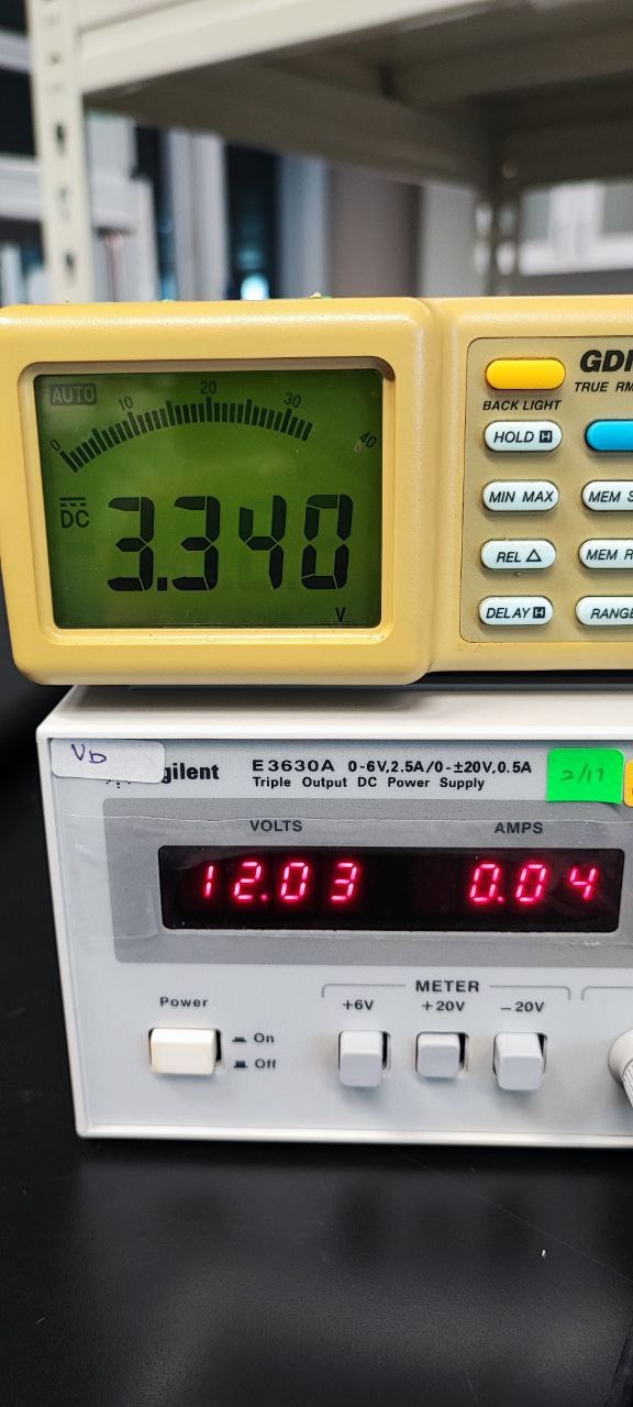

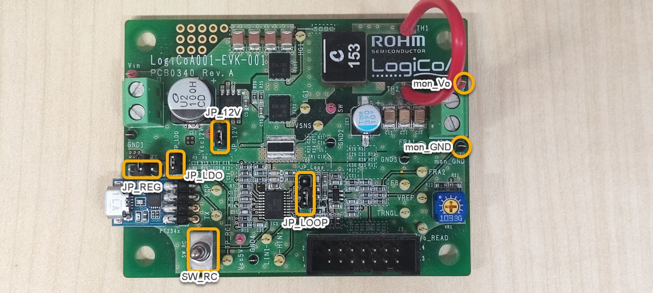

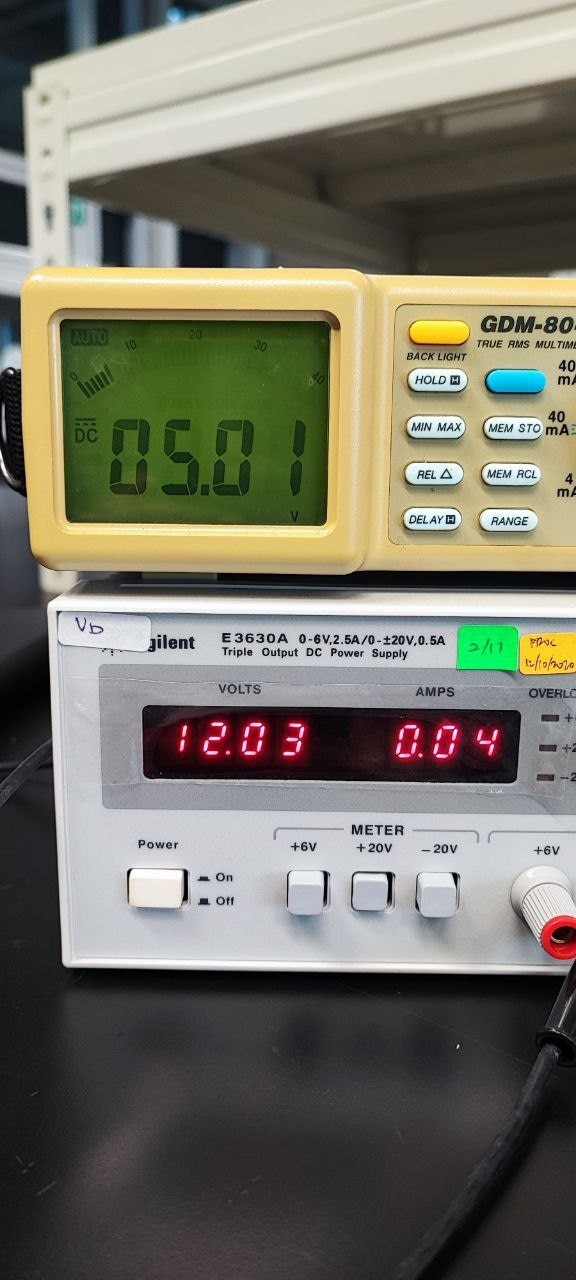

For the test setup, I have use the 12V as the input voltage and the measured voltage at output shows 5V (as per the quick start guide) . The configuration of the pins is as shown below:
1) The jumper JP_LDO is shorted.
2) Jumper JP_12V is shorted.
3) Jumper JP_LOOP is shorted between Pin 2 and Pin 3.
4) And jumper JP_REG is left open.
5) Turn the SW_RC to connect Pin 1 and Pin 2.

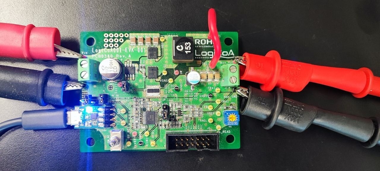

6) Next connect the input power and ground at Vin and GND respectively. Make sure the power supply is turned off when connecting.
7) Lastly connect the multimeter to mon_Vo and mon_GND.
8) Turn on the power supply and observe the voltage output at multimeter.
The image below illustrate the test setup and the measured voltage.

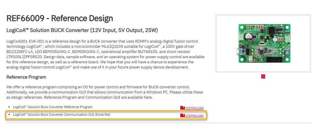

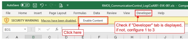

Of course registration is required prior to able to download the file. Once the file is downloaded, unzip and open the excel file. Since the excel files comes with Macro, it may me blocked if you are running it for the first time. In order to enable the macro, right click on the file and go to properties and tick the unblock. Once done, next we need to check whether the Excel is set up to use VBA macros. If ""Development" tab is displayed in Excel as shown below, VBA macro can be executed. In case the "Developer" tab is not displayed, it should be enabled first.
Follow the instruction below to enable the "Developer" tab
1. Click, "File" tab > "Options" > "Customize Ribbon".
2. Check "Developer" box in "Customize the Ribbon" list.
3. Click, "OK".
4. check the window that "Developer" tab is displayed

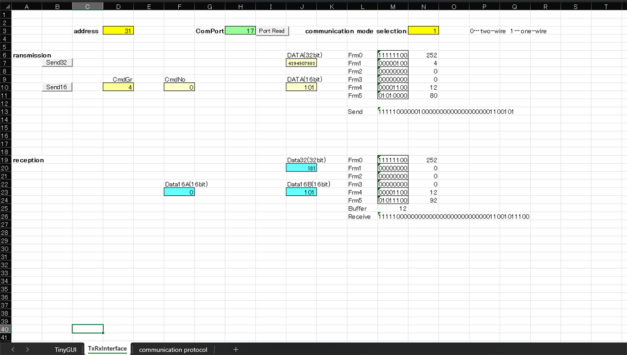

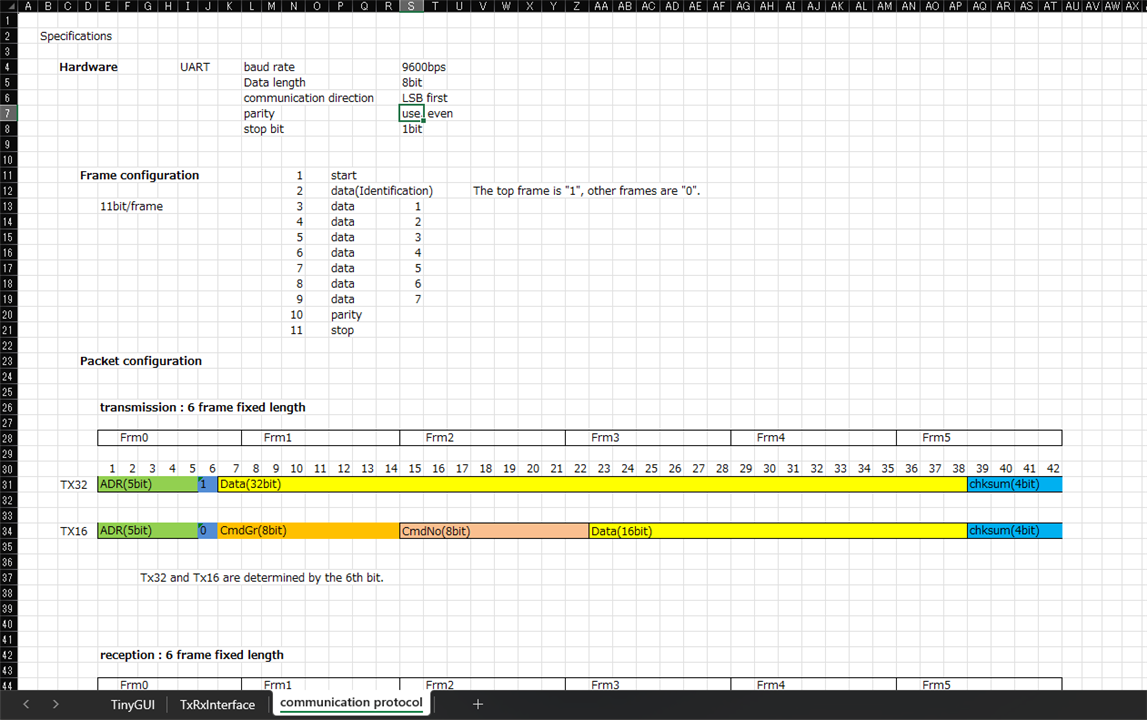

One's the excel is ready, we are now ready for test the board using the GUI. But before that it is better to understand the excel file. The excel file comes with 3 worksheet.
{gallery}Excel
IMAGE TITLE: Worksheet 1 TinyGUI
IMAGE TITLE: Worksheet 2 TxRxInterface
IMAGE TITLE: Worksheet 3 Communication Protocol

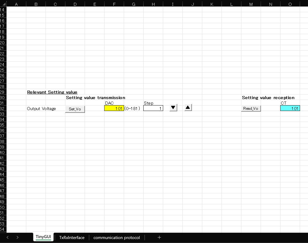

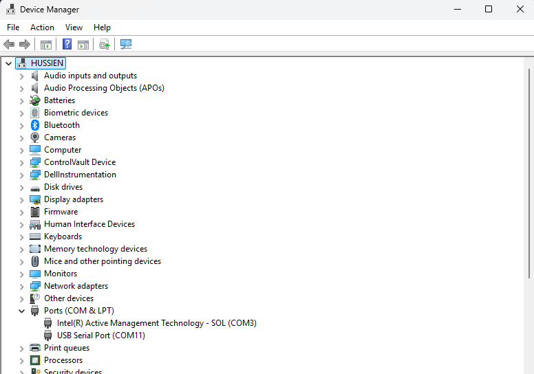

Of all the three worksheet, we will use the first worksheet which is the TinyGUI to control the output voltage. But before that we need ensure that the ROHM board is connected to the PC. Plug in the USB cable from the PC to the ROHM board. Next click "PORT READ" to get the correct port number. To ensure that the correct port is connected, we can double check in the device manager. As shown in the figure below
The port number shown in the device manager should match with the one shown in Worksheet 2 TxRxInterface. Once this is confirmed Go back to Worksheet 1 TinyGUI to set the output voltage. By referring to the manual, we know that the Vo of the buck converter is determined by the code of D/A converter and the following equation is established.
By referring to the equation above the output voltage Vo of the buck converter EVK can be changed using the setting code calculated from the above equation. For instance if we want to output 3.3V the D/A code should be 67. The image below shows the output voltage when the D/A code is  67 for and 101. The D/A code need to be inserted in the F32 cell and click the Set_Vo button.

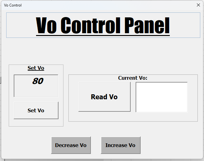

6. Custom GUI
By referring to the GUI above, i have created a custom GUI. Below is the screenshot of the GUI which i have created.
Basically what does the GUI does is that, it takes the value in the form D/A code and convert it to the desired voltage. The code for this GUI as shown below
