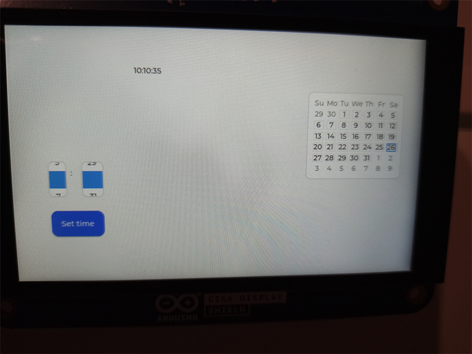

Another one is LVGL Architect - an online tool, according to the forum posts, still under development. It allows for drag-and-drop GUI creation, but results are somewhat mixed. Below is a project of clock setting screen
LVGL Architect project
using project file as below:
clock_set.lvga.zip
that can be exported as a Arduino .ino project, but with initial results not very encouraging
initial results
it seems that a clock widget (not present in the LVGL but built as an use-case of scale widget with two indicators in one of the examples) is only placed as an placeholder label and the rollers of the desired size are too small to be displayed correctly. Additionally, most of the operation logic have to be added by hand.
Correcting size of rollers allowed for correct selection of time to be set:
bigger rollers
an integrating it with a clock from clock example code resulted in GUI like below:
Which proves that there is currently possibility to quickly create usable GUI, even without help of web designer.
